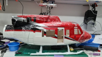

I am building a scale fuselage ( Roban 212 600 size) and I have the GTR unit with the Geolink module, now I want to build the gps unit inside the fuselage but there isn’t space in the tail.
The only space is under the “ doghouse” close at the rotor approx 15 cm distance.
Is this possible and will it work ?
On a other scale heli I use a Naza H unit, and the gps unit under the rotor works normal without problems ( inside fuselage) .
I hope it would work.

Thank for youre quick response ZeXx86,
There are indeed a few small magnets to keep the "doghouse" on his place , they are intergrated in the epoxy hood and fuselage and not to remove .
Is there a way to measure the influence of the magnets on the Geolink module ?
And is it possible to shield the Geo module with a smal metal case at the underside or plate to get no interference on the compass ?
