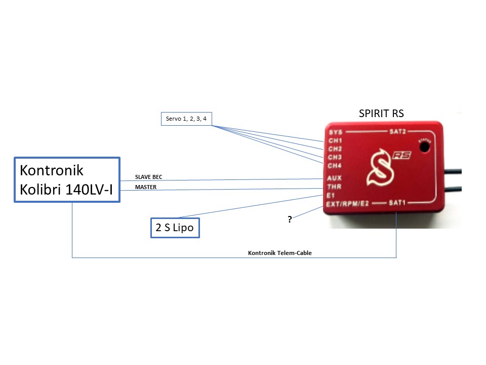

I want to connect Kontronic Kolibri 140LV-I (with Telemetrie)
to my Spirit RS.
Want to use the Master + Slave BEC from ESC and also a Lipo2S.
Is the following Wiring correct?
Wiring correct?
please verify that Kontronik can handle battery as buffer pack with no electronics. Otherwise it can cause serious damage.
Other cables are connected well.
Thank U
So i do Not need to connect anything to Ext/rpm/E2 ?
Last year with the hobbywing i needed a special cable to rpm.
1)The kontronik don't need this ?
2) is it possible to use an Y-Cable for slave bec and die 2slipo , because i would like to
Use E1 for the original kontronik Telemetrie cable with JR plug...?
1) It is same as HobbyWing. Both dont need it if you dont want to use Spirit Governor.
Only if Spirit Governor is used, then RPM cable must be connected.
2) Yes, it is possible.
