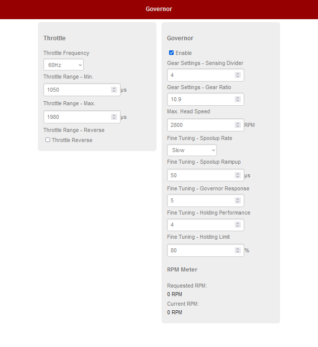

I ordered the Spirit Hall Sensor and found another one in the box. I put one magnet on the main shaft and for each RPM I receive when the magnet passes a low signal. I set the devider to 1, but the govenor is still not working. I see that i get a requested rpm and I see that the sensor is delivering a signal change, but it doesn't calculate a RPM. Current rpm is always 0.

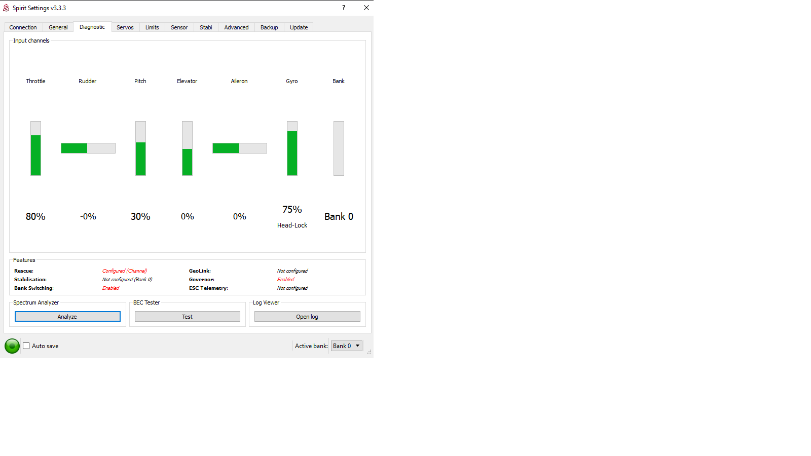

I did that. Throttle is on hold over 50%. I see that the rpm requested changes depending on throttle low or high settings of my radio.
It seems like the unit is not calculating. If I'm in the tester window and turn the rotor by hand, it should show like 30-100rpm or so, but it doesn't. The sensor is sending a signal, I see that it switches from active to inactive.
Posts: 12932
Can you see that throttle is over 50% also in the Diagnostic tab?
Yes, you should see also low RPM.
What Gear Ratio and Sensing Divider is configured? What is your model?

See the pictures, that's both during spool up. I have a Alzrc X 360. I added a 2nd magnet. I will provide a video in a bit with the reading when i spin the rotor by hand.
