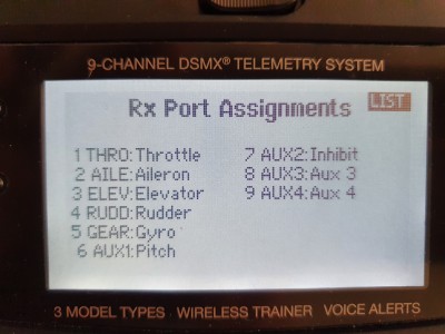

Hi Matte61,
Many thanks once again for your time and guidance. I have included some pictures of my current settings on my DX9 radio for your consideration.
The Gyro settings I understand should be 50% to start with, but ALL 50% or do I need to make one -50% for the stability/acro/rescue to operate properly?
Thank you
My settings at the moment Matte61. Are there any corrections to be made, apart from Gyro?

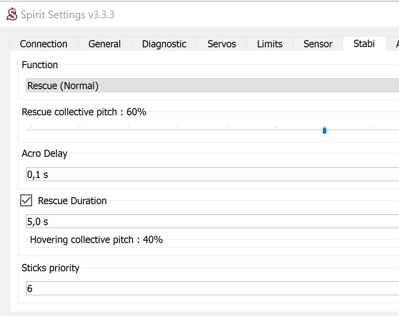

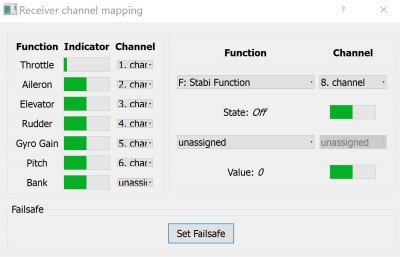

Posts: 637
Hi Rob,
you can start for all flightmodes with Gyro Gain 50% -
With your DX9 you can take an extra channel for rescue, for example Aux 3 or Aux 4 -
in the Digtal Switchsetup you can assign a dedicated switch, for example switch A in the transmitter -
You only have to set the stabifunction in the general tab under channels with the dedicated channel for example channel 8 -
If you have only one bank you must assign in the register stabi the wanted rescue mode for example
stabimode normal means rescue always with landing gear down -
