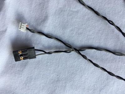

But as I mentioned earlier I believe the telemetry cables for Scorpion and HW used by VControl are wired identically to the Spirit Tele cables.
The reason I am using these cables instead is that I already have quite a few (having just changed back from VControl to Jeti / Spirit).
Please see attached and advise if you think that is correct?

the cable looks correct. I assume black wire in the servo connector goes at the GND (-) pin of the ESC, is this correct?
The only last possibility that could make it not to work is that the Spirit unit has missing soldering joint at the servo connector.
This could be verified by unmounting bottom part of the cover.
