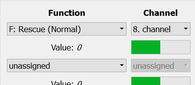

I have set the rescue (normal) on a channel i.e. Ch 8.
Everything works fine i see the Pitch (48%) if i press the rescue-button.
I hold the heli upside down and i see the pitch goes in the invers direction and after a short time the swashplate turns to a side to turn the heli in normal position
I think this is correct.
I want to find out during flight which is the best pitch level for rescue.

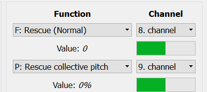

Now i program another channel for the rescue collective pitch.
I can see the different pitch levels during rescue if i change the values on Ch9. This is correct i think.
I turn the heli upside down and now there is a difference: There is no more swashplate activity to turn the heli in normal flight position.
I think this is not correct, if i want this i would change the rescue normal to rescue acro.
Please tell me if this behavior is correct.
Thanks a lot for your help
Ciao
Jörg

If you have Rescue Acro Delay configured, then it will switch after configured time to Rescue (Acro) behavior. After this time swashplate is behaving simply different. Collective Pitch is still configured at any moment, regardles of what kind of Rescue is configured.
You can verify it with Rescue (Acro), because if you are verifying it only with eye on the ground, then it can be confusing.

Maybe I did not express myself correctly.
I always configured rescue (normal) never rescue (acro).
But if I also configure P:Rescue collective pitch to Ch 9 and hold the heli upside down,
I see no movement on the swashplate after the Rescue Acro Delay time has expired.
If I don't configure a P:Rescue collective pitch,
I see the movement in the swashplate after the Rescue Acro Delay time has expired
I think the behavior should be such that you always see movement of the swashplate
after the Rescue Acro Delay time has expired,
no matter if P:Rescue collective pitich is configured or not
Storchy
Posts: 107
Hello Tomas,
i have installed 3.41 and now everything is working like excepted.
Thanks a lot
ciao
Jörg
