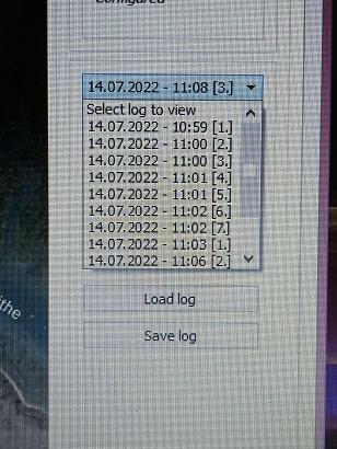

When I came to look at the geolink flight logs the first one was as normal, one continuous 4 minute log. With the second flight the log was split into 5 short logs which I've never seen that before.

I flew two flights today and all seem well with no problems in flight except when I checked the flight logs both were split up into many segments.

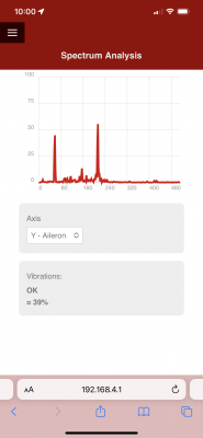

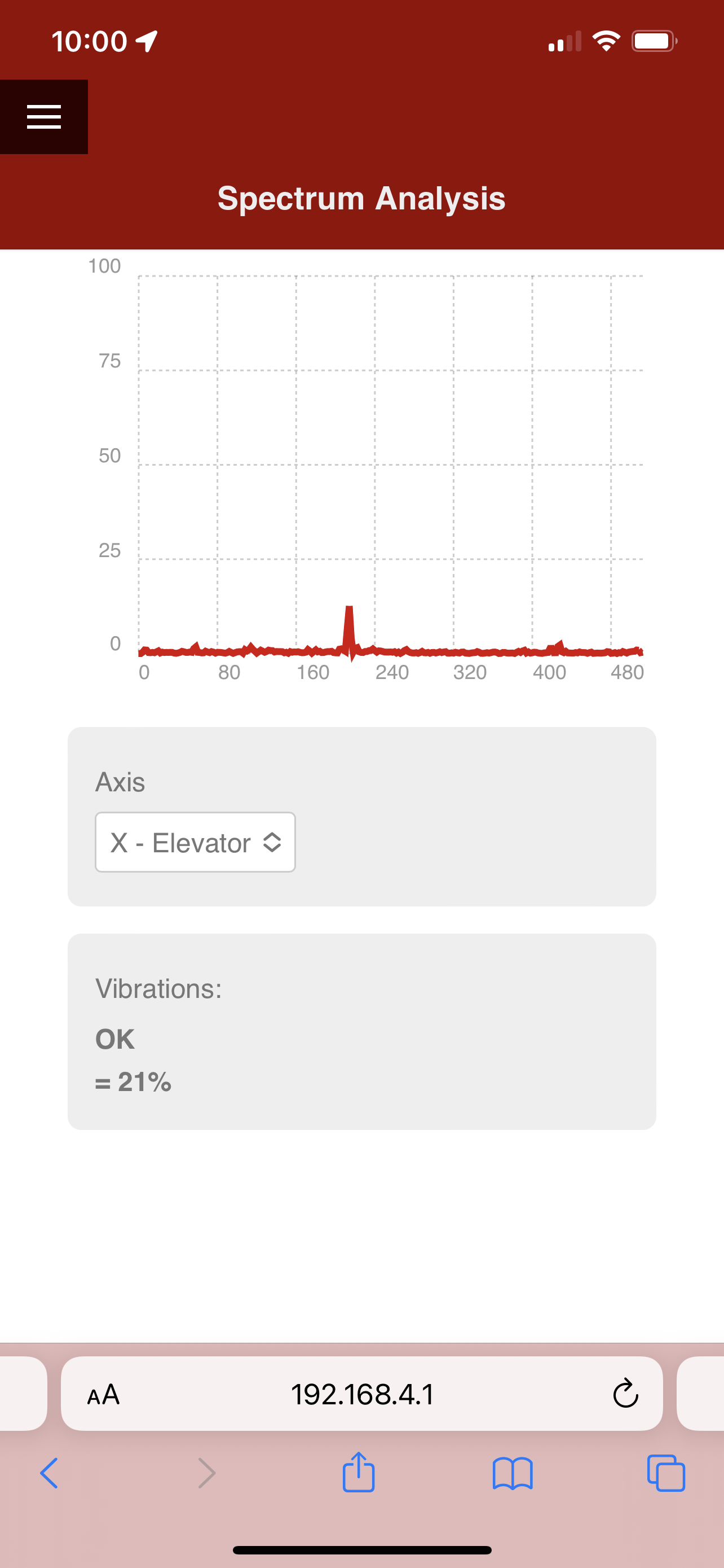

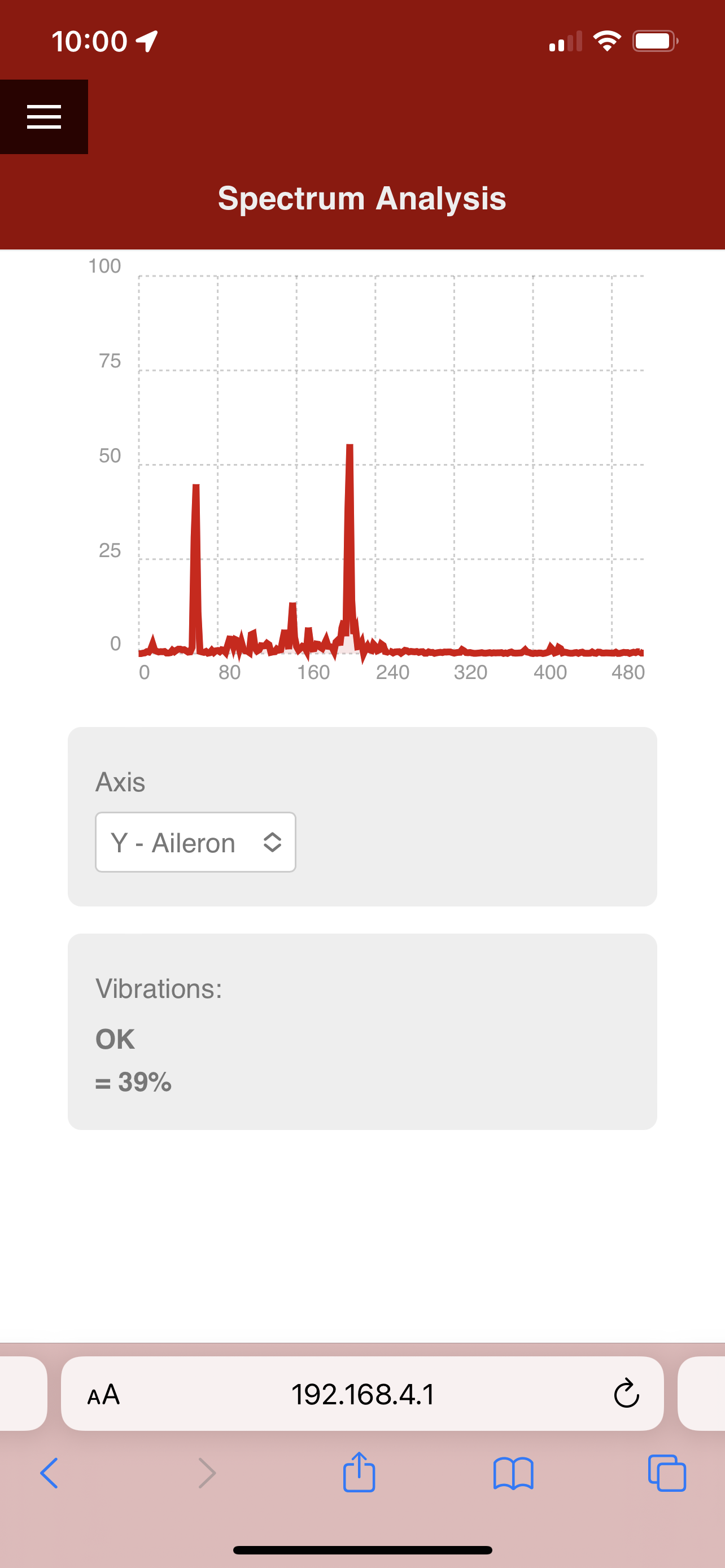

I've removed the main blades and carried out a vibration test using the spectrum analyzer (wi-fi link to iphone).
I have attached screen shots of results. There seems to be plenty of vibration so cannot see how the vibration level ever drops below 5% during flight?
