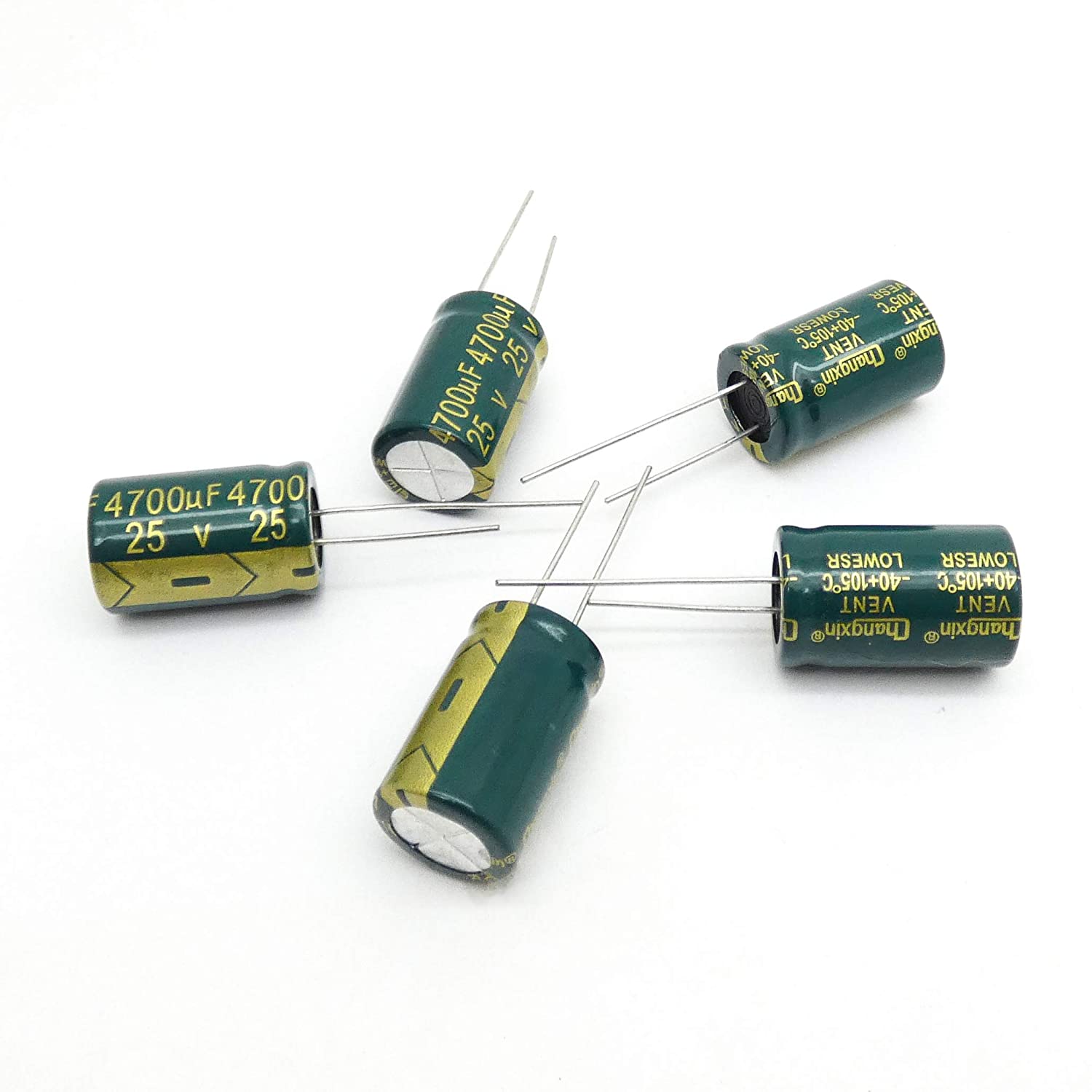

I always added some low esr capacitors
to my big heli in parallel to bec power
to avoid voltage drops

Capacitor can help in any way, but it could be enough to change connectors.
