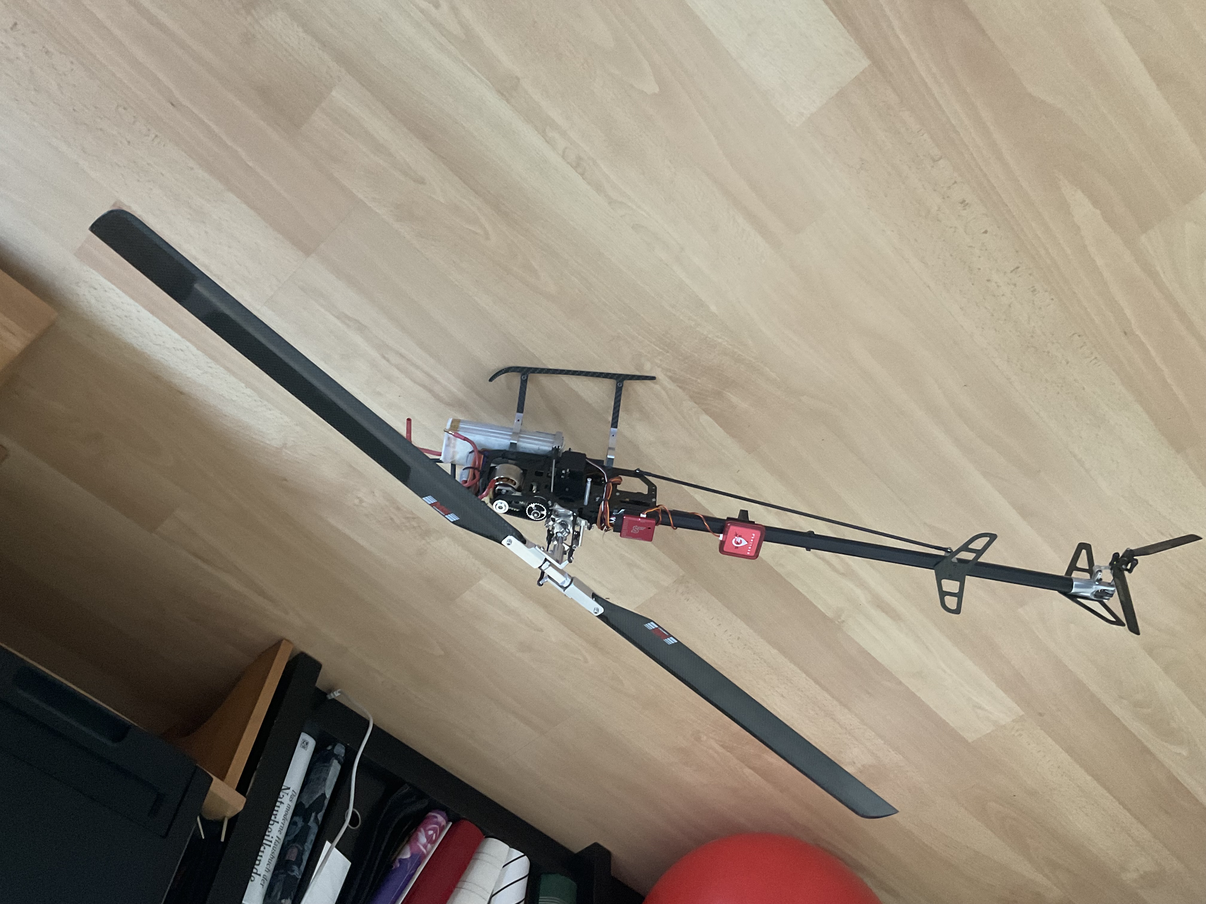

This evening i tested new geolink V2. FW 1.3.1.
Z axis very bad. By altitude holld, altitude limit and rth the heli jumps up and down. Not able to fly with this functions.

can you send your settings please?
Also any detail about your helicopter would be very useful.

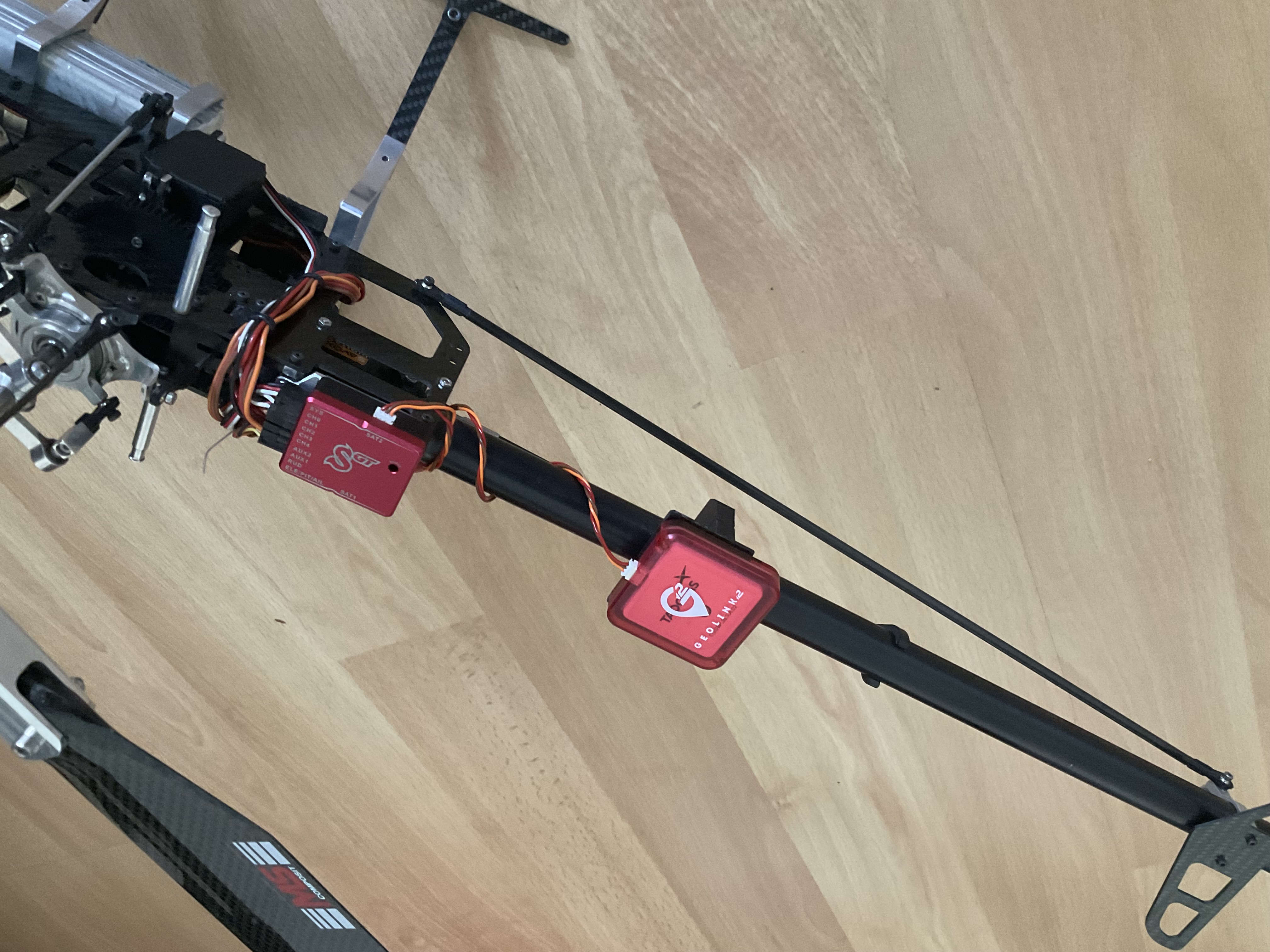

Today a new test. i only changed rescue pitch from 55 to 60%. It was much better than yesterday. Ar next i decrease altitude sensivity to 60%. I have mounted panel for geolink with two brass screws? Is that one problem?
