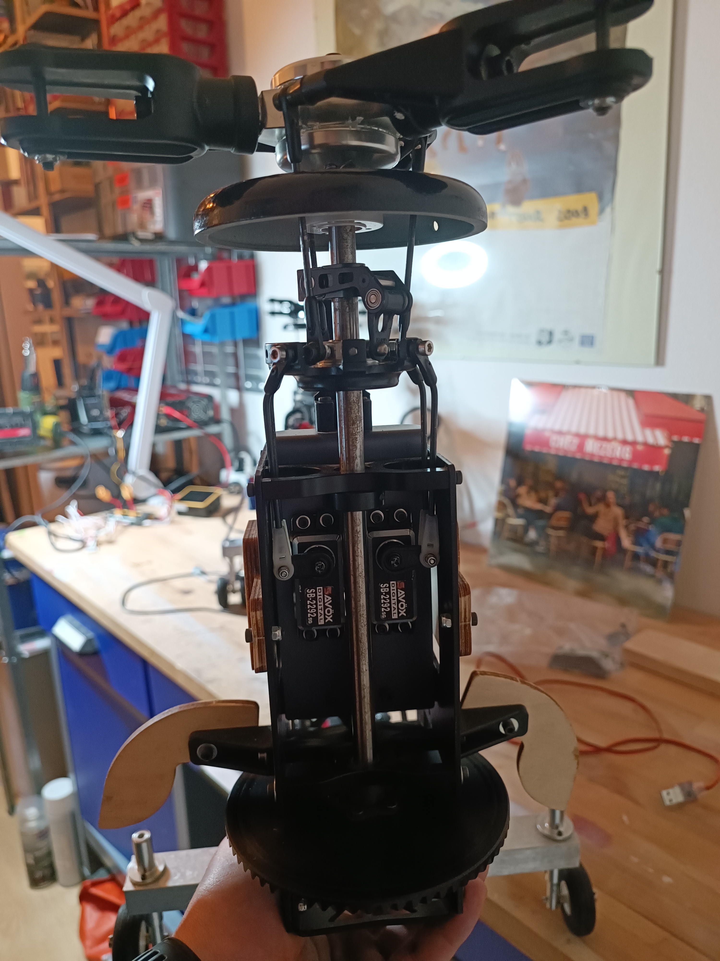

could you send also a photo of your mechanics please? I will check your settings and let you know. It is important to set Pirouette Consistency low, this should improve "Tail" behavior and increase rotation speed.
We are doing improvements for Tandem helicopters gradually, since the support was added recently and there are big differences in mechanics. If we will not find optimal settings for you we can make adjustment specifically for your model and then add it to setup wizard.

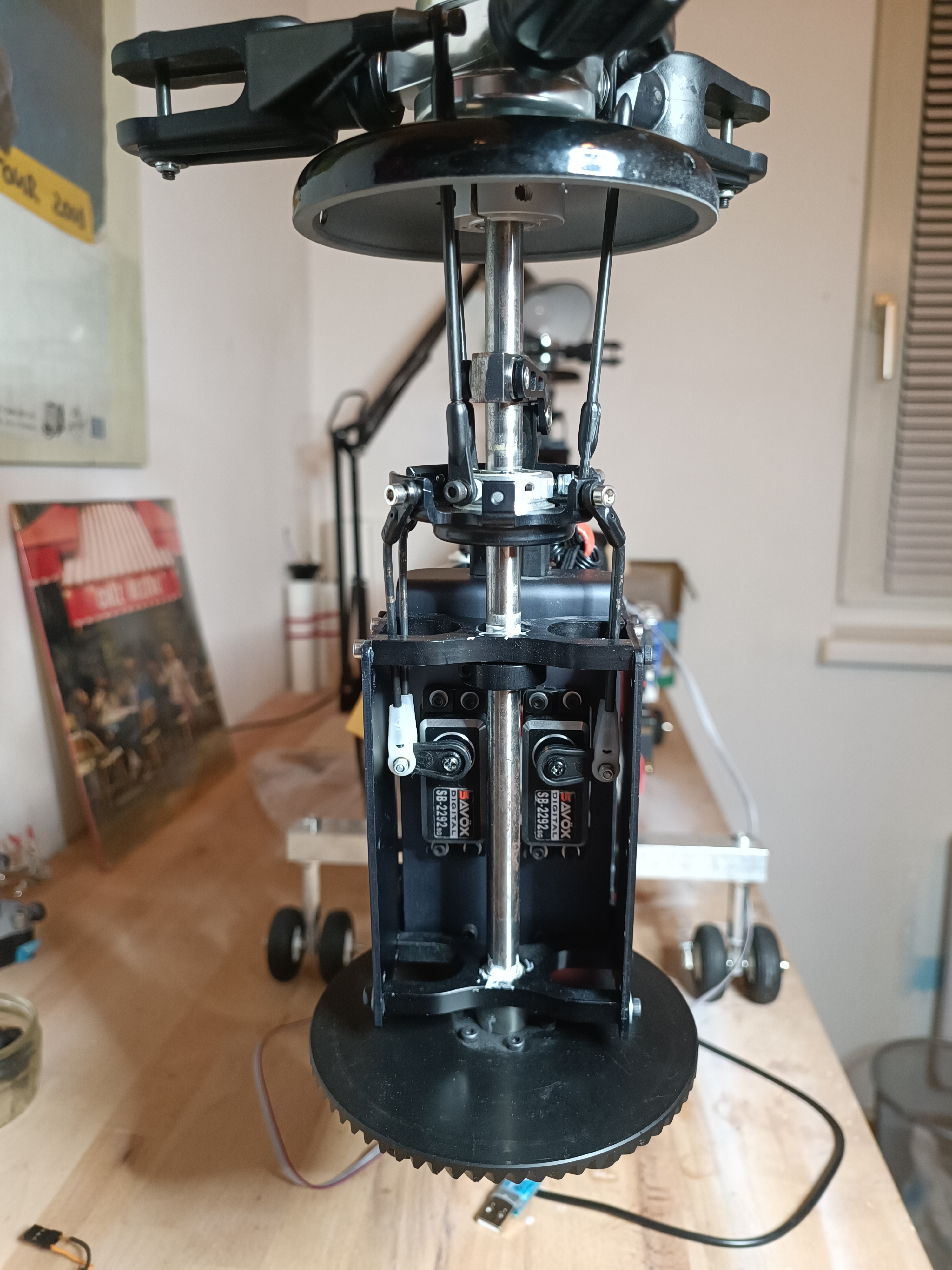

Front swashplate (rotating counterclockwise) from the side

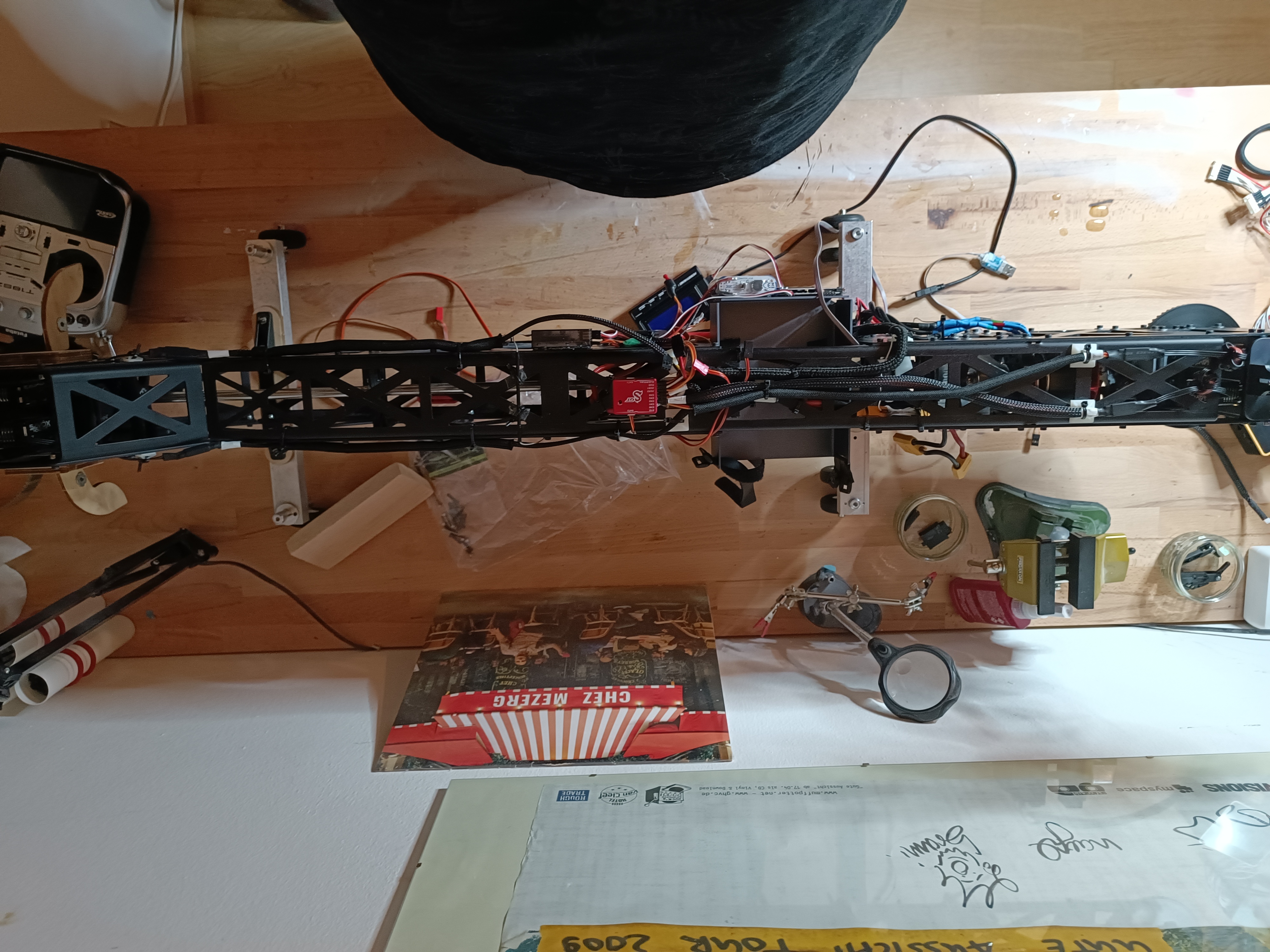

Mechanic, top view (bad angle, Spirit Unit is exactly in the middle of the mechanics ;))

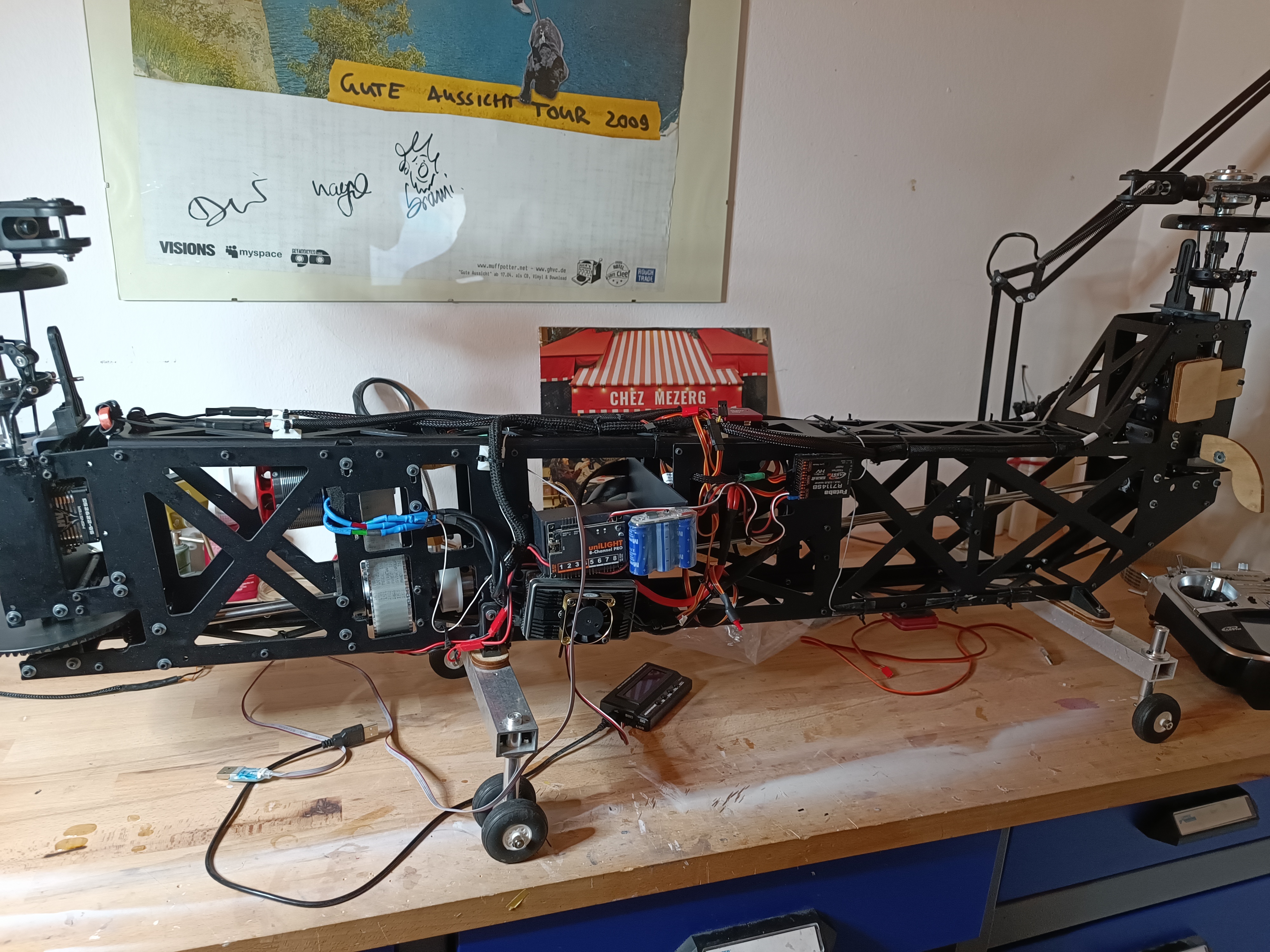

Mechanic, side view
Mechanic, side view

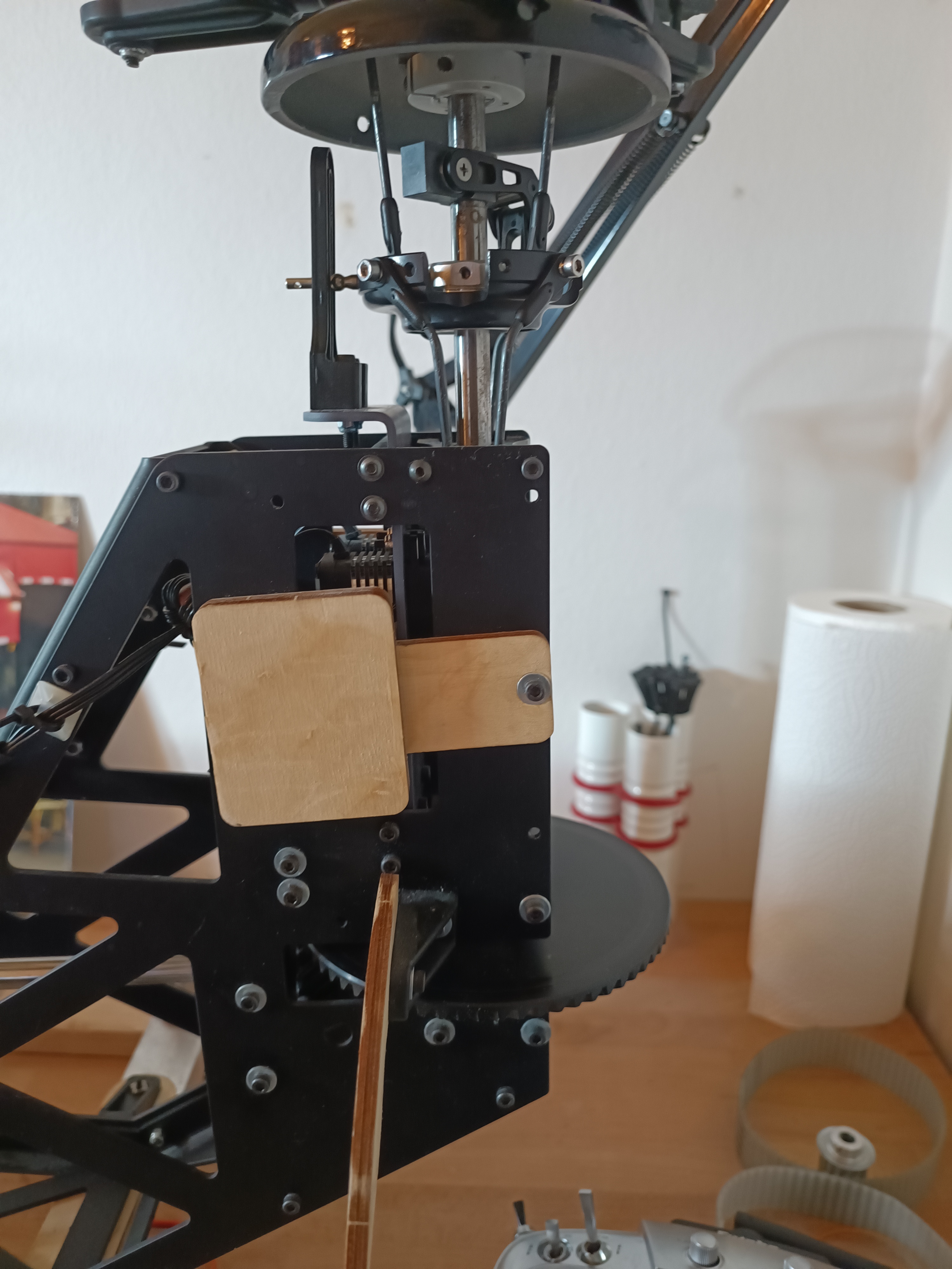

Back rotorhead from the back

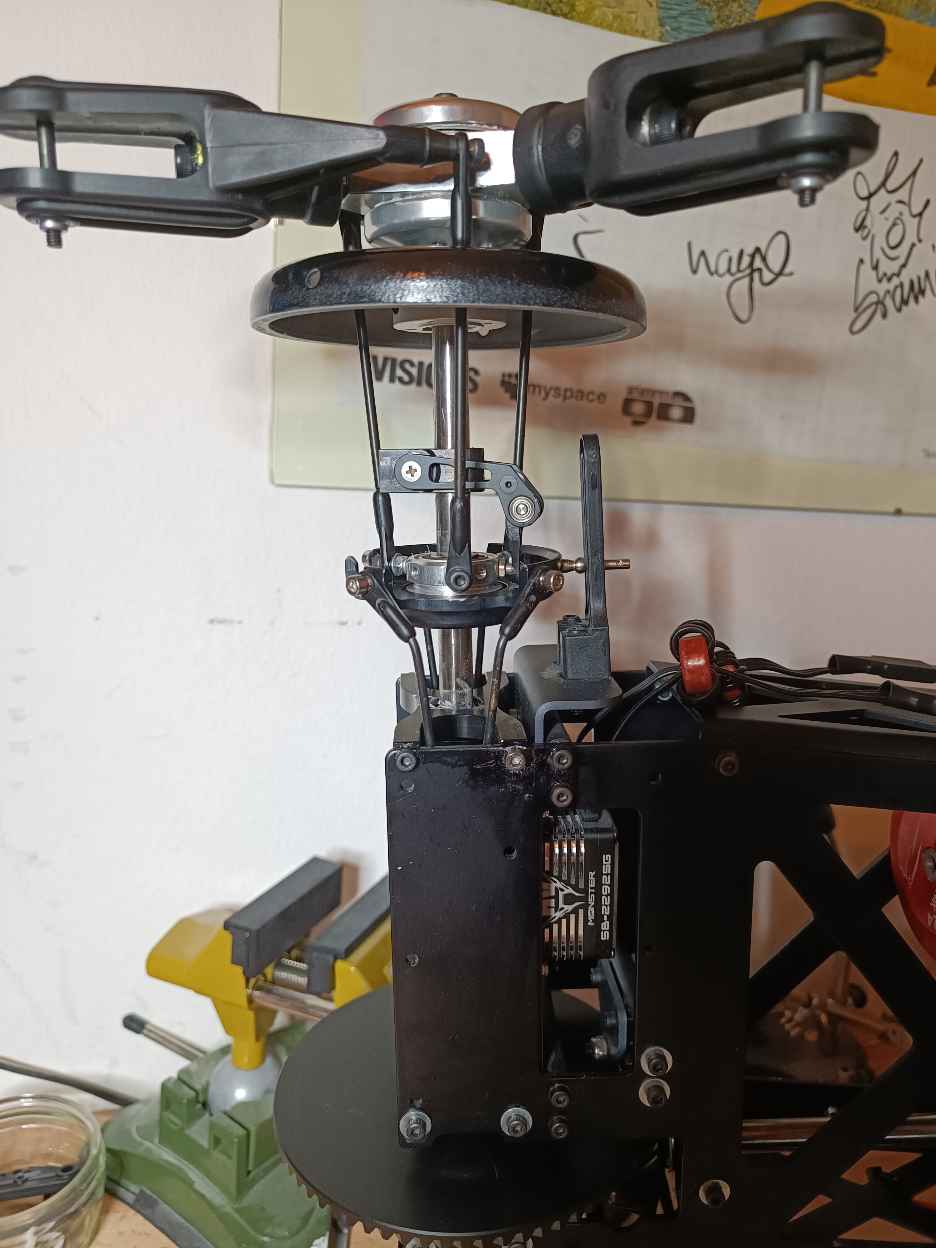

Back rotorhead (clockwise) from left side

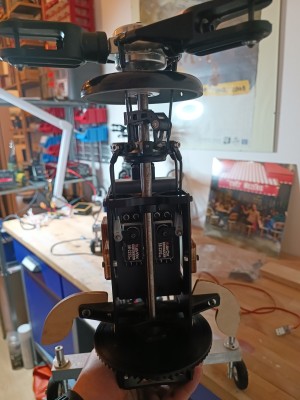

Front rotorhead (CCW), from front
