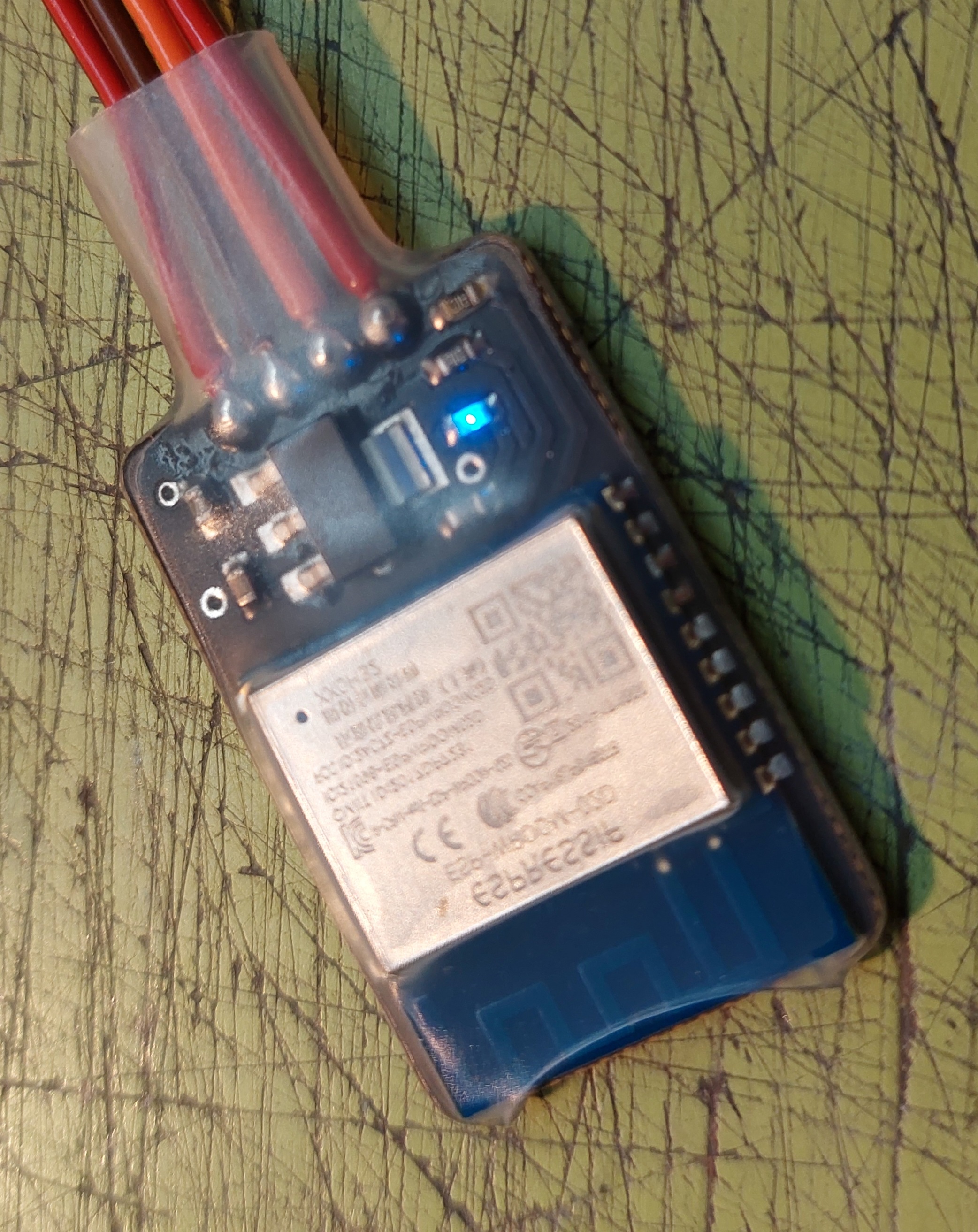

Second:
If i power the WiFi Link Module frome the spirit gt in mostly cases the blue led is solid and very dark, although the gt is powered. If i remove the power plug from the WiFi Link and wait a few seconds, plug it in again the led is bright blue blinking and connection is possible. See attached photos.

1. This is correct. There is no electrical flow if using a different power supply between Wifi-Link and Spirit unit. You have to connect GND between battery and Wifi-Link to make it work.
Yes, when powering up Wifi-Link together with Spirit unit it could end up in a special mode for flashing the Wifi-Link. We will try to address the issue with upcoming Spirit firmware. I believe it can be resolved.
