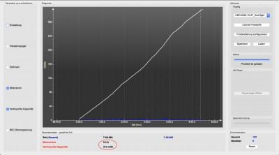

Today, I did my first maiden flight with a new heli (DIABOLO SE) with my first Spirit GT FBL on board. :D
So far everything went fine except, that used capacity shows ten times too low.
RPM, voltage and current values are accurate.
Attached a short log.
I-motor-shunt does not allow the required correction. Any suggestions are welcome!
Thanks in advance and best regards
Daniel

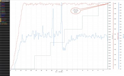

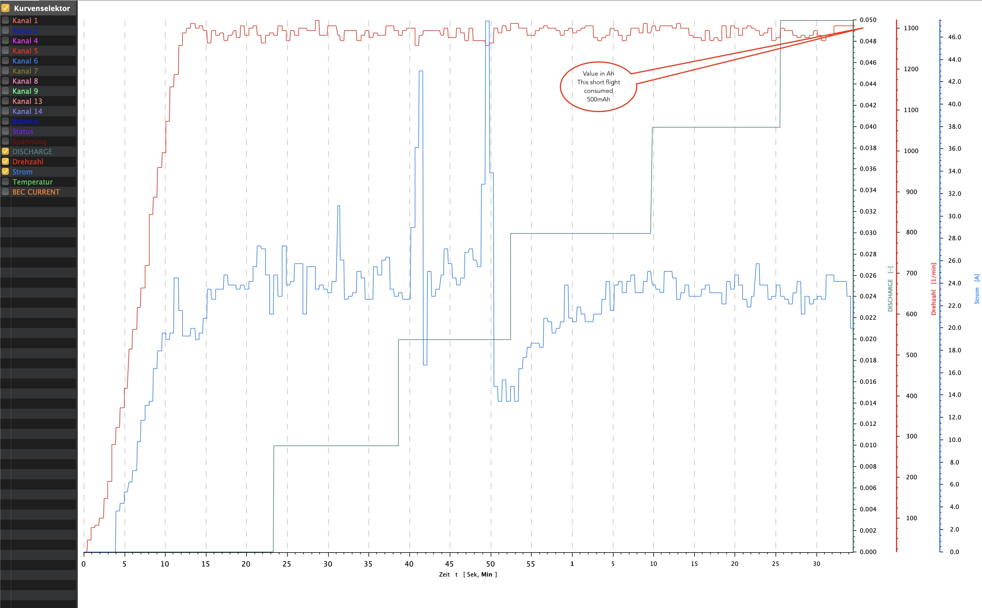

In contrast to the Futaba-Log in initial post, which states the real value for current (A), Spirit-Log shows current divided by 10.
See attachement.
Thanks for your support!
Best regards
Daniel
