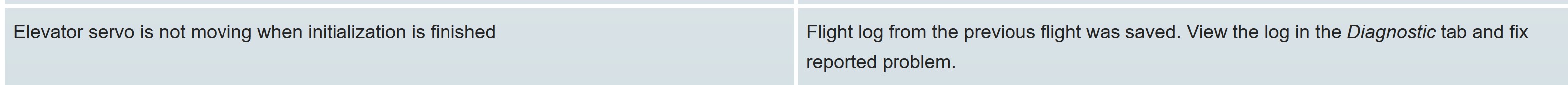

have you looked in Spirit Settings in the flight log ? If the heli initializes in this way that you discribed there is maybe an entry in the flight log - you should look into Log viewer before you are flying again because there is with absolute certainty an rlevant entry present -

https://manual.spirit-system.com/index. ... _Solutions
