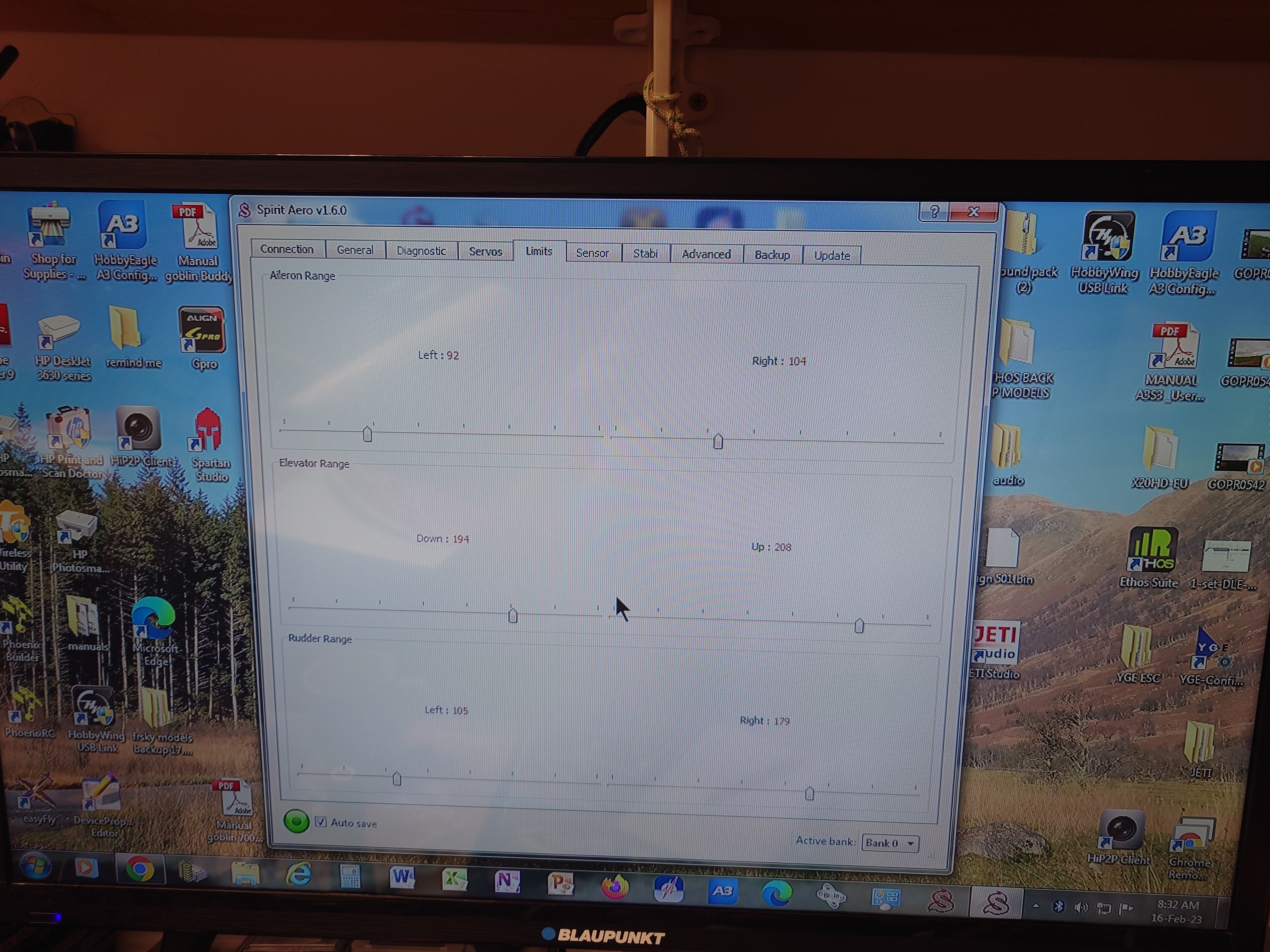

1. gyro reactions are correct,BUT the servo limit functions are all reversed? left is right up is down?? WTF?
2. Rudder will achieve full deflection at limit function setting but not under command from the transmitter despite 150% deflection set?
3. selecting bank 1 or 2 sees the program disconnect, no separate settings can be achieved weather selected on the transmitter or in the program...Why???

Can you post a printscreen of what exactly is reversed?
kim hill
Posts: 29
Joined: Mon 04. Jul 2022 19:57:03
The latest SW AERO is 1.6.0, the firmware update for the unit is 1.6.1
YES THIS IS CORRECT, ITS IN THE PHOTOS TOO

kim hill wrote: 1. gyro reactions are correct,BUT the servo limit functions are all reversed? left is right up is down?? WTF?
Hello
1. This could happen if Position of the unit is selected incorrectly or servos such as CH1 and CH3 are swapped or it require just reversing the servos in the Servos tab.
2. That is correct, Spirit unit is doing active stabilisation - same as for helicopters. Stick operation at the ground is different than what is happening in the air.
It also depends on what your Global Gain is. Higher value will show as bigger deflections.
3. This could happen if there was some invalid value configured in the unit or used software version is older.
It can be resolved for example by pressing Reconnect and saving the settings at current Bank.
Definitively the unit is not faulty. If there is some difference it just mean there is different settings between units. It is very easy to Save the settings to your computer and then load it in another unit - but for each bank, not just one. Then behavior will be identical.
If something is happening that is not usual it does not mean the unit is faulty. When one will understand what is going on then each odd thing can be explained.
