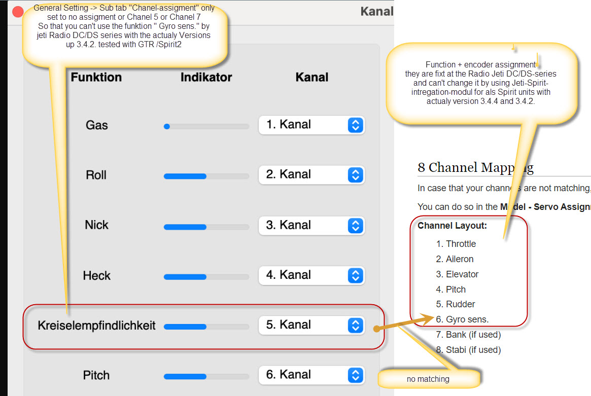

dear thomas i had question about the Chanel assigment about jeti Spirit-Intregation actualy Version up to 3.4.2?
Something are wrong maby? i have add. a pic. for explain it easyer.
an idea? :?: waht's wrong? :o :roll:
Tested with jeti Radio DC16 II Version 5.06 Date 12/22
pls. check and reverd.
best regards Achim

These are just numbers of channels. But each manufacturer has different layout, so with one product channel 1 is is throttle for example, with other product it is aileron.
When you will set it according manual all will be good.

I struggled with this also in my setup trying to get my tx16s to put out the outputs to the channels on this page. It is clearly explained from the point of view of the creator not from the view of a poor novis who is moving up from a beastx.

For some radios like TX16S it is enough to set stick layout from AETR and it will just work in the same way as with Futaba out of the box with no channel layout changes on both sides.
Unfortunately OpenTX developers selected to go their own route causing differences even when using protocols developed by Futaba.
