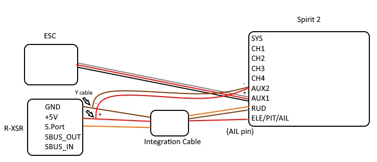

Hi guys, just looking for clarification on my understanding of wiring up a Spirit 2, R-XSR with F.port firmware, and Spirit FrSky integration cable.
According to https://manual.spirit-system.com/index. ... rSky_FPort, the integration cable alone can not power the receiver:
Please connect also a direct cable for powering the receiver to AUX2 port if possible - this cable is supplied with Spirit unit. Alternatively you can use a secondary BEC power cable to power the receiver. FrSky integration cable can't feed power to the receiver alone so without this, it can't work.
Since the receiver only has one +5v pin, am I correct in understanding that I will need to run a cable from AUX2 into a Y harness (or solder) to combine the red wires into the +5v pin?
Edit: added diagram

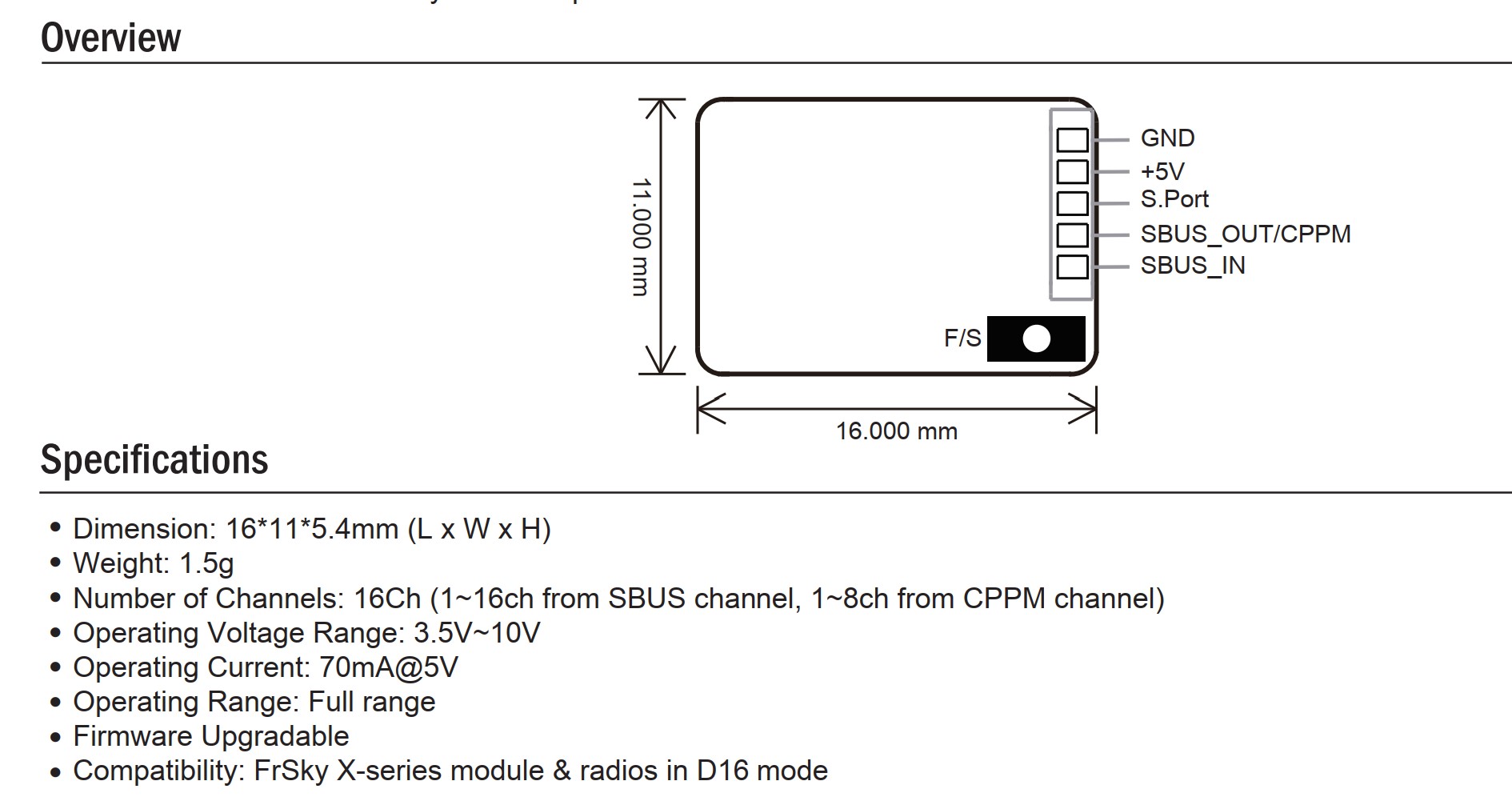

I think you need extra cable from Aux2, I would take plus and minus and no signal !
You can take an Y-cable to connect both plugs together -
And about the 5V+, thats only the positive pole for the powersource -
Operating voltage range is given by FrSky in the attached picture:

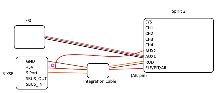

Oops, yeah you're right. Thanks for your help.
Updated the diagram. How does that look? Is there anything else I might be missing? Apologies if these are noob questions, I am a cave man from the nitro flybar FM radio period.
Posts: 637

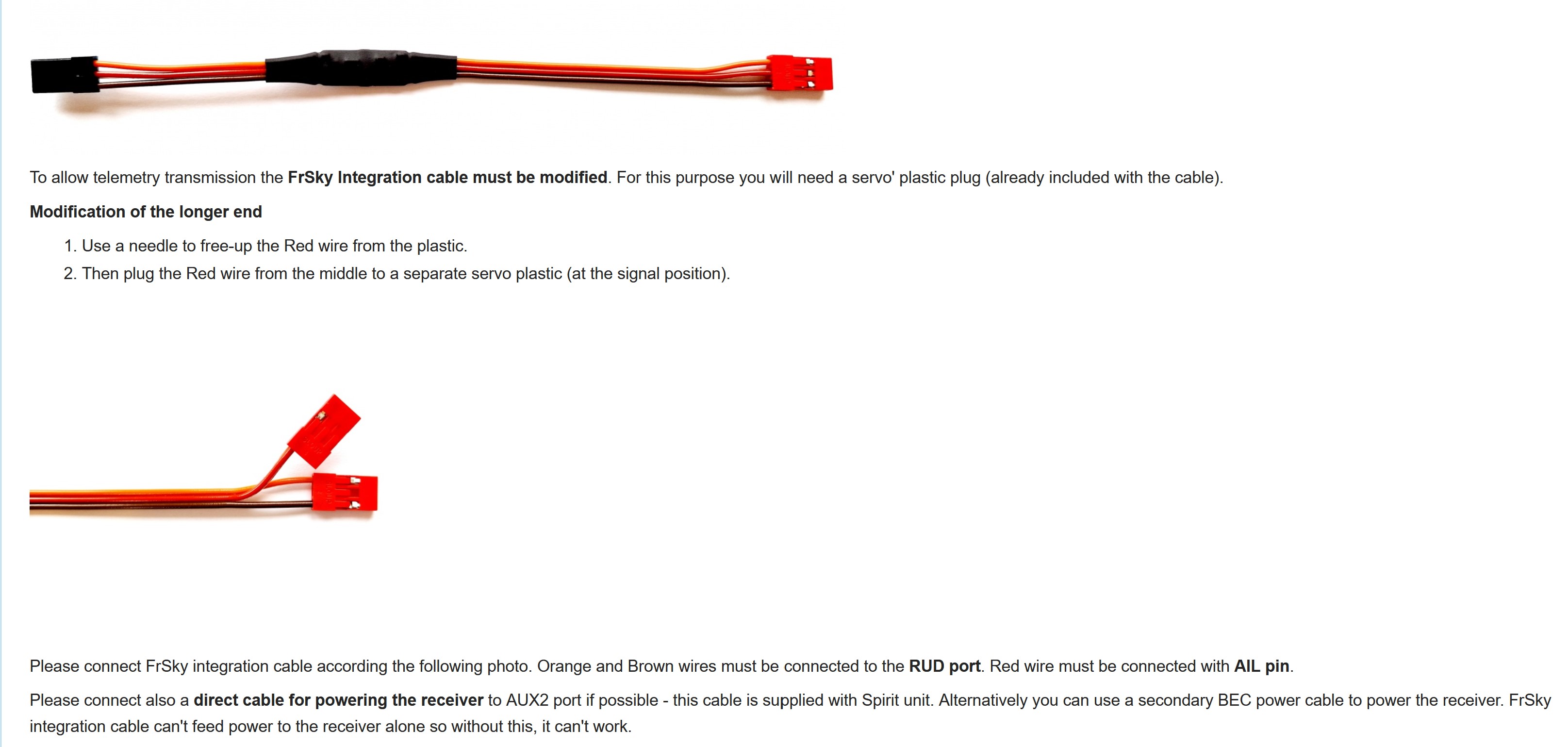

It looks like as in the manual said - that should work !
here an additional hardcopy from the manual:

Thanks a lot mate. The thing that still confuses me is that the Spirit 2 manual states that it includes a cable for this purpose. Maybe the level of assumed knowledge is higher than what my lizard brain has, but the unit comes with a couple of standard servo cables and a 3-pin at one end, which splits into 3 separate connectors. I don't see how this configuration can connect these components without the addition of a Y-cable or soldering? Do other receivers have additional power pins? I'm new to the modern RC landscape so this stuff is new to me.
