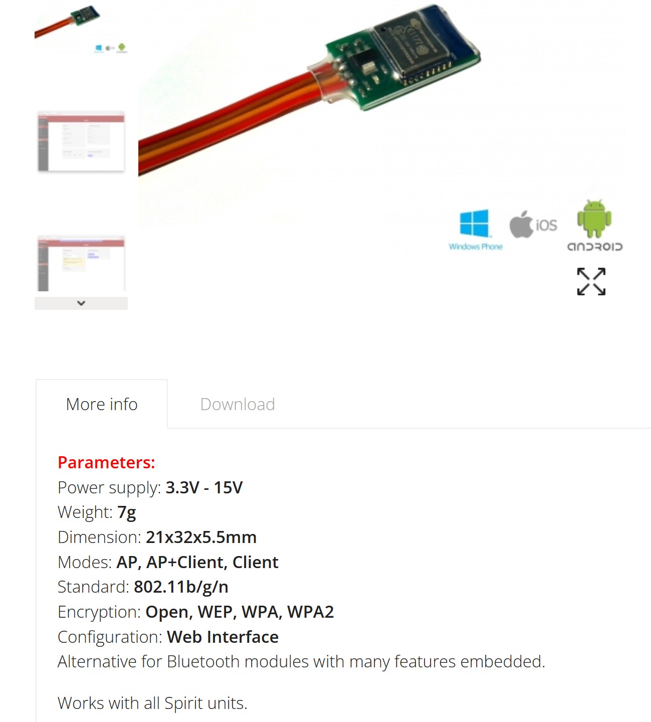

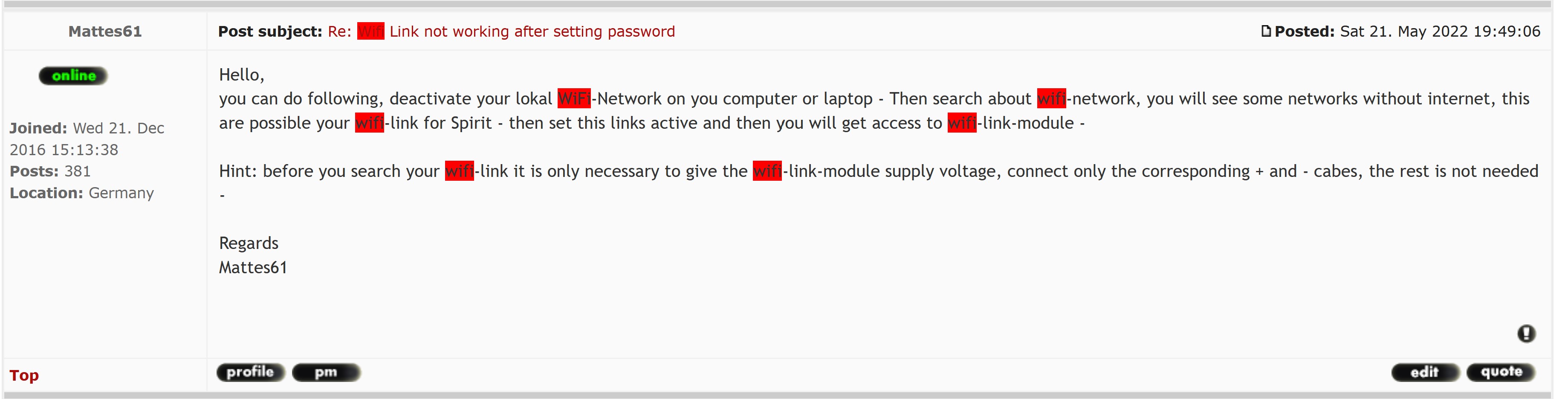

Some time ago I had a problem too to connect the wifi-link to the Spirit, maybe this can help you -

If not I think if you had this for 6 years you should buy the new one, this has additional features in future like Tomas said in an earlier post (I think it was blue tooth too) -

I think I will ask Thomas. I don't want to buy a WiFi-Link which will have same problem. As I see on the webpage, it looks same like mine and has same functionality. But maybe something was changed in between in internals, or mine has some problem.
Posts: 638
Sorry, I think I have some mixed up -
what I meant was the Spirit-Link-Module but this is at the moment only substitute for the bluetooth-Module, in near future it will be also substitue for the wifi-link Module -
That's what I didn't know exactly anymore... :(

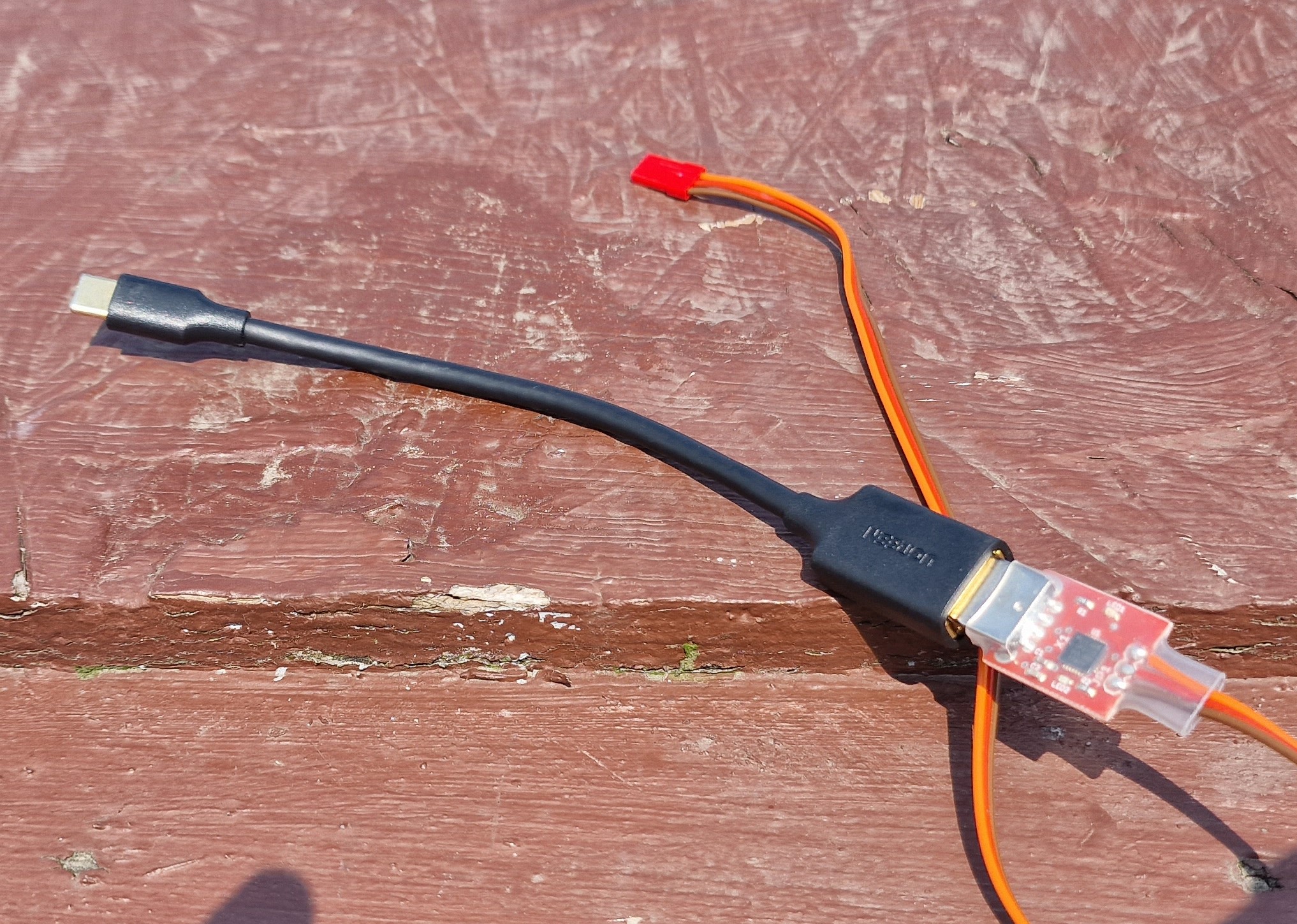

The cabling I made works BTW.
azaz44
Posts: 288
With OTG cable I mean this.
This is how Scorpion V-Link works - you can use same cable both with PC and smartphone.
I tried it today and it doesn't work. I think Android app just doesn't support cable connection at all.
Could this possibly be added?
This would be super cool, we could just configure Spirit in the field with smartphone and standard Spirit cable.
