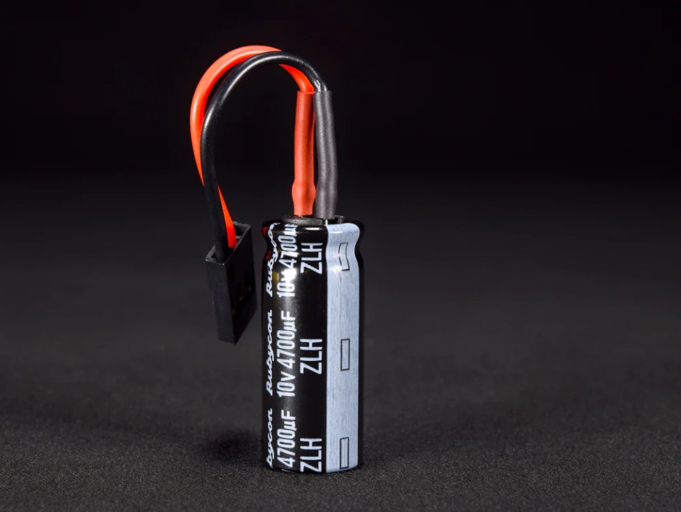

comes supplied with hobbywing esc
4700uf 10v

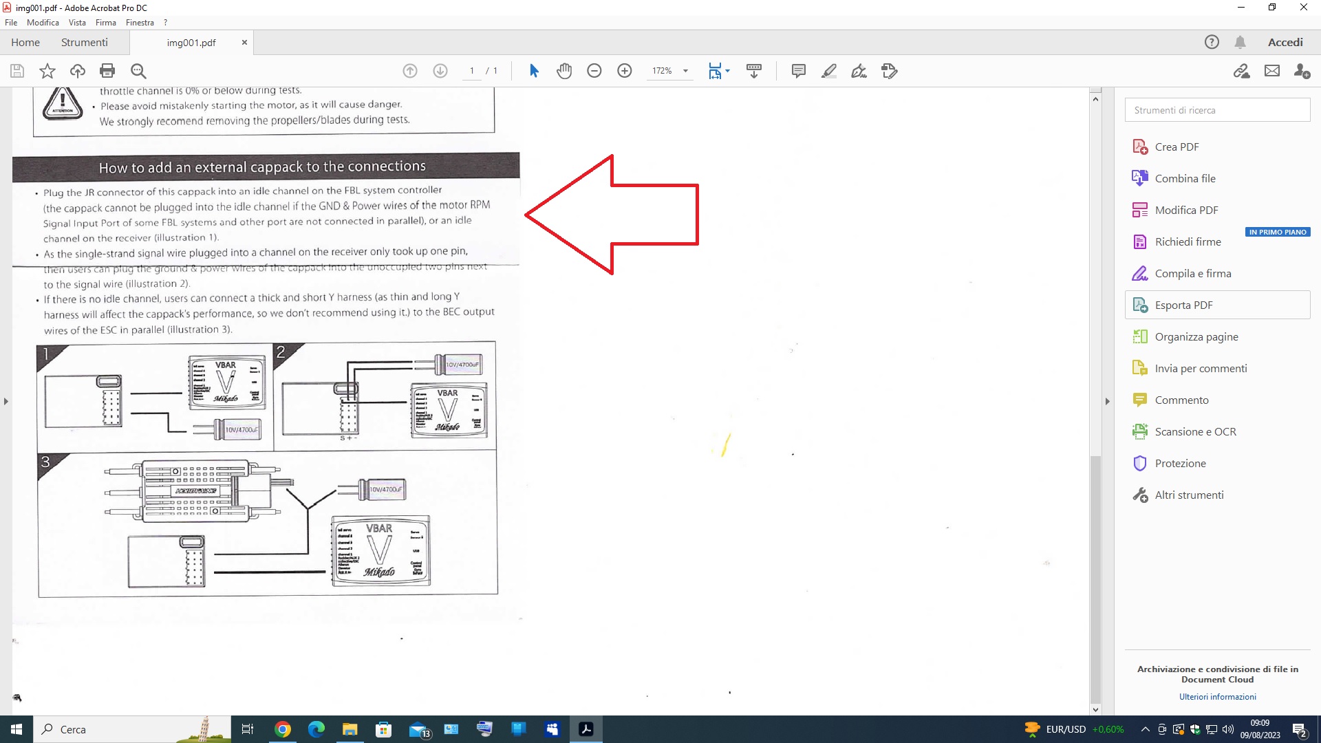

img001.pdf
(517.9 KiB) Downloaded 93 times
why the manual says this:
Plug the JR connector of this cappack into an idle channet on the FBL system controller
(the cappack cannot be plugged into the idle channel if the GND & Power wires of the motor RPM Signal Input Pon of some FBL systems and other port are net connected in parallel), or an idle channel on the receiver (illustration 1 ).

And the condensator that is coming with the Hobbywing ESC, plug it in a AUX channel
Spirit Flybarless.

img001.pdf

and the capacitor? I can insert it in a free port (e1)? I would not short circuit the spirit
Posts: 630
Hello Franz,
look at the spirit RS Wiring in the online-manual...this should not be a problem, you can it put in E1 -

this is manual capacitor hobbywing
Posts: 630
Hello Franz,
I have already equipped many ESCs and helicopters with capacitors - if you use the capacitor e.g. if you plug it into the FBL side via a Y-cable, there will never be any problems! There is only a restriction on the controller side if the manufacturer says that such capacitors are not permitted, but that is not the case with Hobbywing, YGE and others - this capacitor has no place on the motor side, it would explode immediately! A capacitor, as long as it is not defective, can never cause a short circuit -
