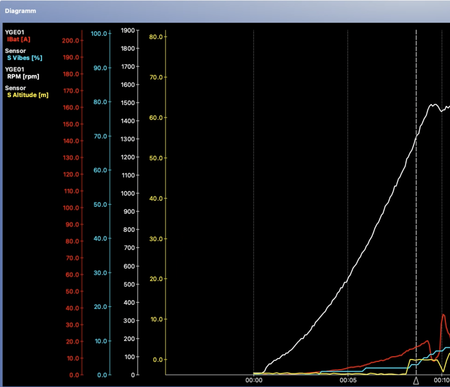

yes, should be exactly like pking wrote: i do have the same situation (even more as starting location is a bit lower alt on the field), see spoolup log attached >> close to -2m on startup of the heli (logging starts), height jumps to 0m during spoolup of the heli (before takeoff). seems to be based on vibration level >= 3 or similar.
cheers
Michael
