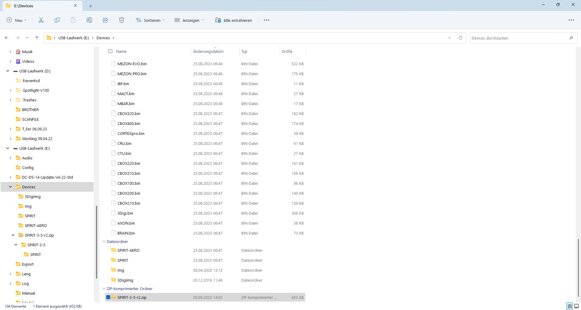

Good morning and thanks for your prompt reply. I attach the requested screenshot from my Jeti DC-14.

Thank you for the screenshot. Now I can see there are some files. But Spirit.BIN file is not there at the moment. So integration will not work.

Good morning, I have watched the video, deleted the installed file (zipped version) and have downloaded the file, unzipped it and copied the files across to my Jeti DC-14 transmitter.
The error message is still there. I await your direction on the next steps.

Hi all, once again a good result coming from a direct intervention. The connecting was a bit of a long trial but the solution was delivered almost instantly. Files were sorted out to make sure there is agreement with dates.
