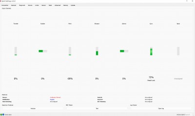

... do you have (by luck) a log of the vibration level of the heli? and a log of the inputs (sticks/channels). vibrations or non-centered sticks/channels (maybe even sub-trim?) are 2 easy reasons for such a drift.
if it only is visible after some minutes of flight, you may even need to check all this after flight - do not switch of the heli, check channels in diagnostics page - all still centered? and - of course - vibration log in flight.
cheers
Michael

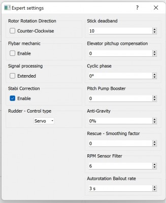

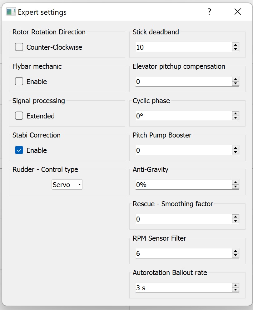

Following ZeXx86's advice for other pilots, I enabled Extended Signal Processing after discovering via forum reading that other people have experienced similar problems.
https://www.spirit-system.com/phpBB3/vi ... =20&t=5786
I do not know the difference between the two settings for the best performance on this page:
https://manual.spirit-system.com/index. ... ise_Rescue
There are two parameters that can greatly improve the reliability and precision of the stabilisation andrescue modes:
Stabi Correction and Extended Signal Processing
Both can be found in Advanced-Expert Settings.
While making some tests, I noticed that on the bench, if I activate the stabi, the heli will tild just a little bit to the right.
Theo

yes, check the vibration level... there are several reasons for vibrations of a heli that has not been used for a while (dried dampers, dead bearings etc etc ppp). and check sticks middle point after flight if it should drift again. those are points to be cleared out easily if found. and: do you use a Esc fan? some of those are creating super sonic vibrations that may cause issues like drift too (esp. HW fans).
cheers
Michael

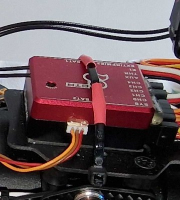

franz88
Posts: 340
to reduce vibrations on my trex it worked well changhe the dumper rubber and the double-sided tape under the control unit.
also the electrical clamp with heat shrinkable sheath which maintains the spirit decreased my vibrations by 50%.
I have a photo of the goblin but I also have on trex

franz88 wrote:to reduce vibrations on my trex it worked well changhe the dumper rubber and the double-sided tape under the control unit.
Nice one thanks.
Will replace the old original double side tape and test your method.
Theo
Sent from my SM-N986B using Tapatalk
Posts: 12932
I do not recommend using a cable tie. I also highly recommend using original double sided tape - only one layer.
Please use Spectrum Analysis tool in the software. This will help you to find if there is vibration problem or not.
It is best to measure with tail blades on, because problem is usually in the tail mechanics.
