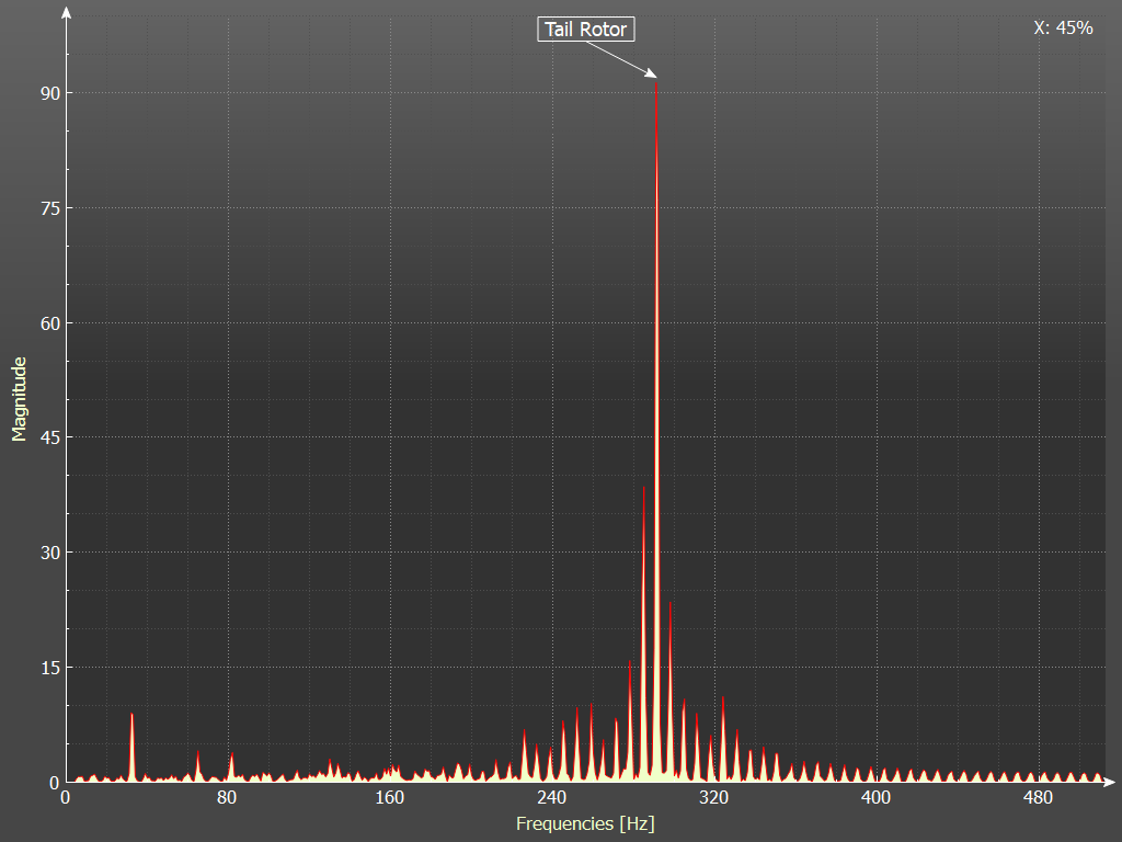

The X and Z axis shows minimal vibrations when I use the Spectrum Analyzer. But, the Y axis shows extreme vibrations. I've checked every nut and bolt, rebuilt the tail rotor assembly, and ensured everything is mechanically free to move.

I've attached the spectrum analysis charts and my settings file.ZeXx86 wrote: You can share your 4ds file settings, too. I will inspect it.
I've rebuilt the tail section exactly to Align's specs. There are no missing pieces or hardware. I'm not sure what else to repair or replace. The tail rotor hub is new.
However, I will run the spectrum analysis without the tail installed to see the result.

thank you for the plot.
These vibrations are unfortunately terrible, I would say more than extreme. I highly recommend to not fly in this condition.
It seems they are coming from motor, but interestingly also from the tail.
Please note, when you install tail blades, vibration level will further multiply by a factor of 3 - 10 usually. So it is miracle it could fly actually.
Could you start the motor without any other gears?
In this way we can find if it is starting from the motor itself. If so, it will be a faulty bearing or something like that.

Anyway, I've attached some spectrum plots with no tail and other parts attached.
The tail rotor shaft is bent, but just a little. I've never struck the tail, so that is odd. But I ordered another one, and it's on its way.
I'm not sure what to do about the motor. I've only put maybe 8 hours on it.

First you could try to reduce Governor gains if it is used.
I am afraid something is vibrating there so much I have never seen.
Please do not fly with a bent shafts, because with each flight there is excess wear of a bearings. This mean other components can be damaged and will require replacement.
If there is bent shaft it could cause wag as well, because mechanics will not move freely under high RPM.
