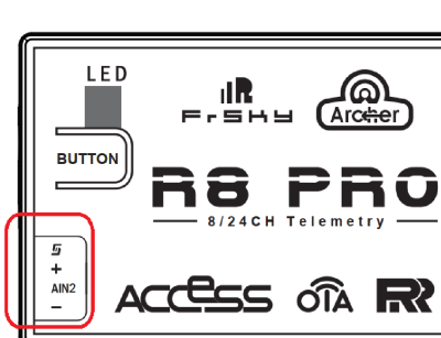

you wouln't try FBus ? That's a better and faster protocol and available with the X20 -
One thing you should keep in mind: explicitly only set 16 channels in your remote control, that's really relevant! The whole thing won't work with the setting in the remote control with 24 channels, as Spirit doesn't support it at the moment, so I suspect that's your "problem" -
What FBL do you have, Spirit GT or Spirit II ? You have said nothing about it -
Edited: new picture added the picture before was not completely correct (20.05.24, 13.03 Uhr)
Addendum: You have to use the SPort-interface for FPort or FBus, see in the added scrennshot -

Hello Mattes,
thanks for your reply.
I got an spirit2 unit wired as shown in your diagramm. using an other plug solved my problem, don't know why.
for now i use the f.bus protocol, which runs fine but no integration at all on my x20s. :-(
if anyone know to solve the integration problem, i'll be very happy.
