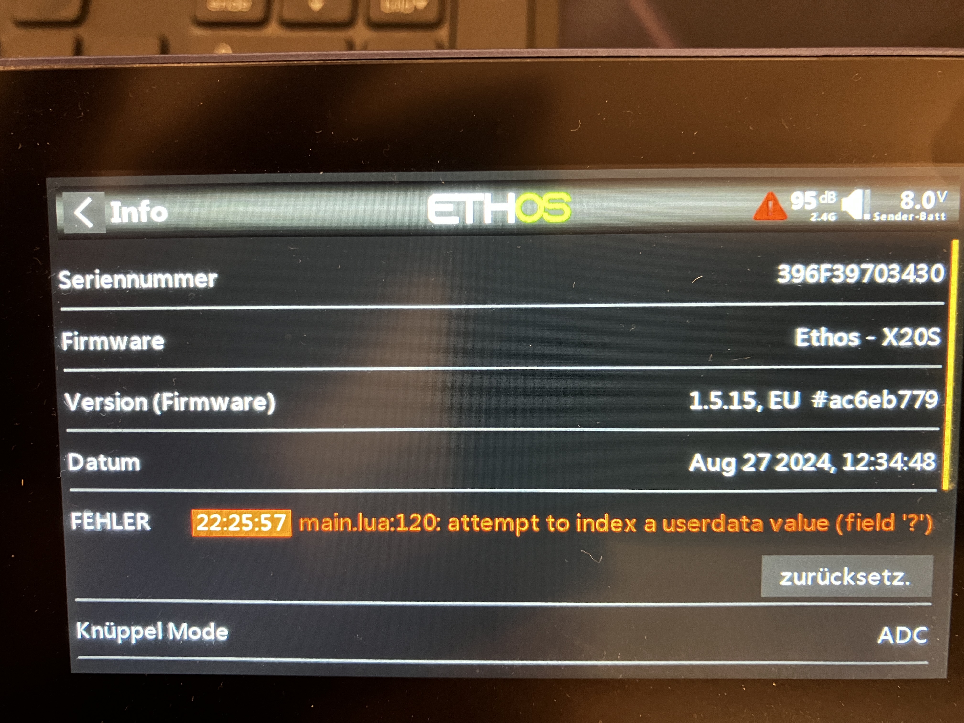

I downloaded the latest Spirit LUA script version for my FrSky X20S yesterday (23.10.2024) for FrSky integration.
The script bug still exists and has not been changed to the new Spirit version that an LUA error is coming up after pressing the save button in the macro.
The changed values will be saved in the Spirit but the error need to be deleted in the transmitter afterwards.
Screenshot is some month old, but still valid.
Please can you fix this?

No, it is that the LUA script for Ethos has to be modified, but it keeps going round and round, with the next update Ethos will change something and LUA will not work correctly again.

Bug solved, thanks a lot!
You can find the download link and follow up here: https://www.spirit-system.com/phpBB3/vi ... 7&start=80
