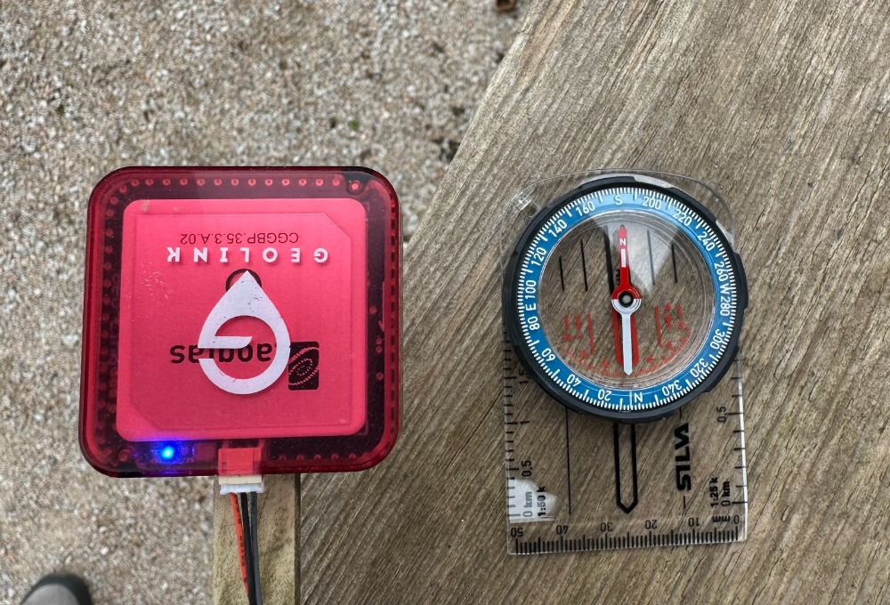

Well, what am I doing wrong?
For the first time, I took the testbed heli with the Geolink outside. The unit is mounted in front of the heli with the cable outlet facing the rear. I changed the settings accordingly to "180".
I re-calibrated the Geolink once more, and plugged the battery out / in after I got a steadily blinking blue LED.
According to the WiFi-Link page, the Geolink got GPS Data from 10ish satellites.
BUT: I can´t get the compass heading to show 90°. I tried with altering to compass correction - but this is only possible from -45 to +45 degrees, right? I attach some pictures to show what I mean.
Any hints what I am doing wrong here? Thanks and best regards - Paco

Posts: 12920
Unfortunately comparison is not made correctly between both. It seems GeoLink has to be turned around by 180°. When you turn it correctly, it will display 90°. No need to set any correction angle in that case since error look to be very small.
