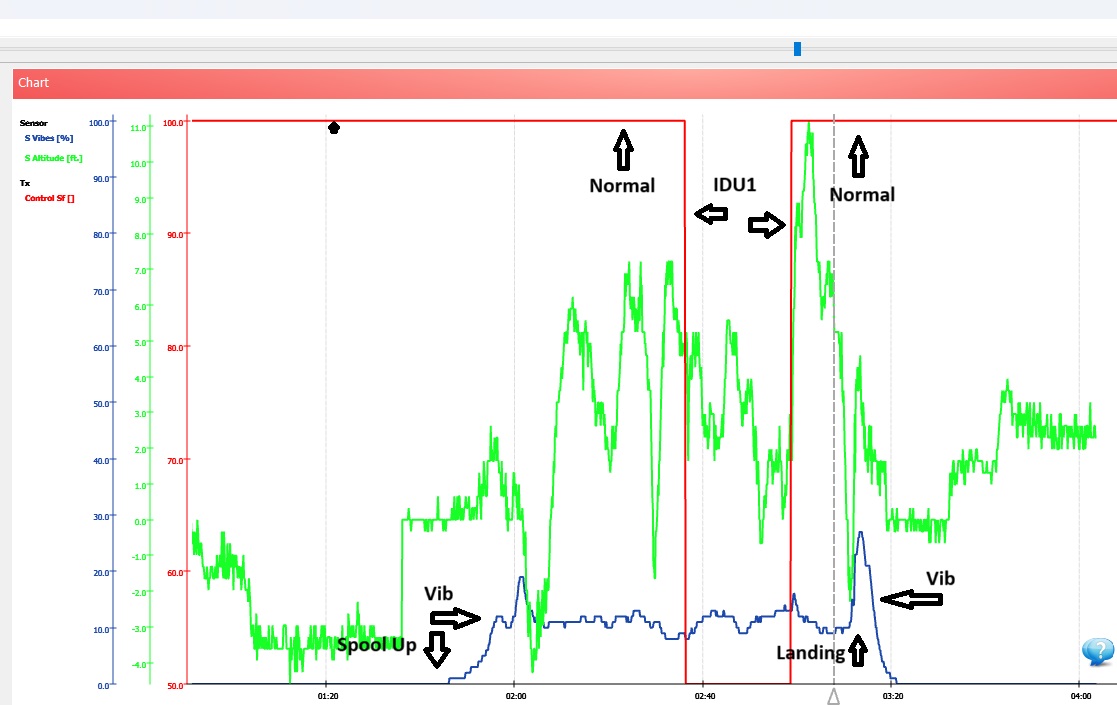

Maiden flight: my friend met me at our field and reviewed my setup and controls. The heli lifted off in Normal mode without issue. In IU1 we saw some oscillation in the cyclic (head) the tail was rock steady. Landed and adjust the cyclic gain up/down with no change to the oscillation. At this point I setup the telemetry in my radio to log the FB’s units vibrations and the FM switch. The log did not show access vibration at any point, in the way I interpreted the data, the vibrations smoothed out once I switched to IU1 (attached). At that point we did a quick search on the Tron FB page about oscillation on the Tron 7.0 and found that some people had to change to stiffer dampers.

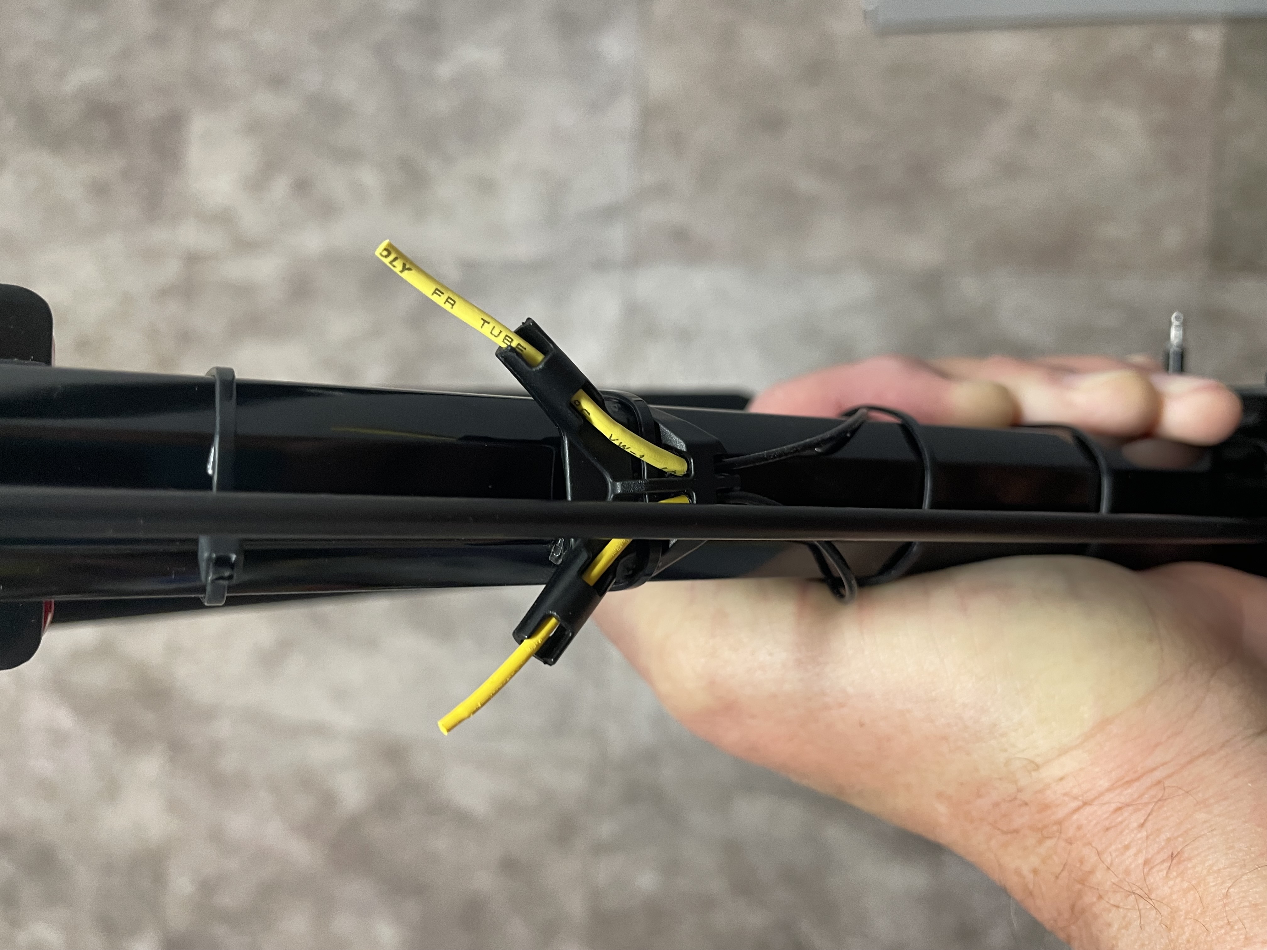

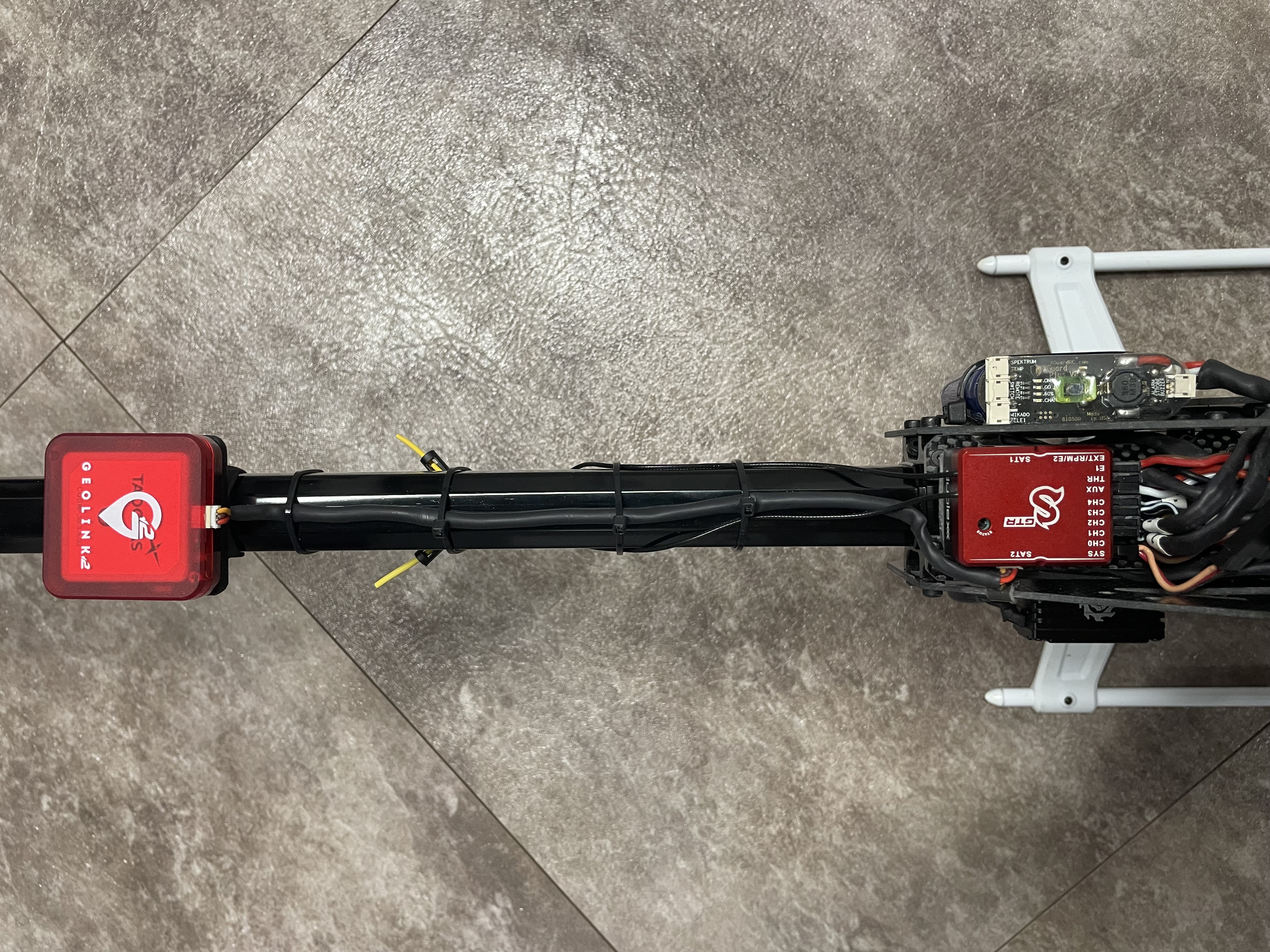

I also added two pictures of my antenna position. There as far away as possible from the servos.
Thank you for your help!
