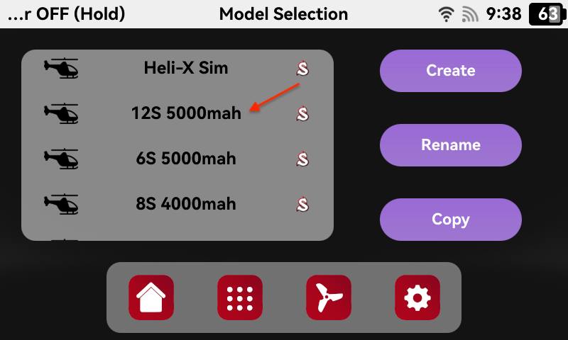

I created separate helicopter models and named these helicopters models as per the LiPo batteries I intend to store in the battery folder. In this example, I want to organize 12S 5000mah batteries. I named the model 12S 5000mah. (see attached picture).

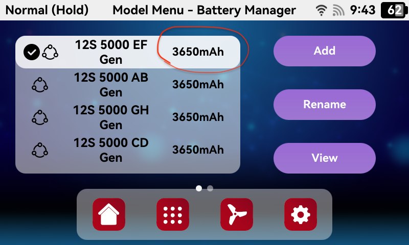

On the battery folder, I added 4 batteries, which I named by cell count, capacity, the two batteries I am using (E and F), and brand (Gen for Gens ACE). Since I am using 73% of the capacity stated on the LiPo label, I entered the capacity as 3650mah, which is 73% of 5000mah. The idea behind this organizational method is that it will allow me to adjust the battery capacity as the battery ages in the battery root folder which will in turn apply globally automatically to all helicopter models using these batteries. (see attached picture).

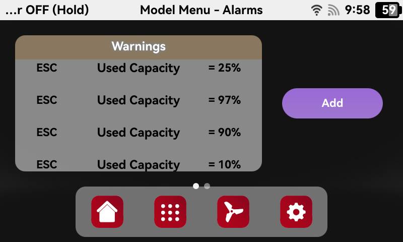

For the actual flying helicopter models, I set up capacity consumption warnings similarly to how VBC does it. However, instead of using 10% increments like VBC does, I personalized the warnings in a way that works better for me. I set up the warnings to 90% remaining, 75% remaining, 50%, 25%, 10%, 3%, and 0% remaining. I prefer this warning method better than VBC because I get fewer warnings (7 warnings instead of 10), and I get the 3% remaining capacity warning which is my cue to do an auto-rotation at end the flight. (see attached picture).
