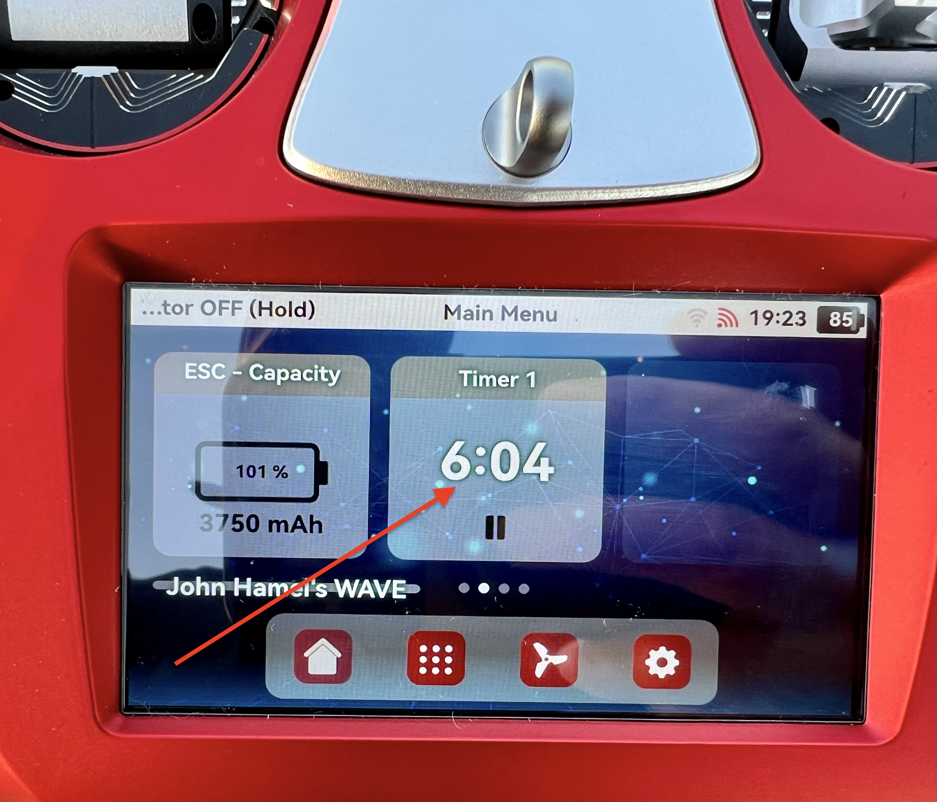

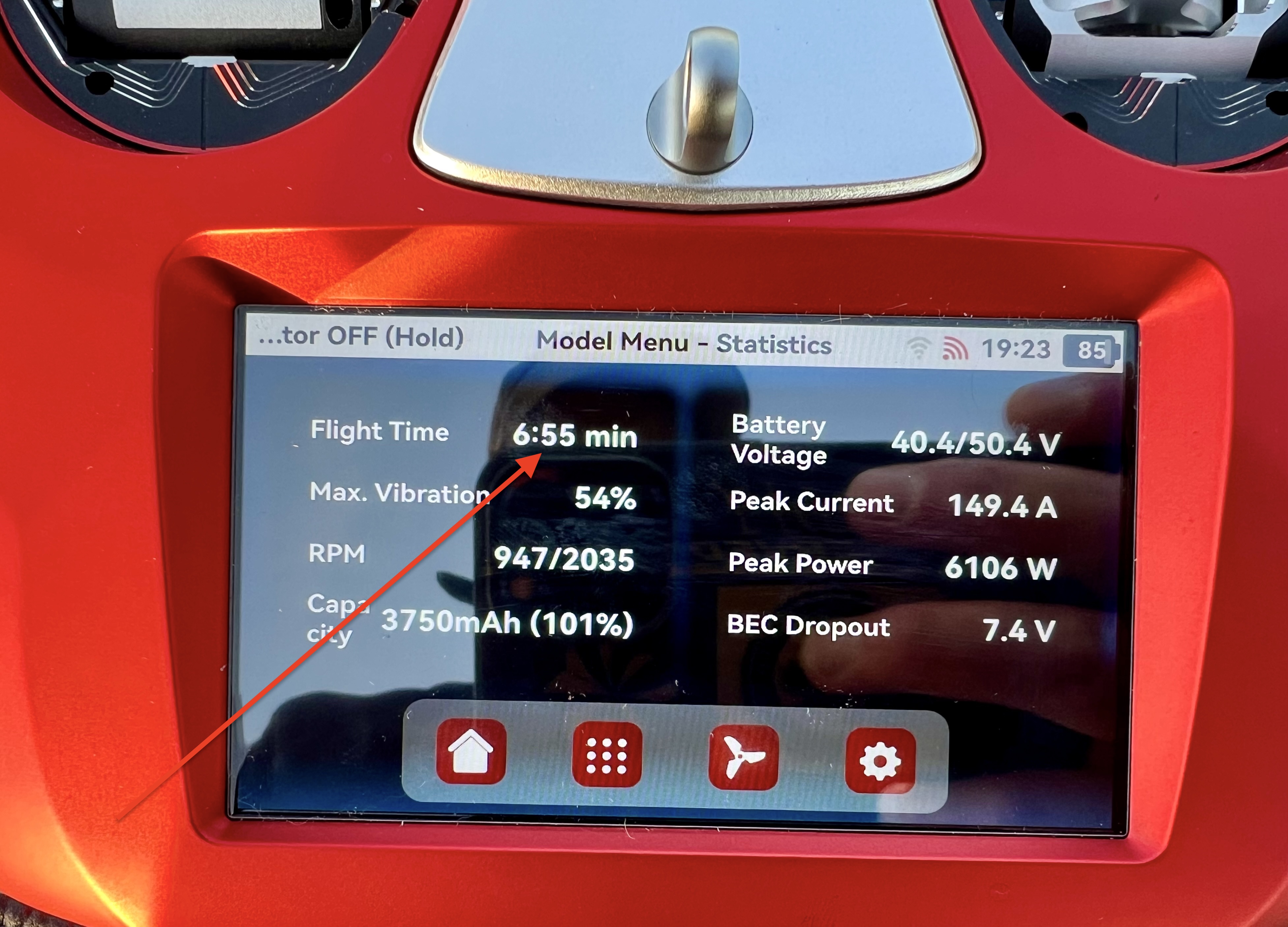

I do not quite know how to set up the timers appropriately. The widget timer (shows 6:04 min in pic below) runs even when I am doing autorotations (throttle 20%, motor off). Then there is the statistics timer (same flight, reads 6:55 min in pic below); I have no ideal how the statistics is determining the timer. I really would like to learn my flight times only when the motor is running, similarly to VBar Control. I do not want the timer to run when I am doing autorotations.

Flight Time stats are measuring time when Throttle Hold is disengaged. Timer is counting when Throttle is > 0%. So it depends just on your Throttle configuration.

Thank you for responding. Is there a way to set the timer so the timer will ONLY count when the throttle is >40%?
