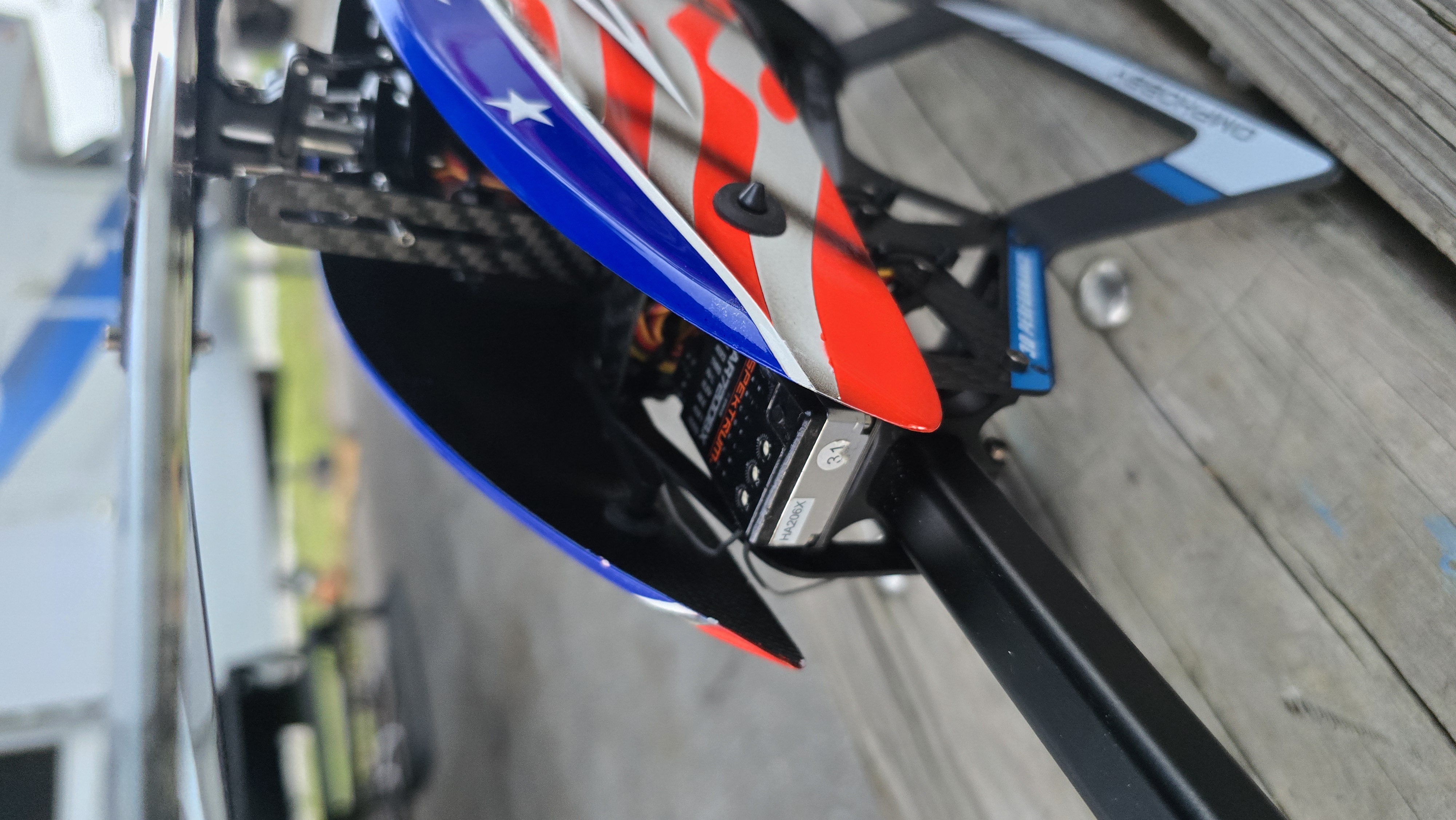

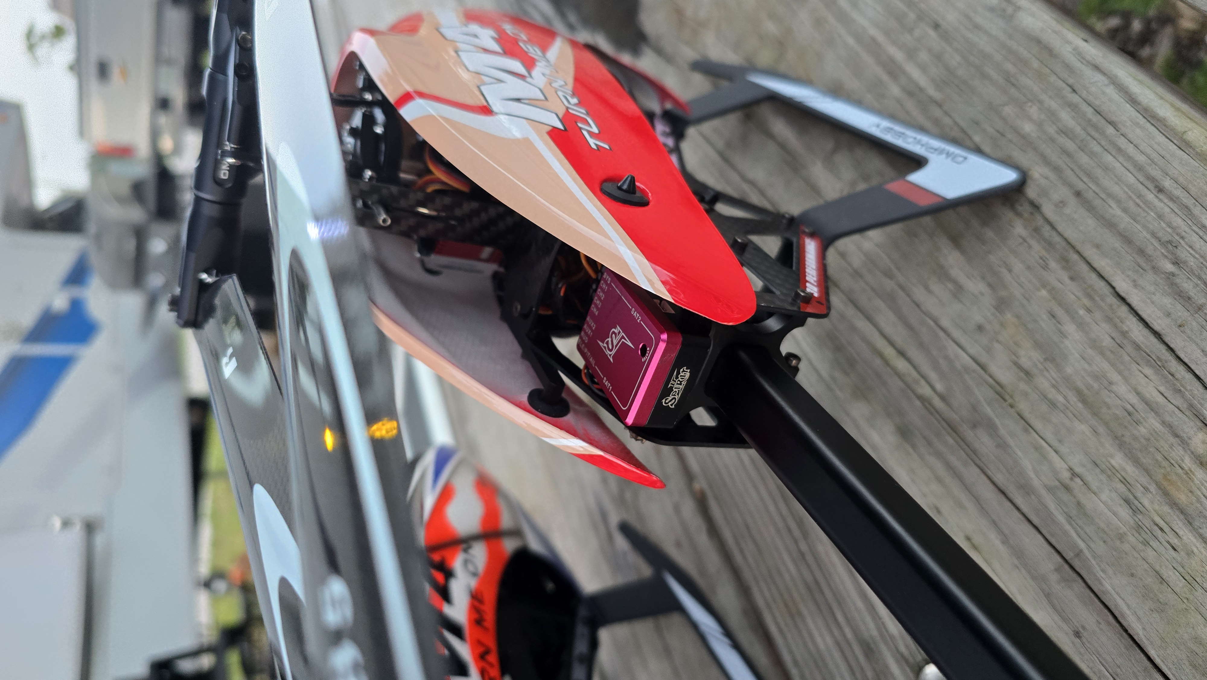

Hello all,
I had been flying an M4 Spirit combo for over a year without issue. After a bad crash and rebuild, I had a mild tail wag. I found some mechanical issues on my part that exacerbated the issue. After issues corrected, I still can see a mild wag. It is present at as little as 5% gain. The oscillation's increase as the gain increases (30-50+). This is consistent at all of me head speeds from 11000-16000. I replaced every part on the M4 to no avail. I actually purchased a second M4 with 100% all new parts to include ESC and the issue was present on the new one as well. I installed and old AR7200BX in place of the Spirit and the tail was locked. Both Spirit units provide a locked in tail when Installed on my Nimbus 5000. So, the issue only manifests when a Spirit unit is married to an M4. It is gentle, but obvious to me. I would appreciate any help as this issue has cost me a great deal of time and money. I did try playing with the dampening values. This may have helped slightly, but not by much.
Latest firmware installed.
Thanks,
Tony

please make sure the Spirit unit is mounted at the hard mounting pad. The pad has to be different from AR7200BX because it has different weight.
Your settings is looking good. From your description I would think there is something in the tail to not move freely (any additional friction makes the tail wag more apparent).
However since it works with other unit it could be because of damage of the Spirit or your AR7200BX is configured to work even with this friction.
Possible damage to Spirit unit is loose PCB which could happen if 4 screws at the bottom are not tight. You can gently try to tight them.
If it is caused really by mechanical issue Spirit can be configured to make it work too by decreasing Pirouette Consistency as low as possible. Then increasing Revomix will make the tail to work. But this solution is not good. Servo will be under high load all the time, possible with not ideal performance.
I hope something from this will help you.

Thank you for the reply. The issue is the same with two separate Spirit GT's on two separate M4's. So, that basically removes damage of the Spirit unit from the equation. Both M4's behave identically in tail behavior with both Spirit units.
I have tried the settings you mentioned, but will try again. Best results were setting Rudder Delay to zero and moving ball to inward position on pitch slider. I am not a fan of the M4 V1 tail section. I have them as free as is possible. And yes, AR7200bx does not have issue locking tail on M4. I will try to post a video of this subtle tail anomaly. I would swear I did not have the issue the whole previous year that I flew this combo. Maybe I did and did not pick it up.
I have had good results with standard 3M tape with these units in the past. But I will indeed order the correct pads as suggested.
FYI both Spirit units lock tail in on the larger Nimbus 5000.
Thank you again
