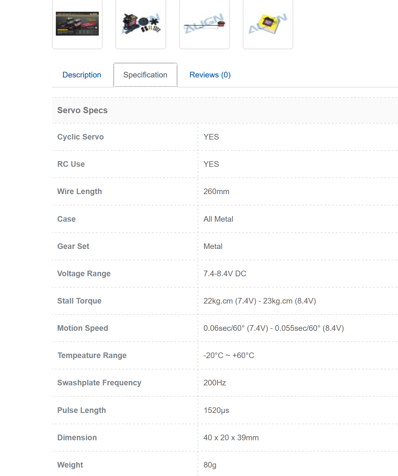

Posts: 643
Hello David,
I only find some specifications on the aligntrexshop.com -
I think the way to go is 200 Hz, no information about if 300 Hz is possible...
There you have no risk of overheating the servo then -
Best regards
Matthias
