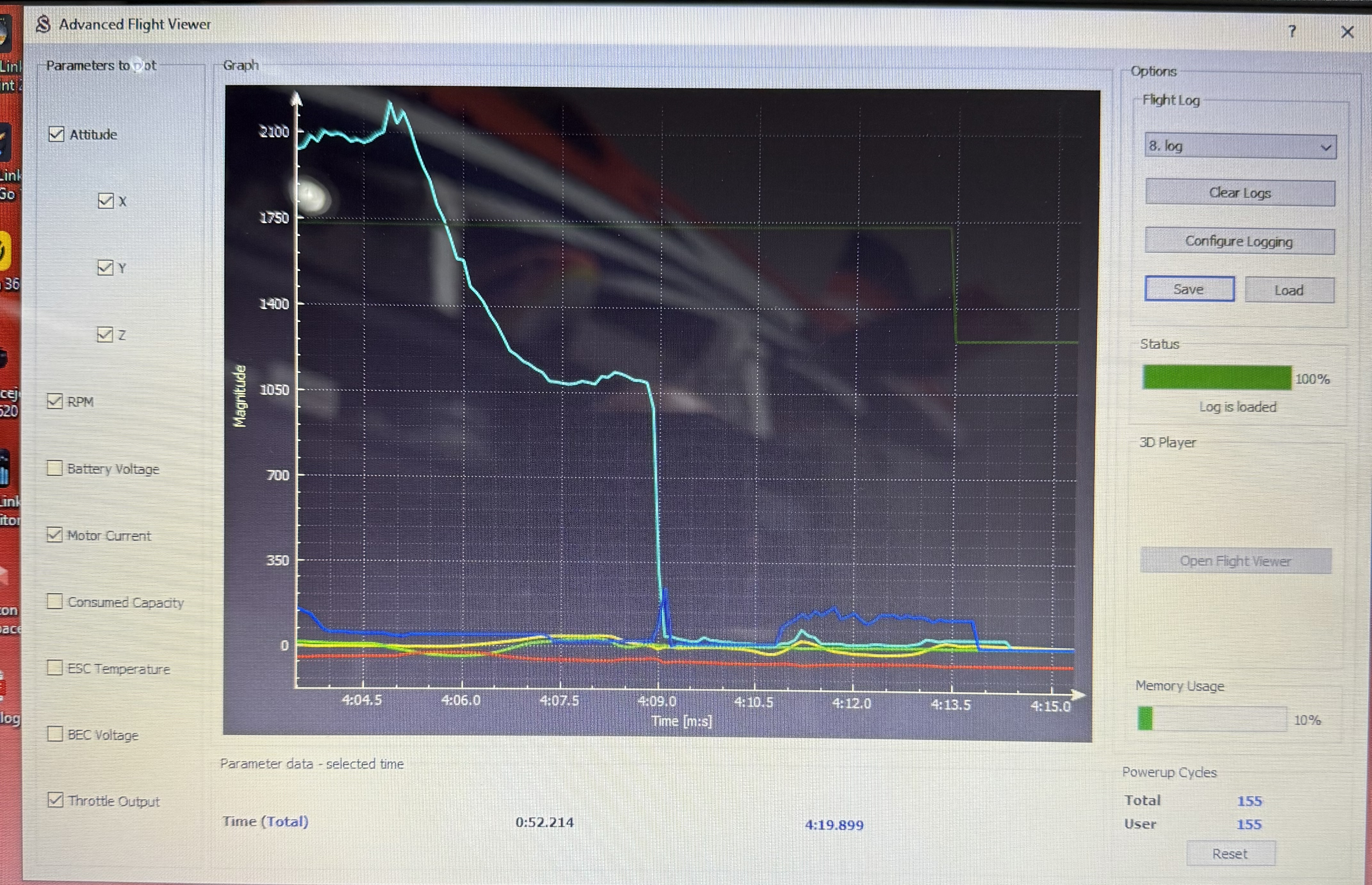

I experienced an unexpected big head speed drop while flying my TB70. It is using the Spirit GT Governor in an Align RCE-BL130A (which is a HobbyWing Platinum HV 130A V4).
Attached is a log chart in the V4.0 Flight Viewer that shows the RPM and Throttle Output. Before the head speed drop, there is a glitch that reaches a very low throttle output. Another smaller glitch is seen too.
The Throttle Output variations seen after the head speed drop were flight mode changes to land the heli.
In addition, there is no variation in the Throttle Output signal to keep the headspeed at the set value.
I’ve attached the Governor Settings.
Please advise.

Posts: 12988
it seems that this drop caused Governor to disengage, so it was basically off. Question is why such drop happened?
It could happen because of - problems with receiver signal (can be visible also at other axes) or problem with throttle hold switch.
It is unusual that these drops are happening.

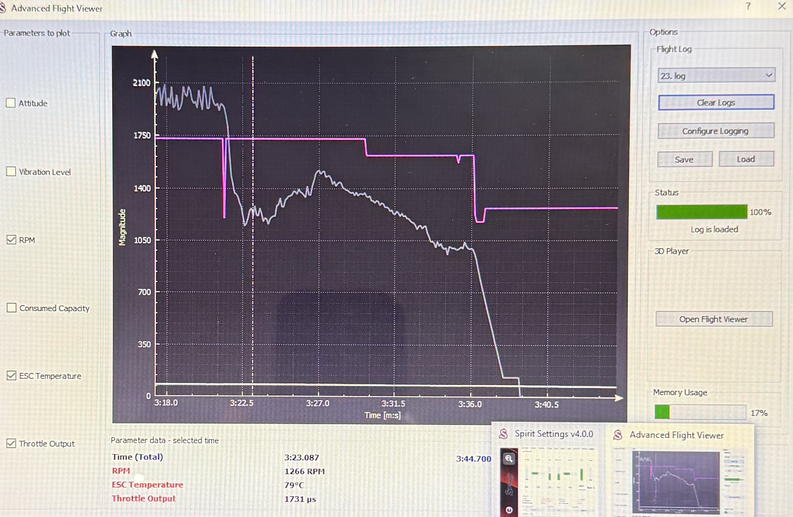

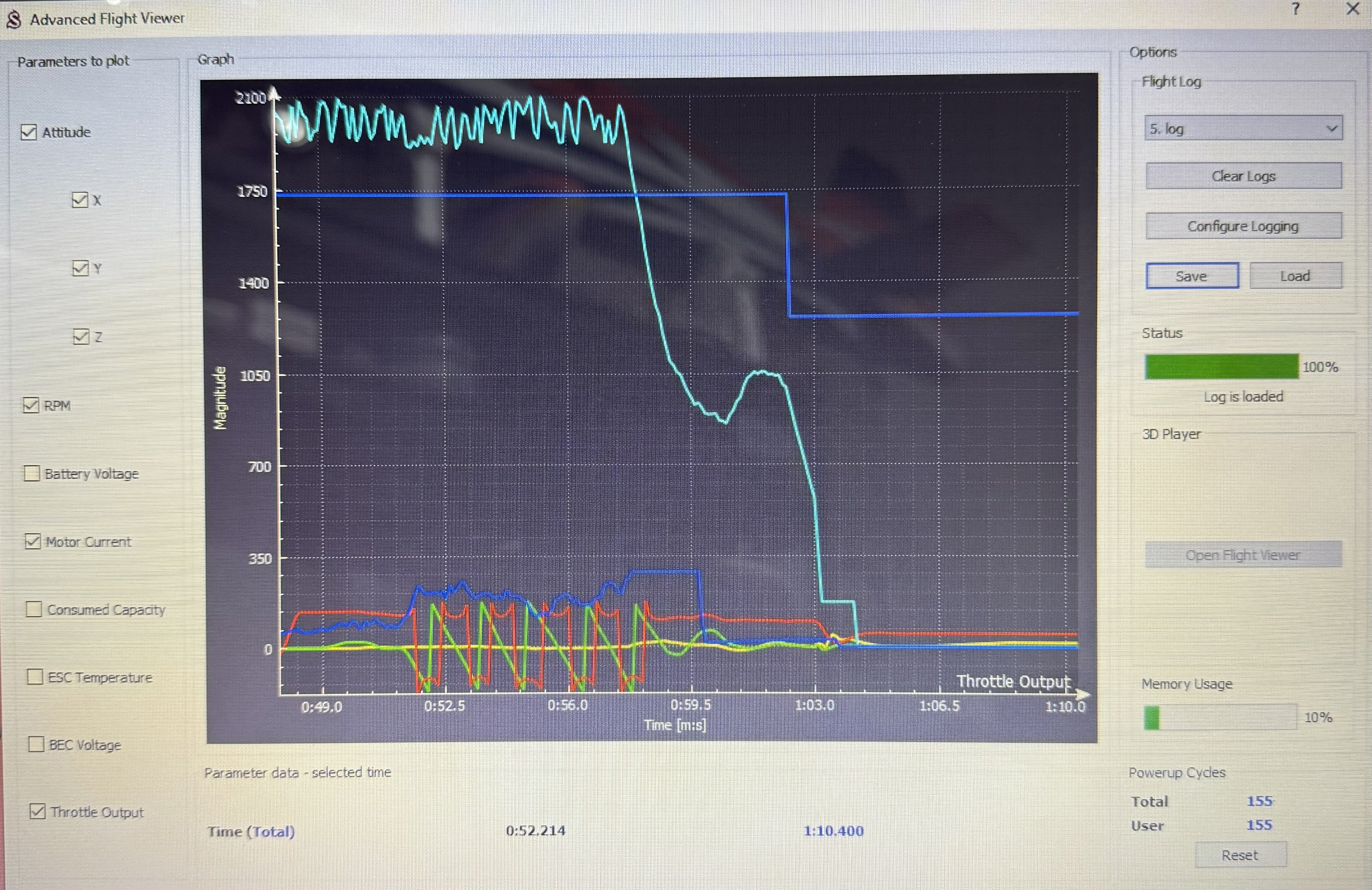

This issue has become real bad.
It has happened in every flight for a total of three times.
The two new graphs show exactly the same behavior although no drops are seen (one of the pictures has the Throttle Out plot green faint).
Could be the drops weren’t detected?
This model has extreme vibrations that can’t be improved as they are inherent to the model frame structure.
The model flies fine and the rescue works well.
I’ll appreciate your help on this as this has become a critical issue that produce an unexpected power loss that has damaged blades and pose a crash hazard.
In addition, why the Throttle Out signal isn’t varying to regulate the headspeed?

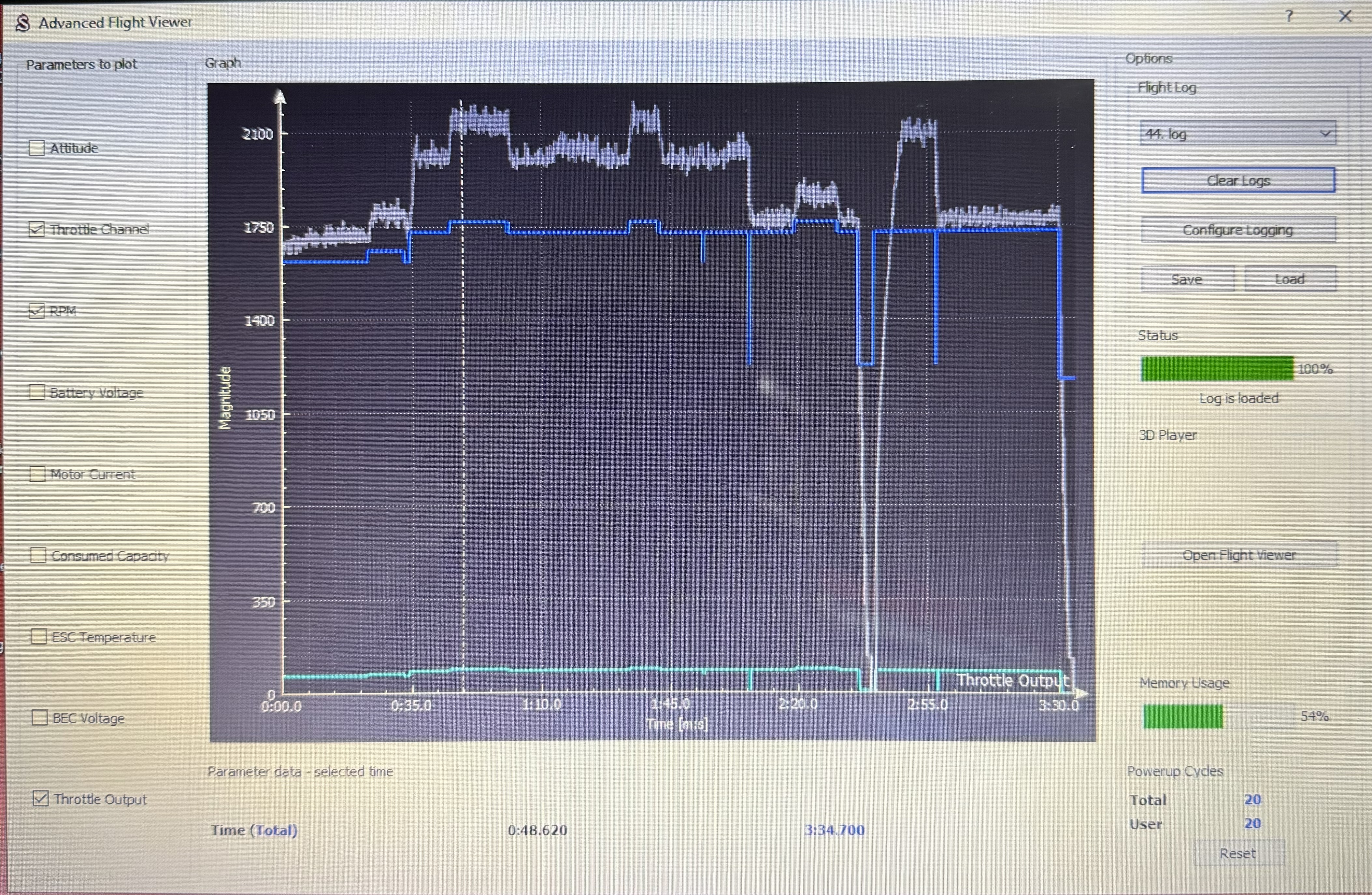

davehour
Posts: 145
I’m wondering why the Throttle Out signal of the Spirit GT isn’t varying to control the head speed variations.
It just rises to a value to reach the head speed and stay at that value although the head speed is varying. During the flight, the head speed varies and over speeds when descending the heli.

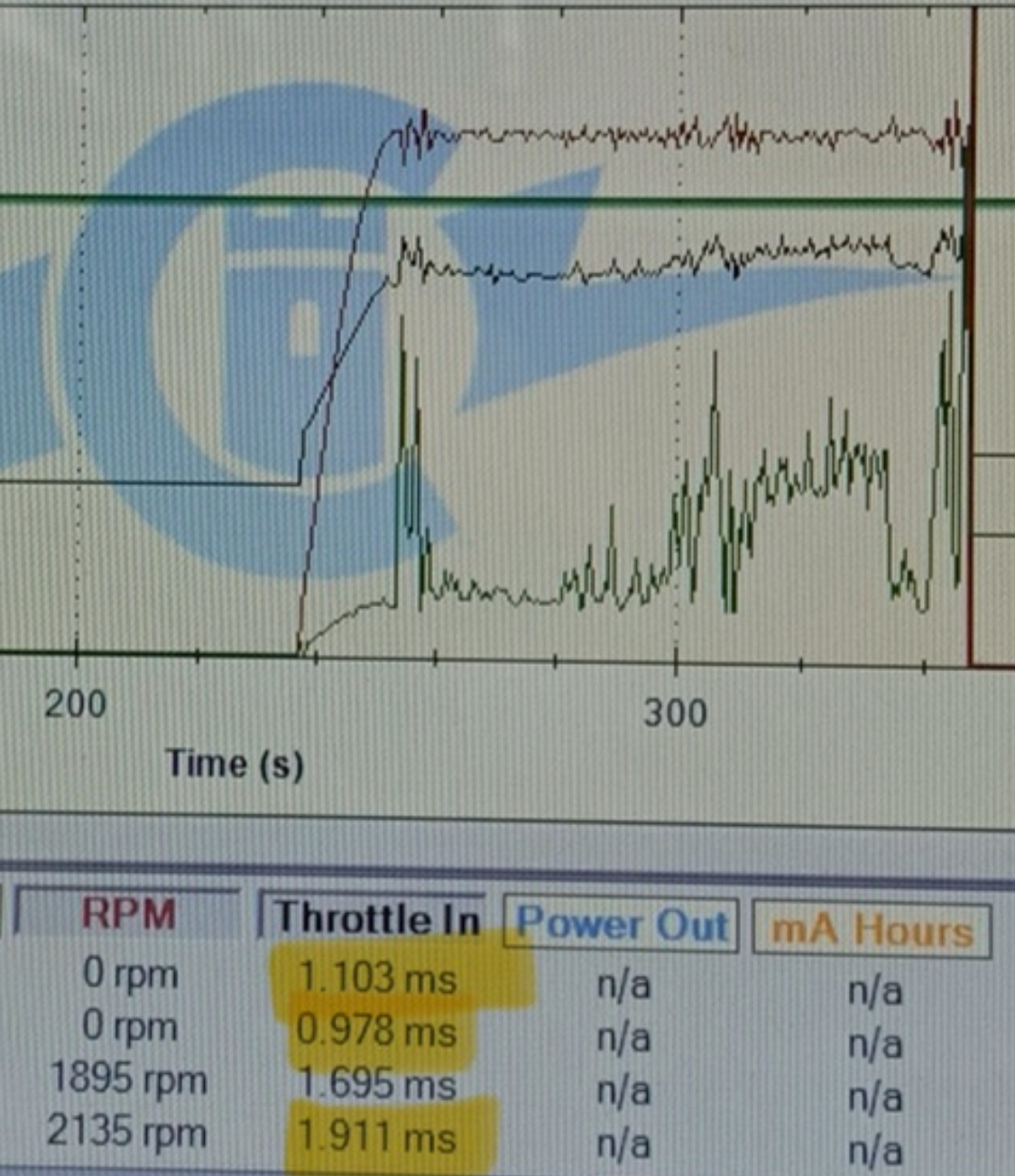

In contrast, I’ve attached a chart of my Trex700E with a Castle ESC and Spirit Pro. You can see the Throttle In signal in the Castle chart, which is the Throttle Out signal of the Spirit Pro, is always varying to maintain the head speed at the set value.
Both Spirit units have the same Governor Settings because head speeds and ratios of the helis are similar.

Posts: 12988
thank you for your details.
After verification we found out that in some cases Throttle Output is actually identical to Throttle Channel.
If you wish I can share upcoming firmware with you with the fix included.
