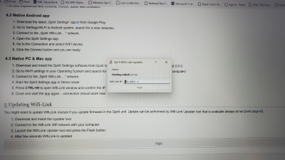

I have 2 WiFi Links modules on 2 seperate Spirit GT units.
I downloaded the latest FBL update, Software update and Wifi Link update (4.0.0)
The FBL units and software all updated fine.

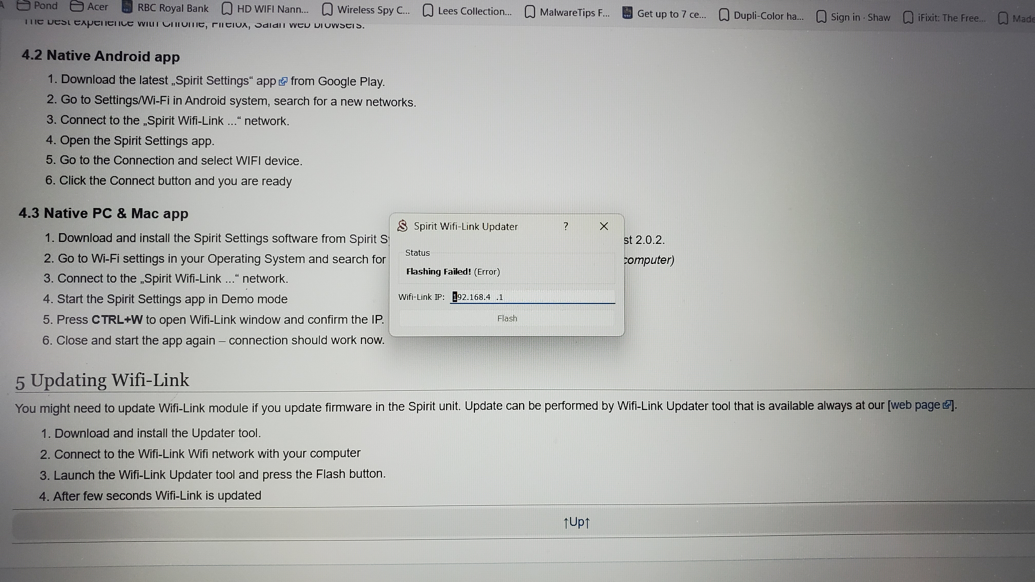

When I power on the FBL and connect my computer to the Spirit WiFi Link. Then start the Spirit WiFi Link updater tool and push flash it cycles throught the process of flashing the module. When it is at the stage of rebooting it says it failed.
I have tried re downloading the update but get the same result on both units.
What am I missing? Never had an issue updating the WiFI Link before.

I re downloaded the update making sure it was 4.0.0r3.
Still ends with reboot failed.

This is strange
So I tried again.
Deleted the original download.
Re-dowloaded the wifi update 4.0.0r3.
Installed it
Tried to update the wifi link and got the same message, failed.
Just for sh*t's and giggles I tried to connect my PC to the WiFi link and it connected. Opened up the software and it is connected.
Open up the settings app on my android and it is connected too.
I am getting a failed message but it seems to have updated, I think
