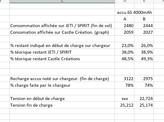

I've been having a problem displaying consumption since updating to the new version. The values ​​indicated by JETI/SPIRIT are very different from those indicated by Castle Creations, and also very different from reality.
Do you have any information on this?
Thank you for your answers.
I've attached the values.

There is still this problem of incorrect fuel consumption readings.
Posts: 13038
unfortunately there is nothing we can do about this.
Current is measured by ESC which could be very imprecise at some situations. Especially when ESC load is too low, it will return 0 instead of real measurement. This can happen more often in situation when ESC rating is much higher than real load, because sensor is blind for low currents.
If you need more precise measurement we recommend to get ESC with more precise circuits.

Ok merci, pourtant ça fonctionnait tres bien avant, je n'ai rien changé à part la nouvelle version.
Je vais me passer de cette fonction qui était bien utile.
bonne journée.
Ok thanks, yet it worked very well before, I haven't changed anything except the new version.
I will do without this function which was very useful.
Have a good day.

@ZeXx86 Est-ce que c'est possible de revenir en arrière pour remettre une version qui fonctionnait parfaitement, je risque a chaque vol de casser mon matériel si je n'ai pas la consommation exacte.
Is it possible to go back to put back a version that worked perfectly, I risk breaking my equipment with each flight if I don"t have the exact consumption. ?
Posts: 13038
You can return to previous firmwares in 30 seconds anytime.
But nothing changed from previous firmwares. Measurement is 100% identical (or at least should be).

First, I updated JETI, SPIRIT, and CC. I'm going to fly short distances again and measure the power consumption. I have five machines and haven't changed anything; there's no reason why it shouldn't work anymore—it's too useful and safe.
