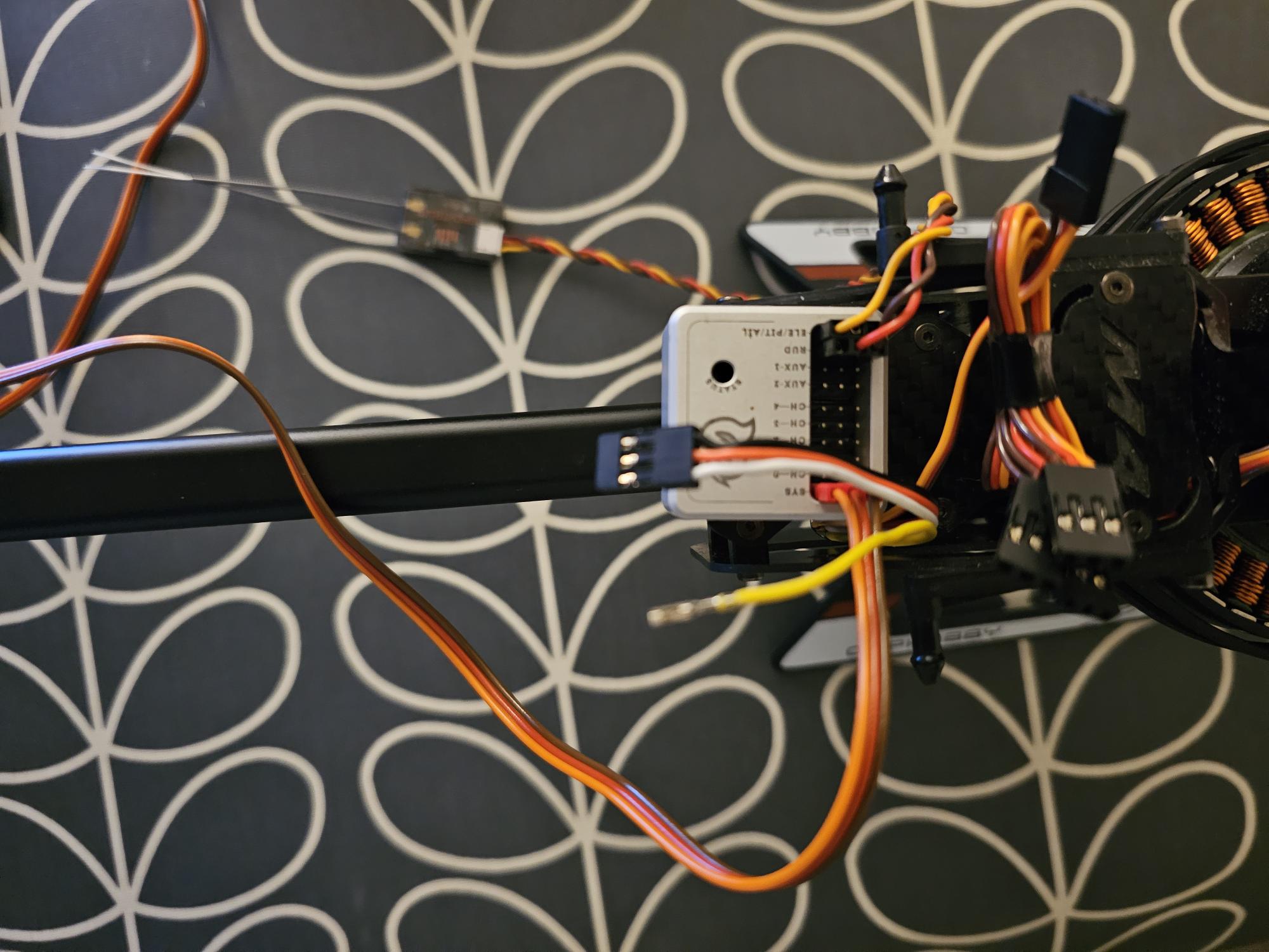

Folks,
Where am I going wrong here ?
Recently acquired second hand M4, cannot figure out why the Laptop will not see the Spirit Pro.
Esc plugged into AUX1 gives no response
Esc plugged into AUX2 gives steady beeping from ESC.
No servos connected, however when I plug in the batt via the esc and start the Spirit software it just keeps spinning not seeing the Pro.
What ports on the spirit should I be using for the SRXL, esc and spirit usb to laptop cable or does it even work with this configuration ?
thanks in advance,
Paul

Thank you, yes I believe I have followed the instructions correctly however I cannot get success in comms with the software.
Posts: 1053
In the photo I see the unit turned off. It does not light up. You need to connect the power supply, ideally to AUX1 or AUX2, let the unit initialize (steady LED lighting) and then run the SW. Reinstall the SW and install the USB drivers.

Perhaps because I haven't reinstalled the software after initialising is where I am going wrong.
Yes as per my message I have tried both Aux1 & 2 but will re install and see if that works.

Problem solved....I had bluetooth enabled on my laptop, as soon as I turned off it all worked perfectly.
Thank you for the help,
