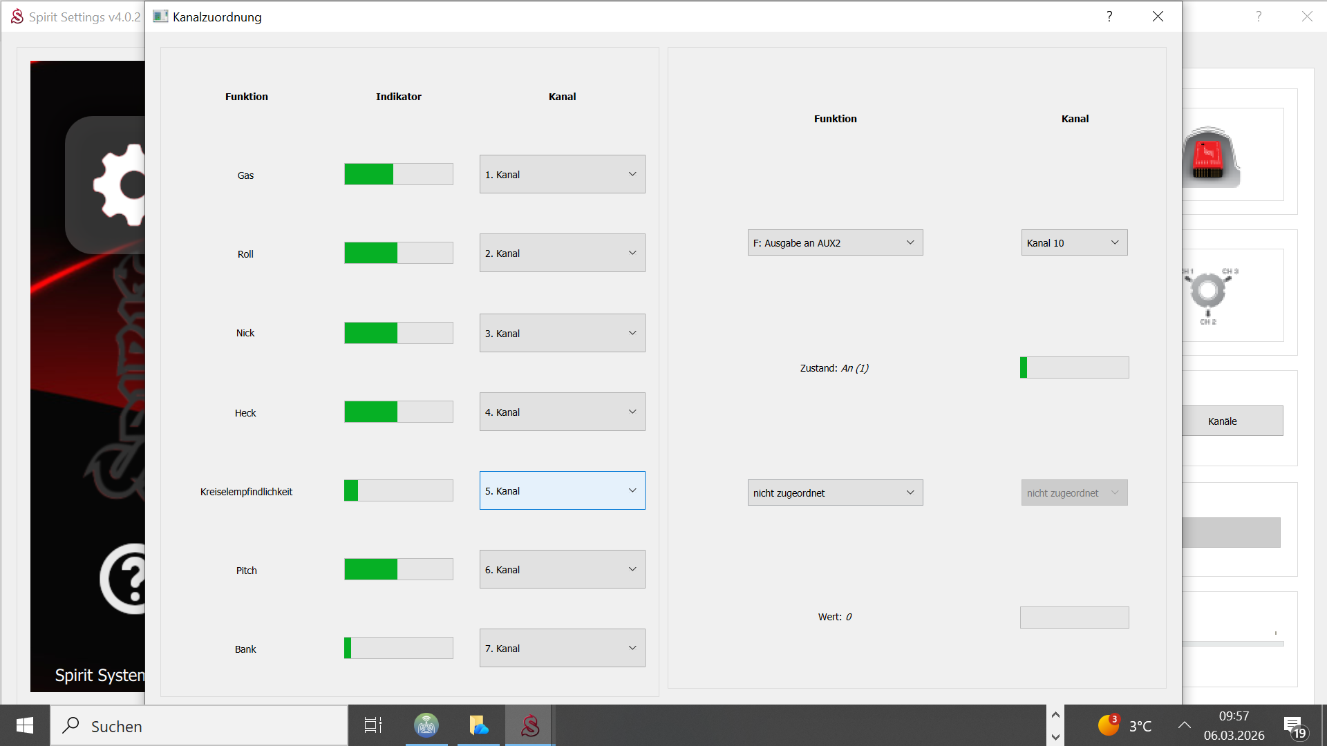

I am using EdgeTX 2.11.3 and ExpressLRS 3.6.3 on my Radiomaster TX16S. I have connected an ELRS receiver to the Spirit 3FBL unit, followed the configuration menus (Spirit Configurator 4.0.2) step by step, everything works, including channel assignment and telemetry discovery. I accordance to the channel assignemnt, I have A,E,T,R setting (mixer output) on the TX16S, it a setting by native. I can see in the Spirit Configurator detects the channel on the channel assignement menue Function/ Indicator (enclosed picture) in the right way. But the channel assigment (Kanal, 1, 2, 3) it seams to be, is not in the order as delivered from the transmitter on the spirit side. With the current channel mapping (enclosed picture), everthing works perfect in the Spirit FBL. But for whatever reason expressLRS maps the channel 1 of my transmitter to channel 2, channel 2 to channel 3, and channel 3 to channel 1 on the spirit side, so the channel 1, 2, 3 are reassigned on the way from the transmitter to the Spirit System, what can be the problem ?
I copied the TX16S Lua script folder (from the Spirit download page, latest version) to the highest entry point of the SD card of my transmitter, opened the TX16S Spirit folder via the Sys Button on my transmitter, executed the Spirit basic Lua menu, the menu (1-7) appears, but the data fields remain empty. I currently don't know what the problem is. Are there any e.g. specific packet rates in the ExpressLRS settings required or mandatory for the Spirit System or what can I do/ check to get it functioning ?

when using ELRS then Lua script for OpenTX are not used. You have to use ELRS configuration menu, same as for receiver and ELRS module.
Please see this page:
https://manual.spirit-system.com/index. ... sFire_CRSF
