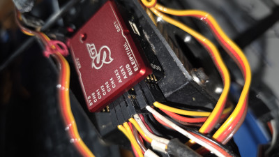

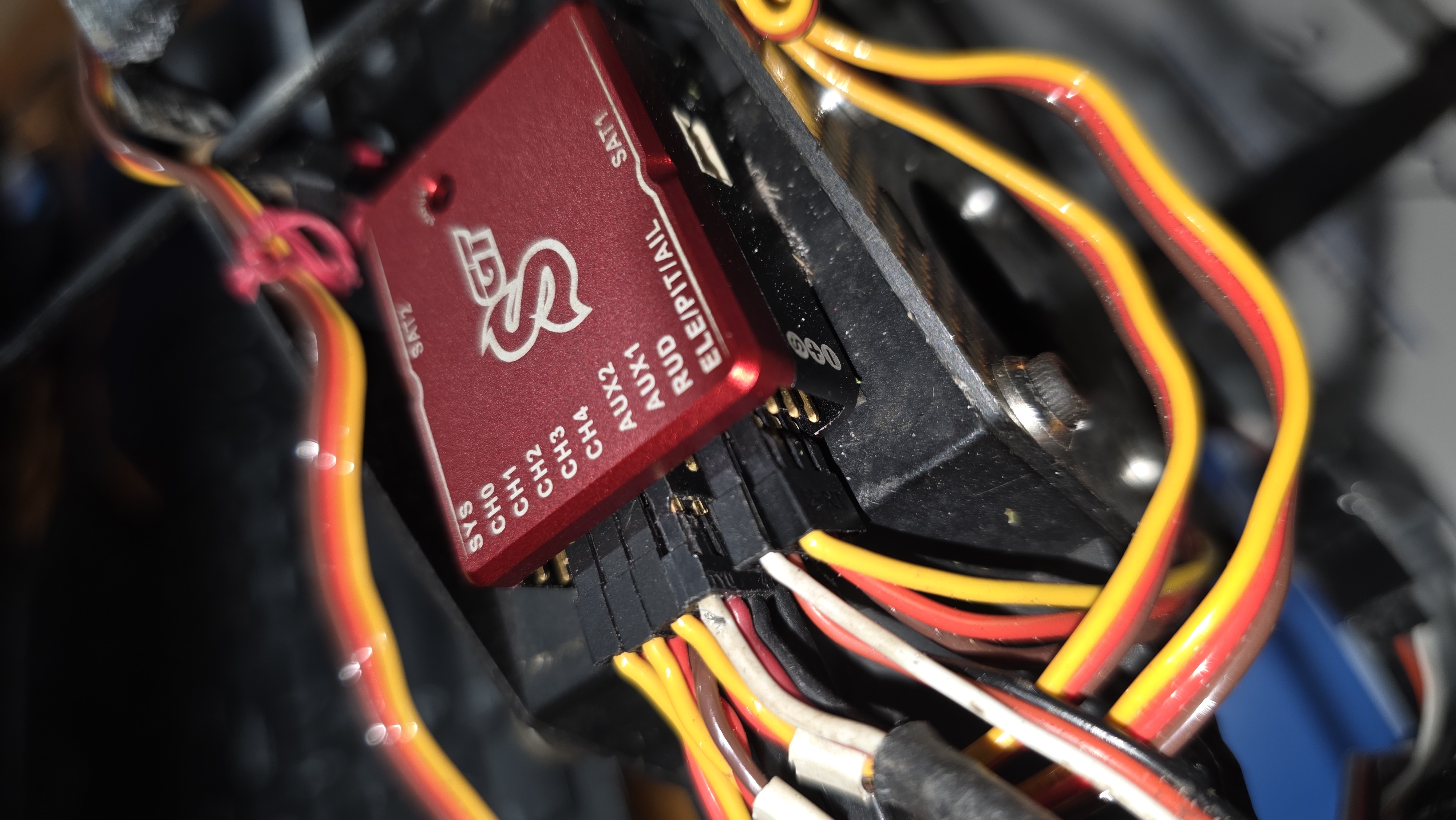

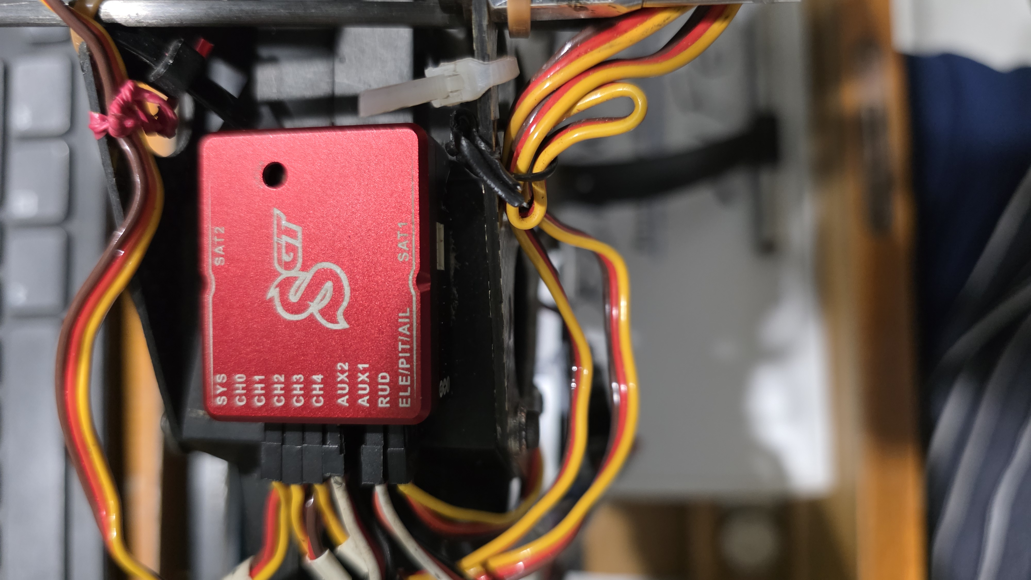

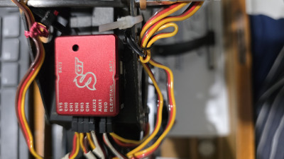

Hello, thanks for your quick reply, my BEC is plugged into Aux 1 ( BEC/ESC) as shown in the setup wizzard (step 1/10).
My Frsky reciever single line is plugged into RUD (F.Port Rx )
Both the Geilink and Spirit GT was bought new.
Wiring Detail-  ESC white, red, black
Wiring - Rx  yellow,, red, brown

Thank you for your photos.
First thing I saw is your setup has probably only one powering ESC/BEC cable. Very likely it is not source of GeoLink connection problem.
This is not enough/recommended for the most helicopters starting from class 500+, especially not with todays servos.
Second important thing is that your rudder servo has damaged wire. This could cause random shorts and failure mid air.
I can't see a telemetry cable, but also not a GeoLink wiring. For example by using custom made GeoLink cable these problems could happen. Connection has to be really good and cable not too long.
Was there any telemetry cable connected previously? If yes, I recommend to measure voltage at a side satellite port to make sure it is giving 3.3V.
Also what PC software/firmware is installed in the computer/unit?
