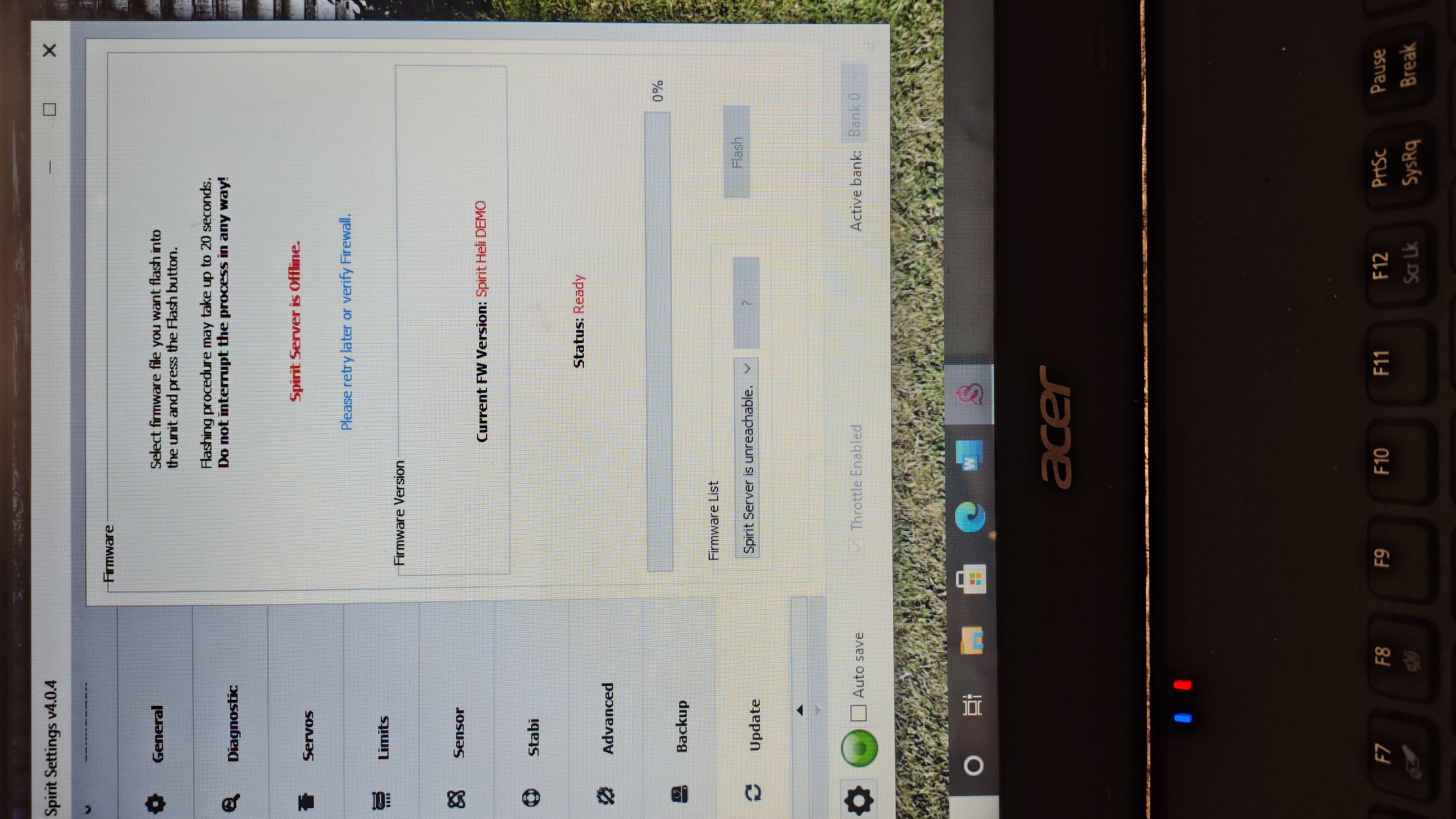

I keep getting spirit server offline. Is this me or the server?
Never had a problem before??
Spirit server offline

Was working fine. Switched all my firewalls off, hot spotted to a mobile, added Spirit Settings as an allowed app to pass through the firewall.
Windows 10 so no recent security updates and it's rarely connected to the internet.
Anyone has a tip, please let me know.
Thanks.
FYI. I was on spirit2 firmware V3.7 and it wouldn't let me check any settings unless I did a firmware update to V4. I had to install V3.7 to set up a new collective servo.
Thanks.
thank you for the details.
Could you please try to install this PC software?
https://www.spirit-system.com/dl/settin ... r4-win.exe
I hope this can help you.
Hi.
That has worked, what is different?
Was about to reply that I hot spotted off 2 different mobiles (same network) and it wouldn't connect.
Just been to my lad's house (before I loaded the software you linked to) and connected to his home internet with an ethernet and wifi connection and it worked!
Thanks, Ian.
Thanks, Ian.
