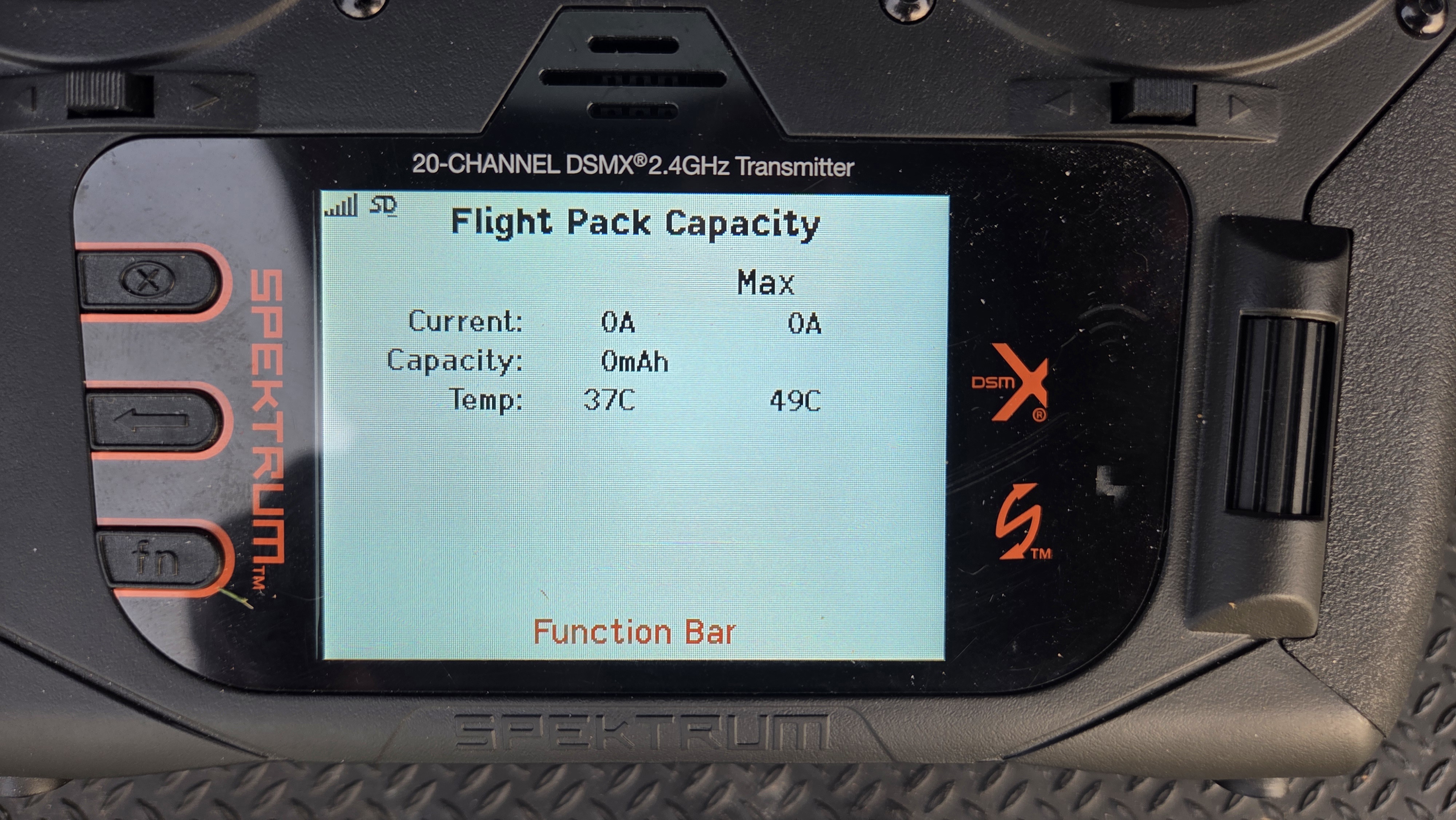

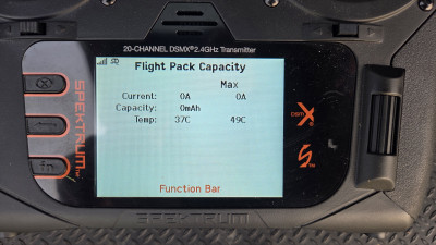

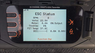

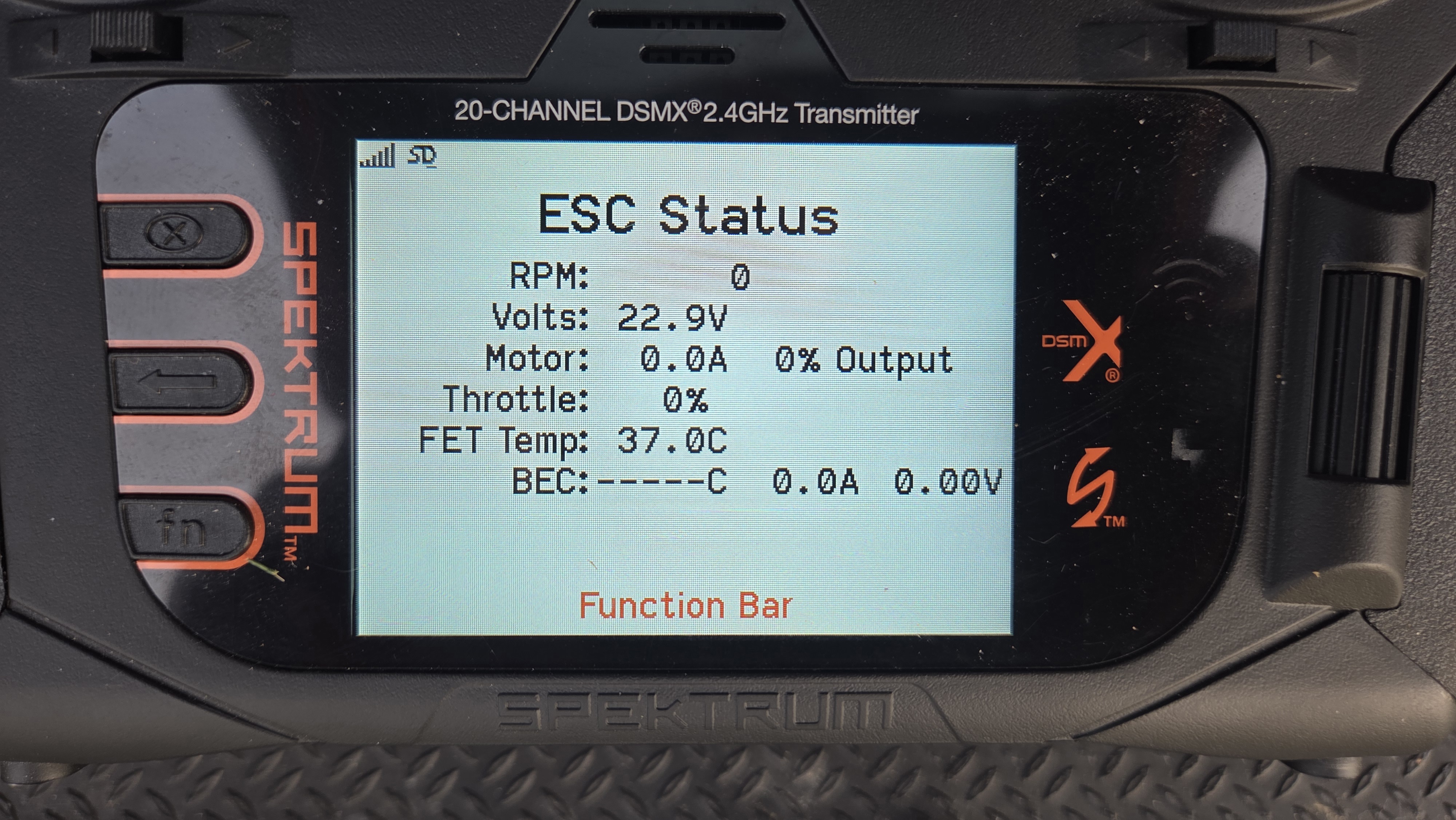

On my Spektrum NX10+ I am looking at the two telemetry screens "ESC Status" and "Flight Pack Capacity" as shown in the screenshots.
In ESC Status I see ESC Voltage, RPM, FET Temp and Vibration Level (% Output). But the value for current (A) stays always at "0". Even under load during flight.
In Flight Pack Capacity I see the FET Temp with correct values but the values for current and mAh there stay always at "0" as well.
On which other screen should the value for the OMP M4 65 current be displayed?

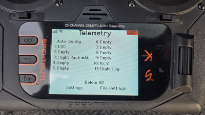

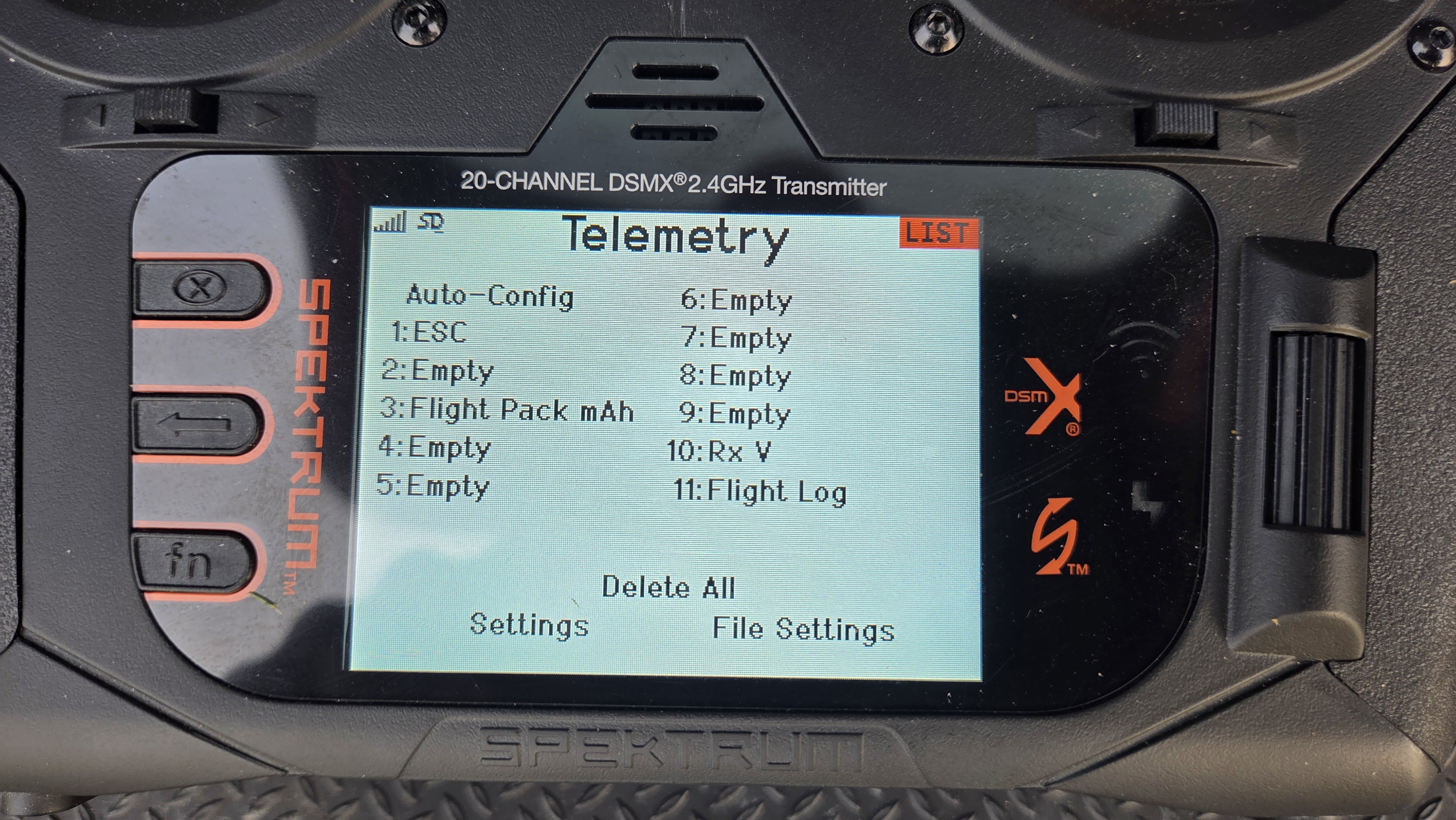

I tried both in my NX10+ but the displayed screens stay the same: "ESC status" and "Flight Pack mAh":
  • The manual configuration according to your documentation for Spektrum integration (Screen 1 = "ESC" and Screen 3 = "Flight Pack mAh".)
  • The Auto-Config that results in (Screen 1 = "Smart ESC", Screen 2 = "Smart Battery" and Screen 3 = "Flight Pack mAh")
In the Spirit PC software the displayed values were the same: RPM, Voltage, FET Temp and Current always at 0.

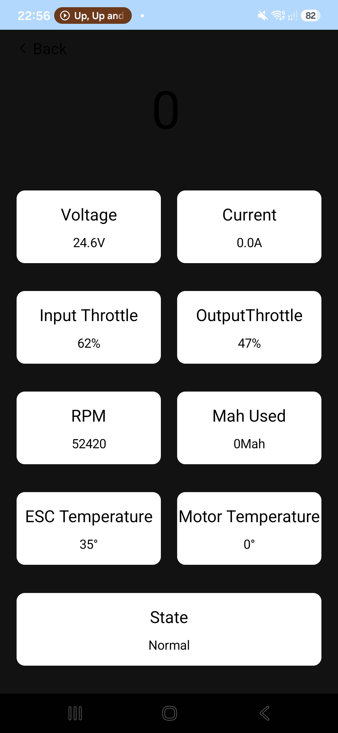

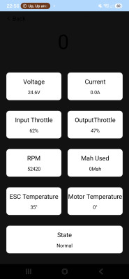

I have rechecked: In Spirit PC Software the value for current is always 0 as well.
Then I checked the value for current directly in the ESC by connecting the OMP app via the bluetooth module: Even there the value for current is 0.
This may indicate that the sensor within the ESC is broken. But this could be caused by the fact that this test was on the bench without load (all blades removed for safety).
Does anyone know if there would be a small peak in current when starting the motor without blades?
