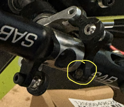

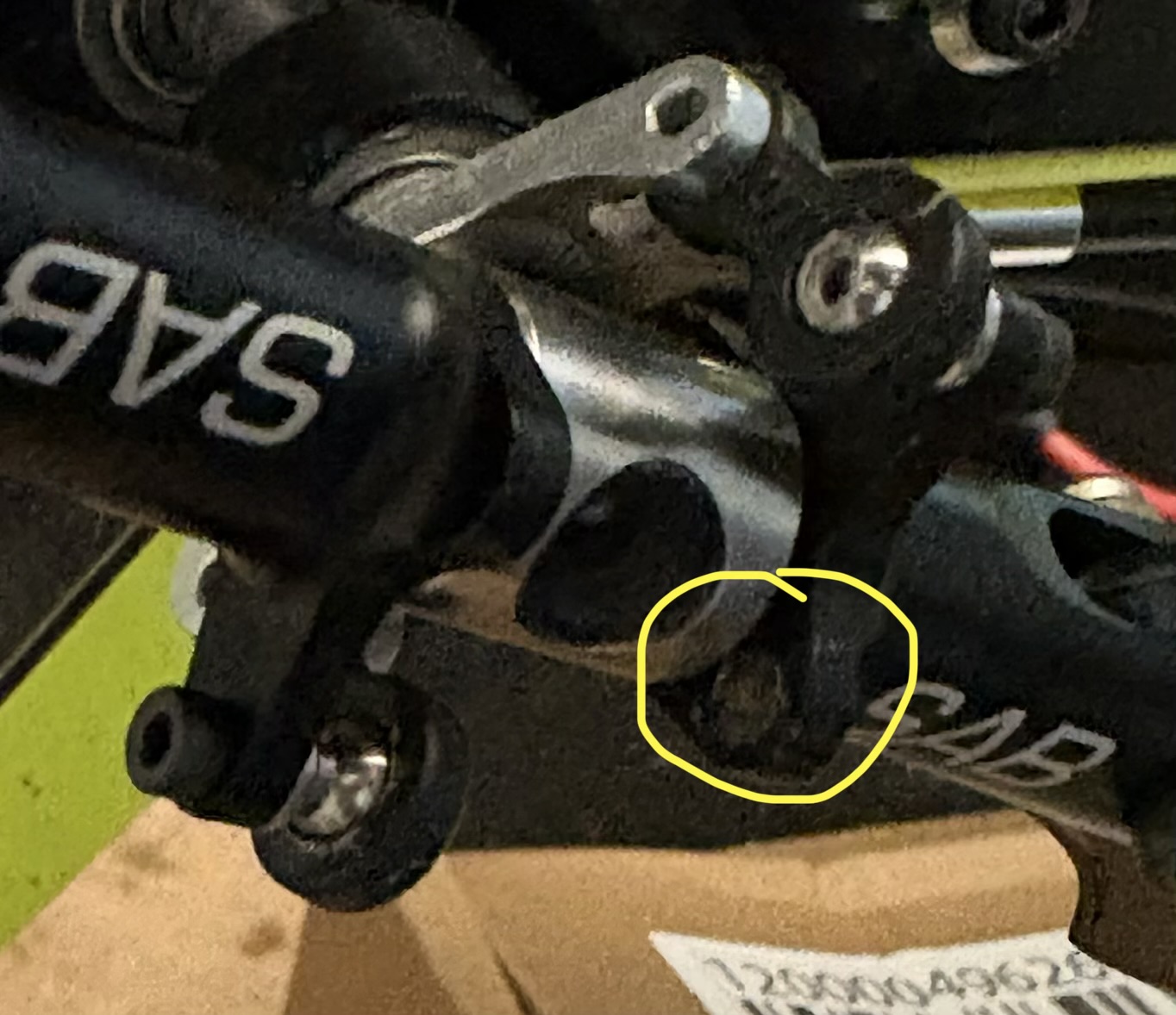

I have the same heli and "had" the same issue as yours - bad tail vibrations. I ultimately had to weigh every nut, bolt changed every bearing, shaft, tail blades ..... and found that the blade holders were not balanced (different weights) :shock: after balancing them, it's now OK. Also place the heli on some carpet during the tests and not on a hard floor.

senaka
Posts: 71
Location: The Netherlands
Hi manni
I removed some material from the heavier one equally on both sides as attached. Slowly drill it out. I tried slow curing epoxy drops as weights but that kept on falling off. I’m not sure if I did correct thing. Potentially now it’s dynamically off balance. But the vibes are lower
