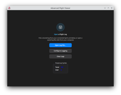

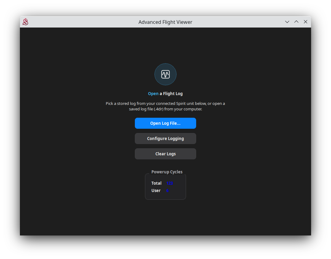

My problem is stated in the heading. Despite my best efforts, I am unable to record log files. The THR channel is assigned on the Spirit GTR. The Clear Logs button in the Spirit Setting software is not accessible, as there is no log file in the memory. See attached screenshot. The memory therefore appears to be empty. I suspect that an internal error is causing the memory to be marked as full due to an incomplete deletion process.
Everything works fine with another Spirit GTR with an identical configuration.
Do I need to send the Spirit in for repair, or is there any other way to resolve this?
Attached is the screenshot of what I see when I open the Advanced Flight Viewer.

Hello Tomas,
I’ve managed to solve the problem, but could you please take a few seconds to read my feedback:
The solution was a bit tricky. The problem was that I couldn’t access the ‘Clear Logs’ button without a .4dr file and I didn’t have one. I generated a .4dr file using another helicopter, saved it to my PC, and then opened it on my PC whilst connected to the faulty Spirit unit. Memory Usage showed 0. I clicked ‘Clear Logs’ again anyway. That solved the problem and I was able to record log files.
Two conclusions:
1) The ‘Clear Logs’ button should always be accessible even without a .4dr file, e.g. in ‘Configure Logging’.
2) Error in the display of "memory usage": after clicking ‘Clear Logs’, the memory usage bar does not change. Only when the window is closed and reopened does the memory usage display 0. This is confusing.

thank you for your feedback. We will sort this issue within following days so the Clear log button is always accessible.
We added the button to be visible whenever Memory Usage is non zero. It will be available shortly with new software.
