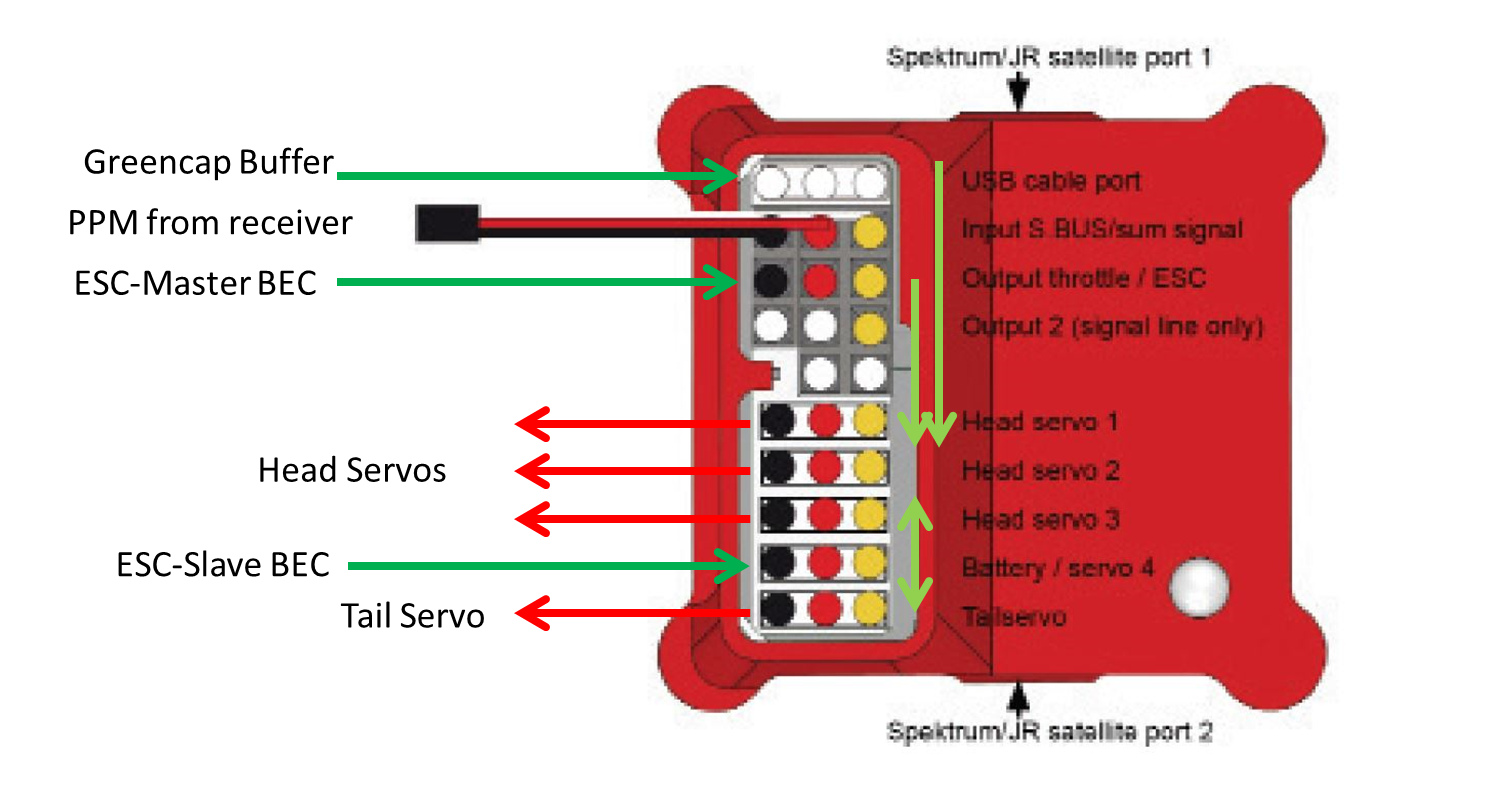

I made some graphics:
HC3SX / BD3SX:
The HC3SX has three (!!!) direct Ports where power can be fed in (green arrows).
- the USB Port (thats allowed) => Greencap Buffer
- the output port for the ESC signal => Jive/Kosmik Master cable
- Battery port => Jive/Kosmik Slave cable
Apart from that, the three ports have different places, so the current flow is divided into two halves. One part of the current comes from the top of the unit and goes down to the servo ports and the other part comes from the bottom of the unit. So there is no place in the unit where the whole Servo current flows.
Spirit:
At the spirit System is only one direct port for power Supply and one indirect port for power Supply (over receiver PPM Cable) when PPM is used. If you use a Standard PWM Receiver then there is no port for direct power supply, then there are only two indirect ports.
The ESC Jive/Kosmik Master cable and the Greencap Buffer can't be directly connected to the Spirit. It is a pitty that it is not allowed to use the SYS Port for power supply.
Furthermore the two ports where power can be feed in are at the same place. So the whole current for all servos must pass one point. That means that the last servo (in this case the tail servo) gets the fewest power because of losses by Mr. Ohm.

Posts: 13033
Hi
Spirit is tested for many years right now and is operating very well in even 800 size helicopters without any issues.
I recommend to use PWM connection if you are worrying about power slots.
Spirit cables are capable of delivering 20A continuosly and 40A in peaks.
You can fly without any doubt (if receiver is not a cheap clone) with BEC leads connected "indirectly" to your receiver.
Whats more, connecting one power lead to receiver and one to the unit causes unbalanced loads in the cables.
In case of failure there are very same chances for succesfull landing.
UPDATE: For such short cables resistance losses are relatively very small. Its resistance could be gradually higher with higher temperatures. For the resistance difference, you have to reach temperatures mostly bigger than 200°C. So until your cables aren't so hot, your model is safe.

davehour
Posts: 145
ZeXx86 wrote:Hi
Tomás,
The cables that come with the Spirit are seem to be 24AWG. A foot of 24AWG has a resistance of 0.025 ohms. If such wire carries 20A of current continuously, the total power dissipation will be 10watts. At 10watts, the wire temperature will rise very much up to the point the insulation will melt, and the wire itself will be very hot! Moreover, the connectors used in the cables are rated for much less than 20A. So according the analysis, the cables won't be able to work at 20A.
I can understand the Spirit cables can withstand a current of 20A of short duration, but not continuous.
Please, correct me if I'm wrong, or if I'm missing something in my reasoning.
Thanks,
David
Posts: 13033
Hi
Our cables are tested for 20A continuously (1 piece for 10A) and 40A for 3s peaks. There are more types of cables so it is not so easy to determine which one can handle such current without actual tests.
With cheaper cables it caused abnormal heating. Main difference is in wire threads.
These tests were performed with special equipment directly for this kind of measurement.
