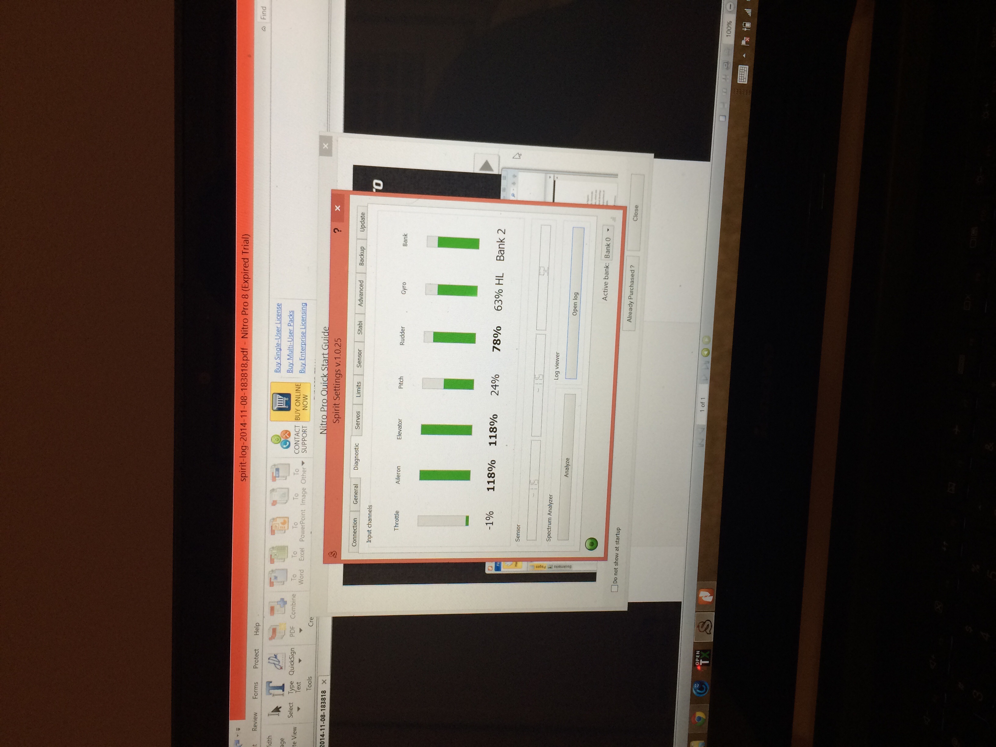

Ok,
I tested again and It did go crazy when I opened the log.
I took some pics of the diagnostic screen when the Tx is turned off and when it went crazy when I opened the log.
What is weird is if the heli is not connected to the computer the failsafe works perfect. I turn off the Tx and nothing changes, it keeps everything where I had it when the Tx went off.

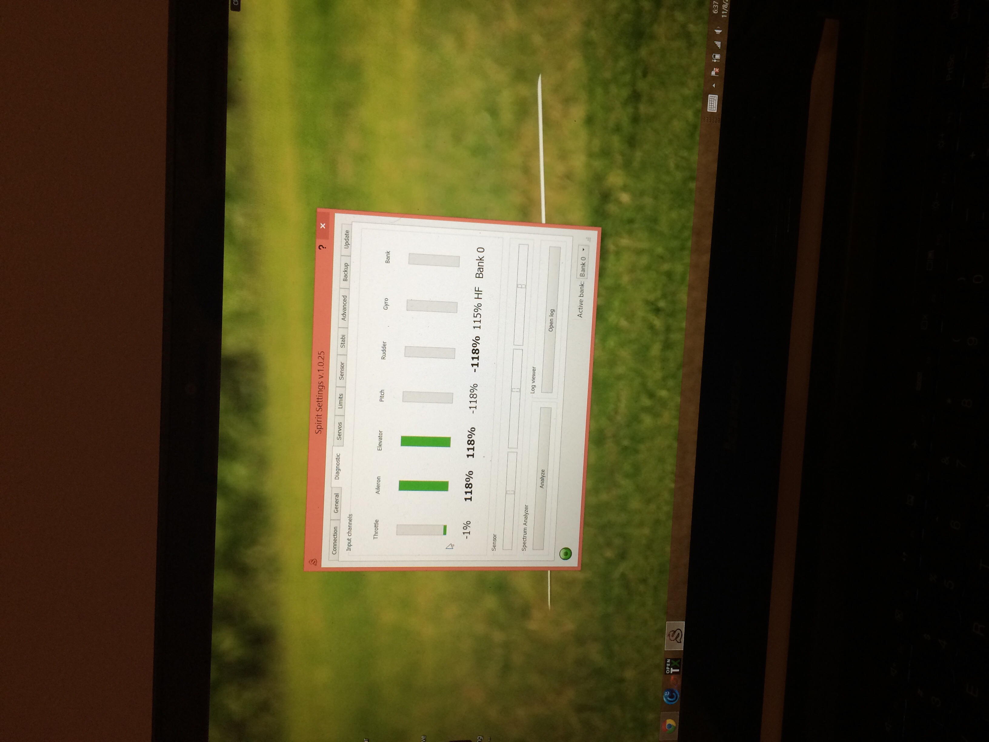

Jman841
Posts: 215
The pic in the last post is when I opened the log and it went crazy. The pic on this post is when I turned the Tx off
