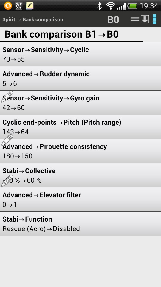

I ran into this situation when switching the Spirit from one heli to another.
I don`t know if the following is a bug or intended behaviour. To me it seems a little counter-intuitive though.

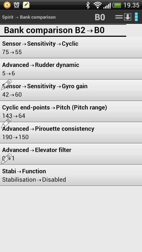

When one factory-resets the Spirit, only Bank-0 is reset, both Bank-1 and Bank-2 stays the same as before, even if one changes to Bank-1 or Bank-2, and try to reset from within either Banks.
To replicate situation: Save profile-settings to a file, initiate «factory-reset», disconnect and reconnect, choose connection-type, and re-assign Bank-switching to preferred channel.
Finally; compare Bank-settings.
Attached are photos comparing Banks after factory-reset.
Kind regards.

Thank you very much for the report.
You are right it is not correct behavior and will be fixed in the following version.
There will be more improvements regarding banks too.
