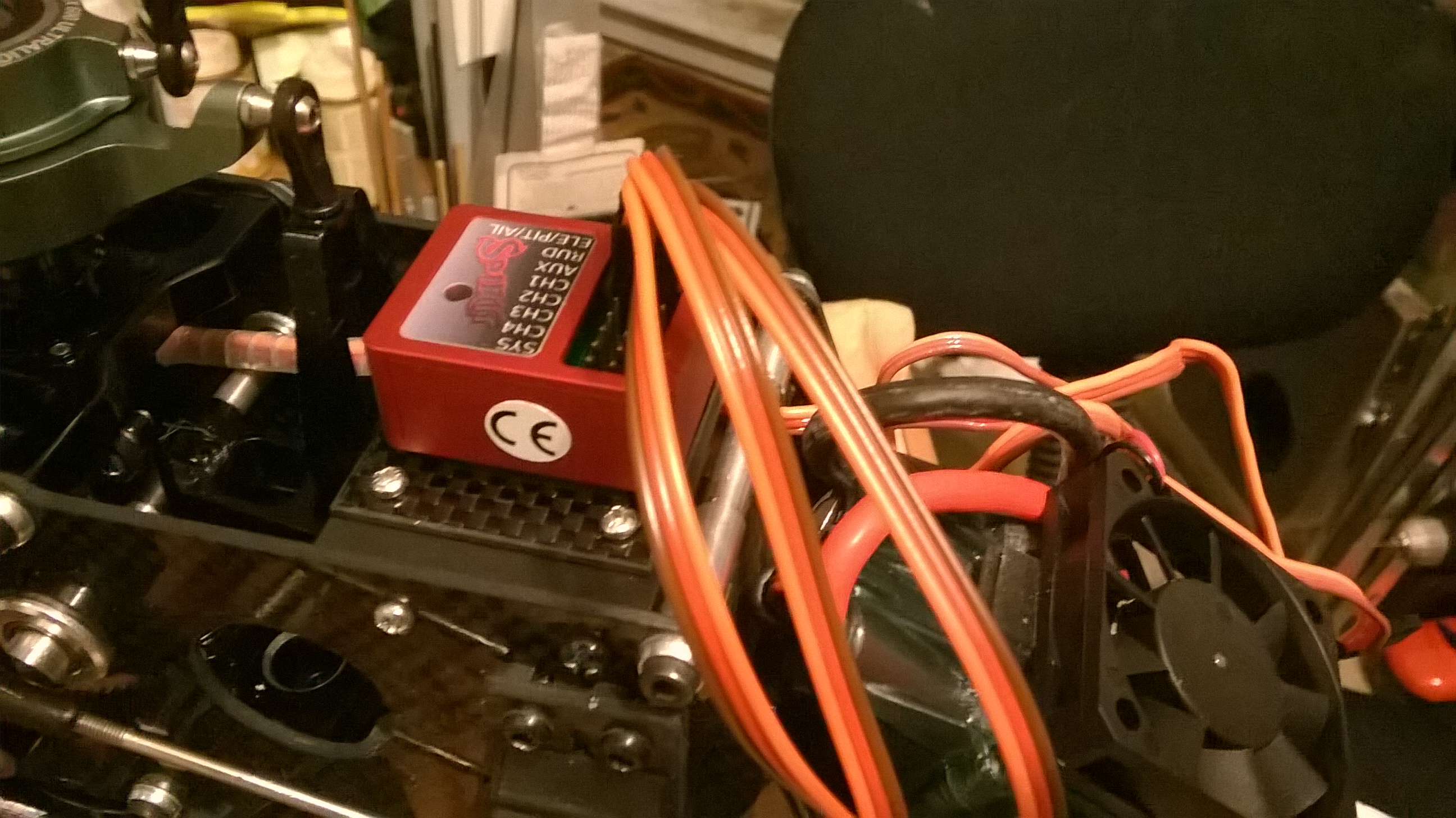

Thanks for the answers. That is what I thought but just wanted to be clear.
I have most of the initial setup done now but want to get the wiring tidied up next before getting it all done.
I have made up a small plate that sites right over the front two servos and is nice and solid between the frame plates. Should be good.
Pardon the messy, and incomplete, wiring.
-Barry

shadowraven213
Posts: 10
Joined: Sun 15. Mar 2015 23:11:17
I really wished the plugs could have been at the end having them on top creates these wire loops that makes this hard to mount in a few places
