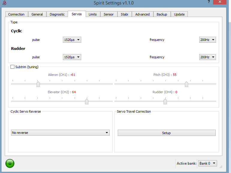

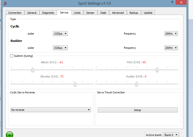

I have a swashplate leveler on main shaft. Using subtrim, level swashplate. Save settings and get the "settings saved" message. Turn off power to unit, wait a few seconds and power up. Unit starts up and the swashplate is no longer in same position as it was when adjusted using subtrim and saving settings. Not paying attention to blue or green, but just checked and yes, it turns green after save confirmation box.
I am attaching 3 screen capture files to illustrate what I am having issue with. Note the changing values of sliders.

miroker wrote:I have a swashplate leveler on main shaft. Using subtrim, level swashplate.
Hi, miroker to clarify:
Do you mean that all 3 pictures show the moment the swash is level? Yes/No?
And between each picture you restarted the FBL? Yes/No?
Did you restart the software beween each of the 3 pictures? Yes/No?
