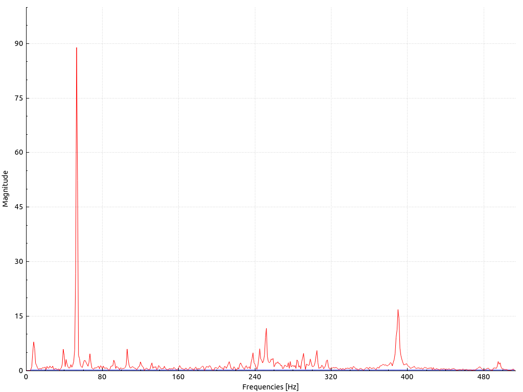

When everything was set up, I did a vibration analysis and it showed very high vibrations in the aileron axis. There was a peak of about 90% at approximately 2 x headspead and another peak at about tail rotor speed. The vibrations levels in the elevator and rudder axes were low. I also found that the flight log would not display either.

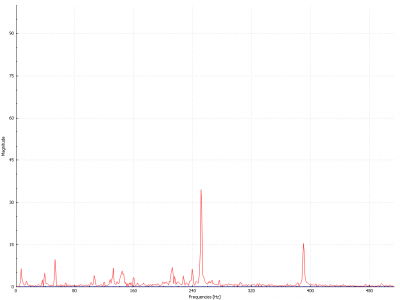

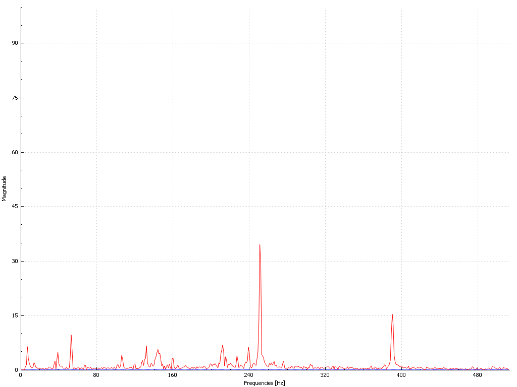

I have run the vibration analysis again in both linux and windows and have attached the y axis charts of both. There is a definite difference between the two.
Also as mentioned previously, I have not been able to open the flight log in linux.
y axis linux
y axis linux
y axis windows
y axis windows
Posts: 12988
Very interesting, thank you for the report.
Are you using driver from the installer? We will try to replicate the problem.
Most probably you can't open Flight Log because Documents directory does not exist in your home directory or there is no PDF reader associated with PDF files. By default it should work with Ubuntu when Documents directory is still there.
