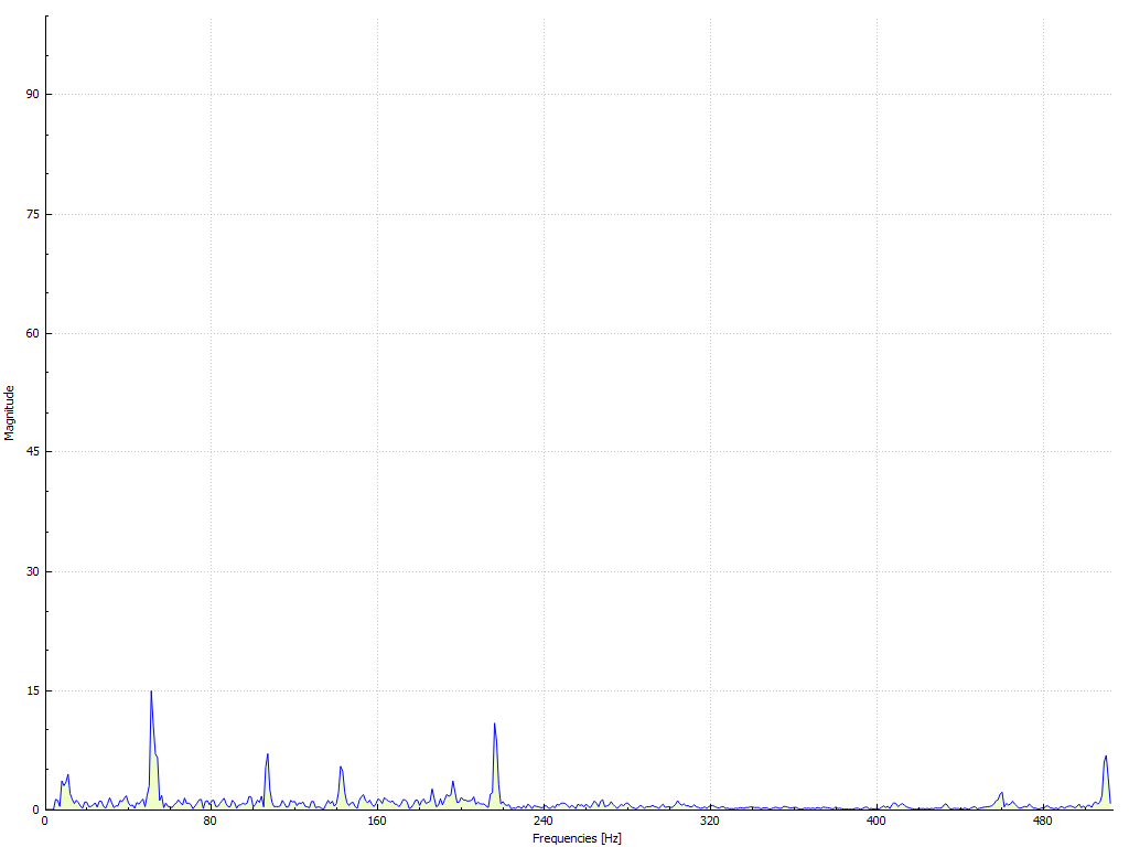

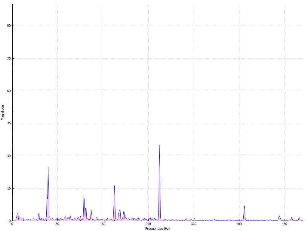

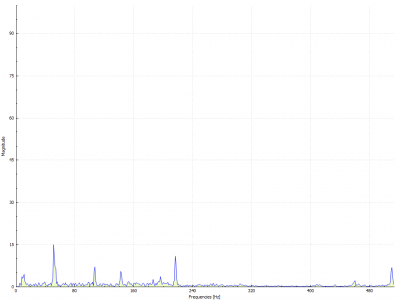

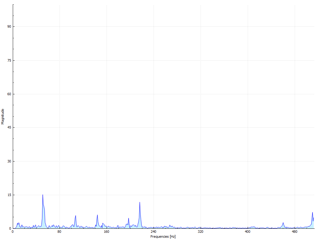

Here are the vibration plots:
3.000 rpm
3000 rpm X-Axis
3000 rpm X-Axis
3000 rpm Y-Axis
3000 rpm Y-Axis
3000 rpm Z-Axis
3000 rpm Z-Axis
best regards Wolfgang
regards Wolfgang
My Helis: Walkera 4G6 2S µBrain, Align T-Rex 250 FBL Microbeast, Oxy 3 Spirit Pro controlled by Jeti DS16
W.W.
Posts: 65
Joined: Mon 01. Feb 2016 13:37:12

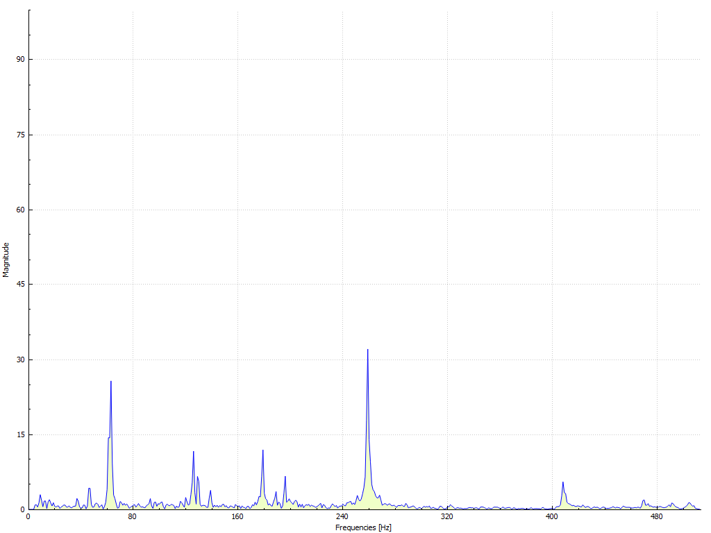

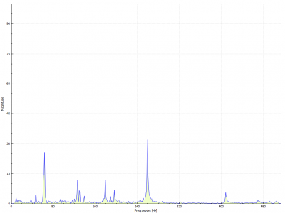

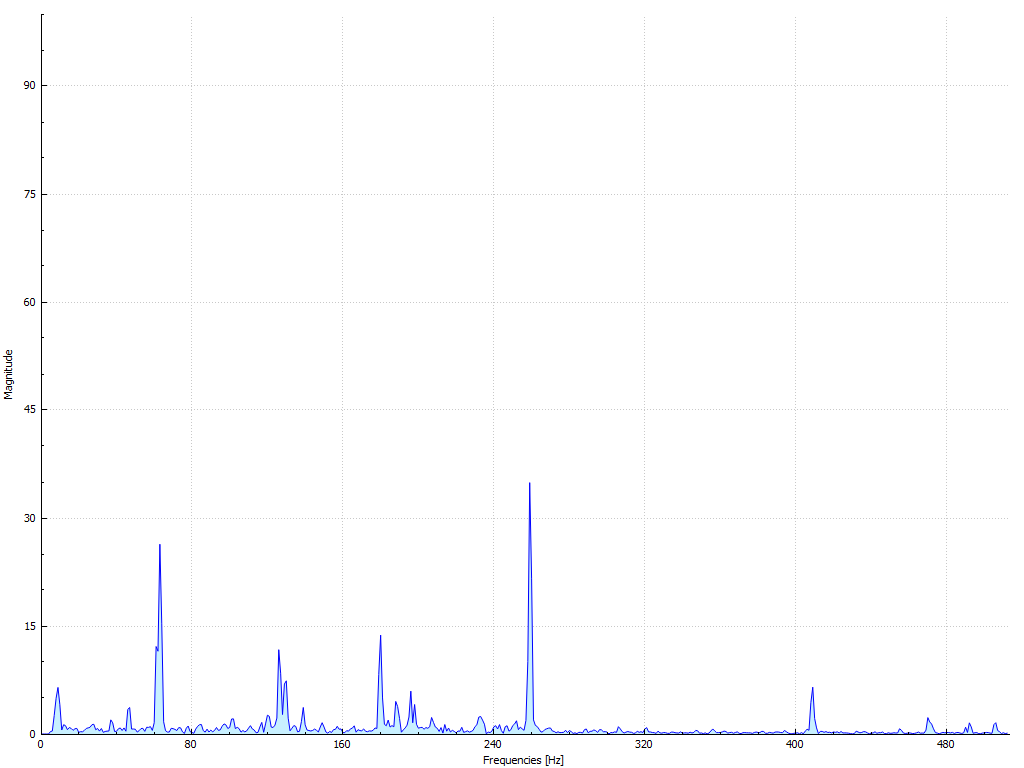

and 3.600 rpm
3600 rpm X-Axis
3600 rpm X-Axis
3600 rpm Y-Axis
3600 rpm Y-Axis
3600 rpm Z-Axis
3600 rpm Z-Axis
every plot without main blades and with tail blades
Checked the bearings => ok
Checked the main shaft => ok
Checked the spindle shaft => ok
Checked the swash plate => very little axial Play => changed by spare => ok
Lowering the belt tension => more vibes (se next posts)
regards Wolfgang

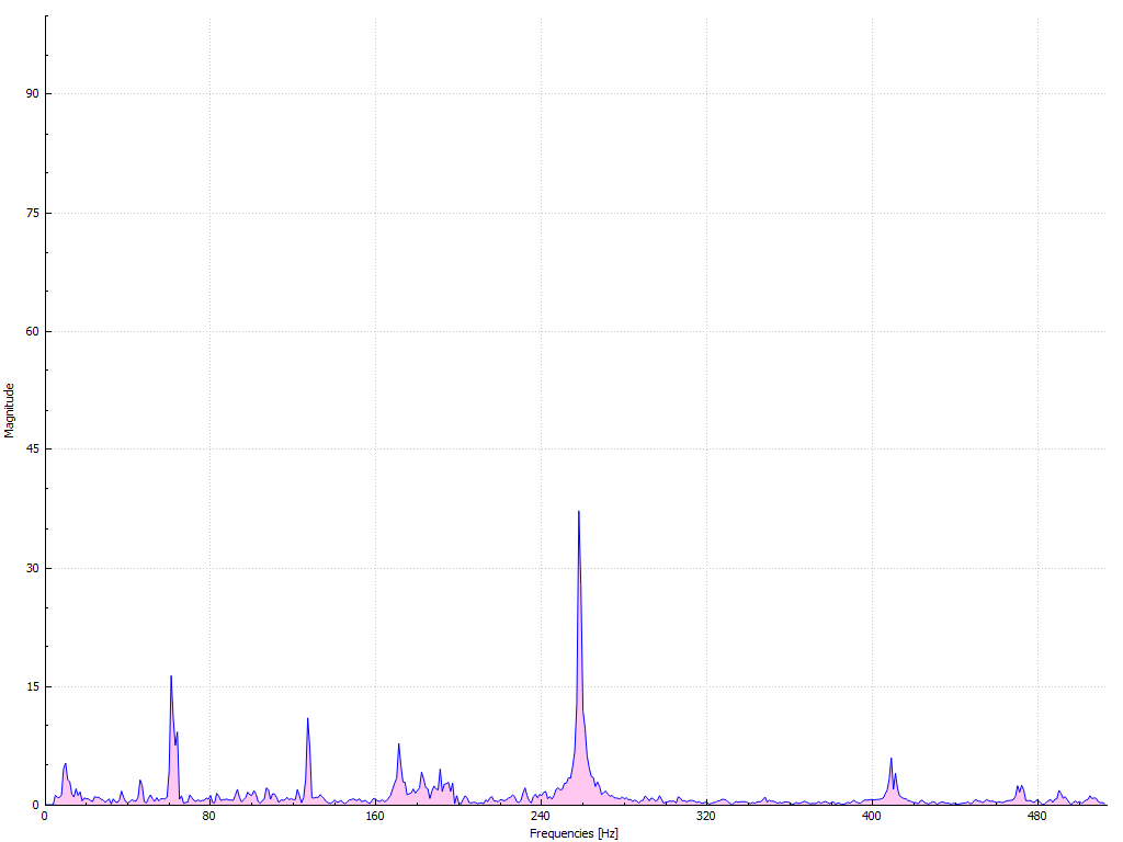

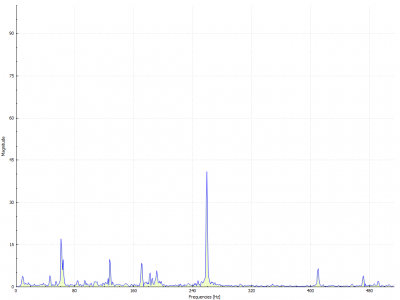

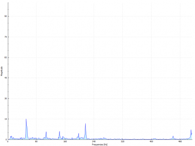

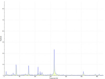

Here with lower belt Tension:
3600 rpm X-Axis lower belt tension
3600 rpm Y-Axis lower belt tension
2600 rpm Z-Axis lower belt tension
regards Wolfgang

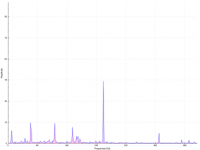

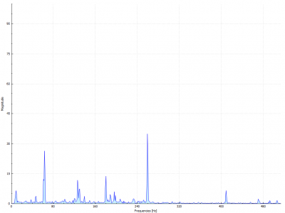

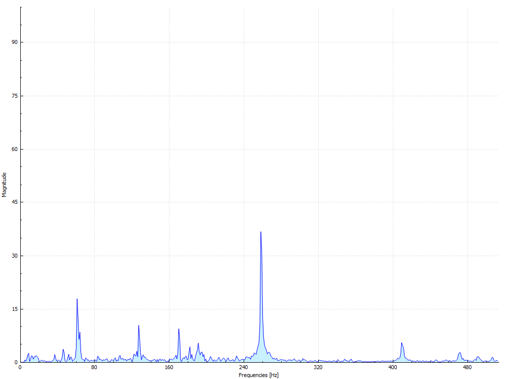

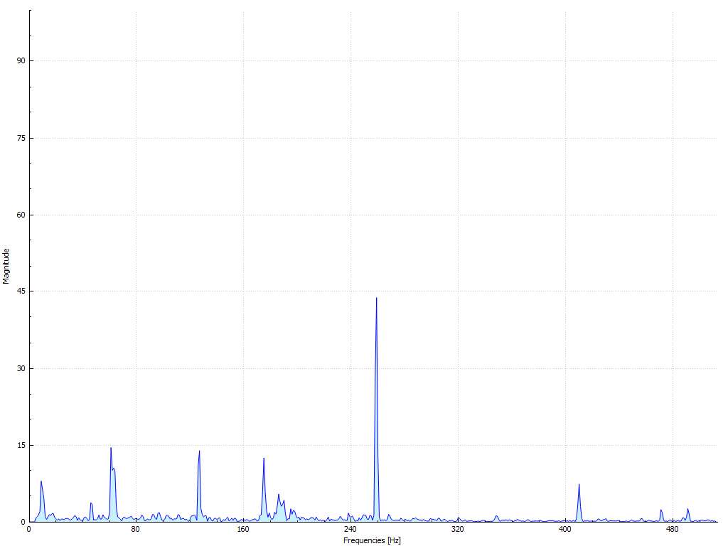

now with new swash plate
3600 rpm X-axis new swash plate
3600 rpm Y-axis new swash plate
3600 rpm Z-axis new swash plate
regards Wolfgang

Posts: 13045
Thank you very much for the plots.
The biggest spike is coming from the rudder.
Unfortunately when you mount rudder blades, the spike can be a few times bigger and make a huge troubles.
Without blades there shouldn't be nearly any spike.
Can you mount the tail blades and carefully spin the helicopter to check the analysis?
TomasN

Posts: 13045
Ah, sorry I have overlooked this.
In this case your plot is looking quite good. At the beginning I can see some low frequency vibration that is pointing that the unit is probably holding not too hard - but this can be caused if helicopter is moving little bit during measurement. If it is mounted with stock tape, then it is OK.
Maybe you can also post your settings so we can check that everything is OK there. But I believe that the problem is somewhere in the rotor head.
If you can observe oscillations on both aileron and elevator axes, then the helicopter is not probably OK. Something must be slightly bent or assymetric.
Maybe the blades are manufactured not too precisely? Normally more expensive blades should be in balance quite perfectly.
Or the last option is bad aileron/pitch servo that is oscillating - if you spoolup helicopter it shouldn't move at all.

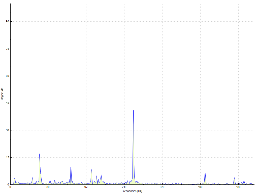

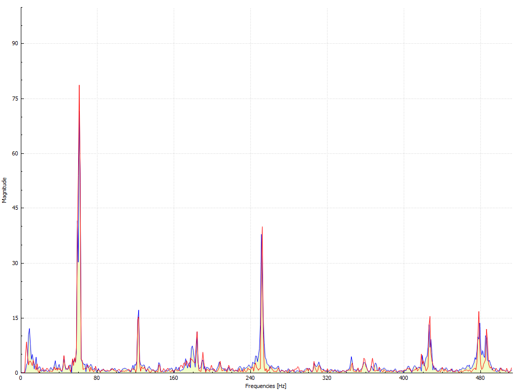

W.W.
Posts: 65

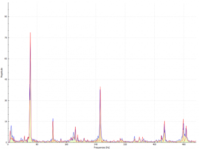

ZeXx86 wrote: ... At the beginning I can see some low frequency vibration that is pointing that the unit is probably holding not too hard - but this can be caused if helicopter is moving little bit during measurement. If it is mounted with stock tape, then it is OK.
As mentioned before the mounting is:
boom mount | stock tape | 3 mm forex sheet | stock tape | Spirit Pro
This is because the frame is a little to narrow for the Sprit Pro. But the wobble was an issue with the microbeast pro too. There was only the stock tape.
Bend parts in the main rotor are rather unlikely, because everything is already changed:
  • main hub
  • dampeners
  • spindle shaft
  • blade holders (including bearings)
  • blades
  • main shaft
  • upper bearing block with bearing

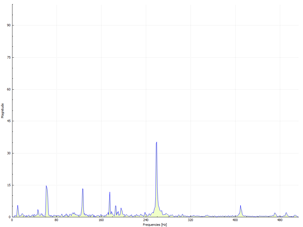

The upper bearing was bad, here Is a plot of the vibrations:
One can see the significantly higher peak at the main rotor head Speed (60Hz = 3600 rpm).
regards Wolfgang
