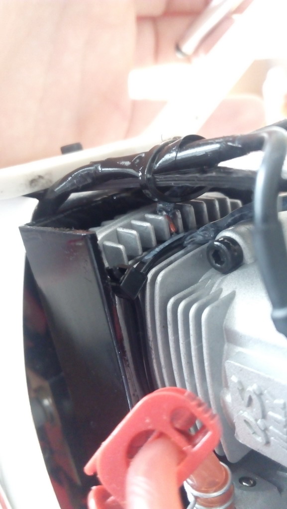

Regarding the temperature – I placed the sensor out of main air flow stream, but as front as possible.
General rule is that the engine should have around 90 – 95C after landing – it means that about 100 – 110C during fly. But I do not tune it for temperature – I used power test like I use for gassers.
I use high output fan, it is quite cold, therefore the temperature do not have to be the primary parameter.

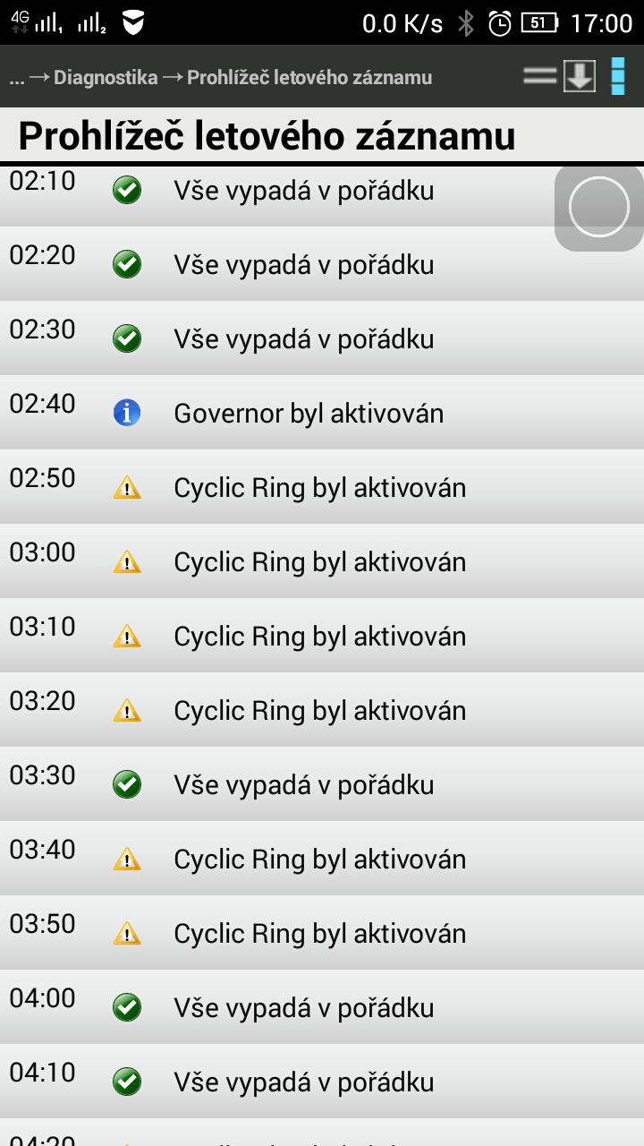

Anytime when governor is really On, you should see the event - Governor was engaged in any transition from disabled state (TC is under 50% or disabled in a bank).
If you will not see this, governor was not prepared yet for some reason.

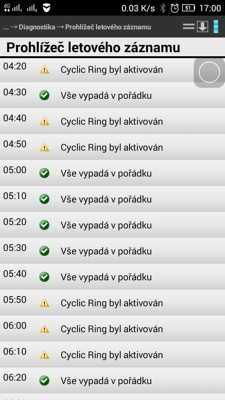

I made some PRT SCS after one of the test from fly – see attached. There is mentioned that governor was activated and no other information about noise from sensor etc.…

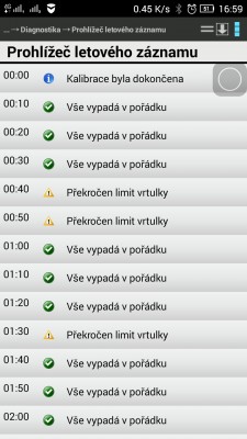

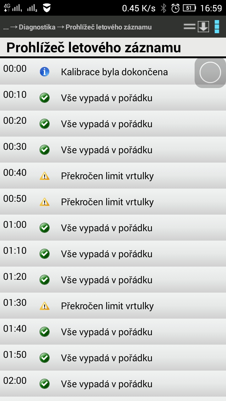

After each fly, when I changed the parameters, I checked the logs and I found information like Governor enabled (see my example of screen shots).
There was no information about noise, vibration, low voltage etc...
