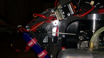

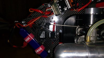

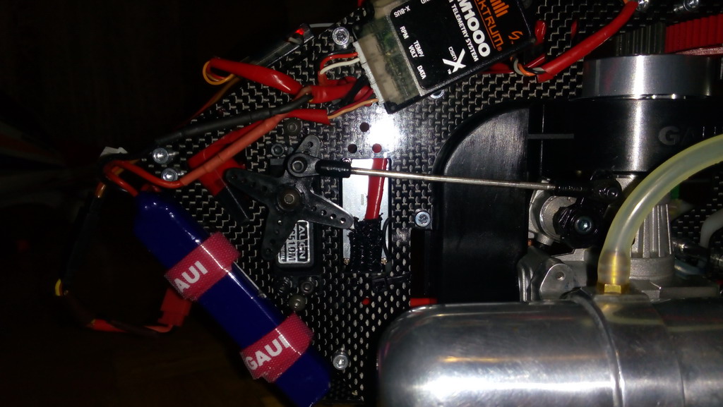

I tried to ply with needles, with throttle linkage, but nothing helped… Throttle servo is Align DS510.
Throttle curve in my radio, which works is: 100-55-45-55-100.
Throttle position for idle is 17% in Spirit diagnostic, then the % corresponds with radio value...

Also make sure that the Max. throttle servo range is not too high.

The servo travel is OK – I double checked it (0% = carb if fully closed, about 17% motor idles and 100% - the carb is fully opened).

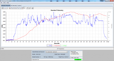

Next, I made longer video with settings 7 and 1. I take a PRTSC from telemetry record. I started recording video and telemetry record at the same time - it means that the timeframe should corresponds (+- 1 second):
Something strange happened at about 100 seconds - seems like governor was turned off and were used a curve from transmitter (=about 87%). Then, I turned off the governor and then turned it on, and it worked (not well, but worked).
I have to mention that I use one sensor for Spektrum telemetry and Spirit system. Sensor is powered from TM1000 telemetry and signal wire is connected to both devices - telemetry and Spirit. In the log was no error (I made PRTSCS of whole log - there is only once mentioned, that the GOV was turned on)
Telemetry record
Telemetry record

Hi, I hope the experts will chime in and resolve this for you. That doesn't look good at all. I would expect better holding power from a v-curve, or even a moderately effective governor, than what you are seeing. i have no experience with this size nitro or model though, so some general thoughts.
From my limited experience with nitro, you're engine tune needs to be good for any governor to work. Too lean and it will overspeed. Too rich and it will bog / sluggish - gov will over-compensate and not hold at all.
I use the Align sensor, split between the FBL ( not Spirit in this case, sorry) and TM1000 on two helis, like you, with no issues. You could investigate the sensor noise settings and see if this has an effect.
Because of the overcast conditions in the vid, it is not possible to see the smoke trail. How much pitch are you using ? You might be asking too much from the motor as it bogs a lot ? I had to quickly learn that you cannot bully a nitro like and E, and certainly not something this size.
The temperature is very dependent on where you measure it. Is what you are seeing in line with other guys ? (Perhaps worth searching on the forums at Helifreak or Runryder)
