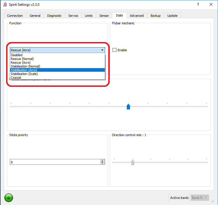

Stabilization (Acro) seems I want to try.
Helpful with inverted circuits I'm practicing.
Can I use Rescue (Normal/Acro) in combination with Stabilization (Acro)?
Is it correct to say Stabilization (Acro) will not fight you in any way unless you let go of the cyclic stick?
Posts: 13045
Yes, you are right. It will work exactly in this way.
Yes, you can use Stabilisation and Rescue together. With Bank Switching it can be programmed in this way.
scrambled
Posts: 85
Joined: Sat 11. Apr 2015 18:07:33
Because it's a pull down menu I now see you can't combine rescue. :oops:
Of course one can use banks, select for example Stabilization (Acro) in Bank 0 and select Rescue (Normal) in Bank 1.
Flying around in Bank 0 rescue is not available, it requires to switch to Bank 1 first and then hit the rescue switch.
Switching twice takes too much time for me, I'm sure I hit the ground in the process. :shock:
However for training purpose I'm always three mistakes high. :mrgreen:
I'll give Stabilization (Acro) a try, just to see what is does and if I like it. :)
Stabi tab.
Stabi tab.
Posts: 13045
You can still set priorities in your transmitter or set the behavior so that Rescue can be active always when some switch is engaged.
If you want to use only one channel for everything, you can unassign Gyro Gain and set a static values. Then only by changing Banks you can activate Rescue/Stabilisation/normal flight.

I have a similar arrangement, but I added a couple of mixes so that, when I hit the "PANIC" momentary switch, it immediately forces Bank 1 (Rescue bank) AND Stabi to ON (or, negative gain; depending upon which method you are using.)
The mix frees me from having to throw the Bank switch, first, then hit the rescue switch.

I have tried:
Bank 0 - disabled
Bank 1 - Stabi Acro
Bank 2 - Rescue Acro.
It is possible to invoke Bank2 (RESCUE) ever with any bank selected: need some mix in the TX and a spring switch ( - SH - with Futaba T14SG -)
Tomas is right: with Stabi Acro the Heli return to self level centering cyclic stick, with stabi normal not! Only one LIPO to day. Others test tomorrow .
